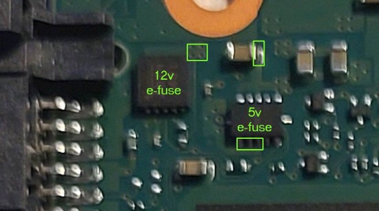

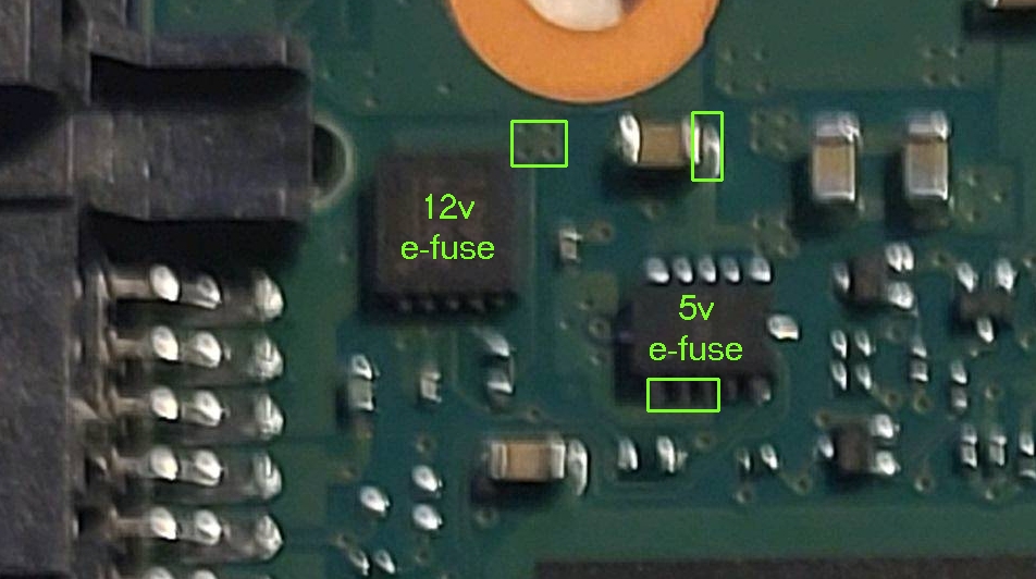

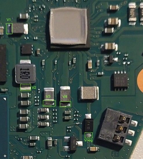

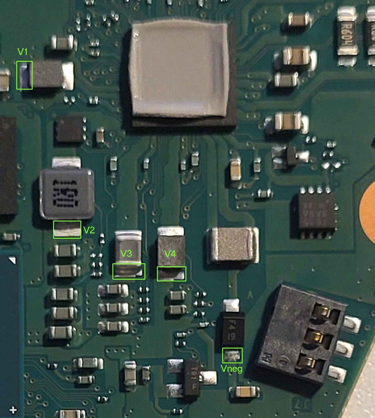

Put your ear against the drive. Do you hear any faint sounds, eg ticking, buzzing, beeping?
Measure the voltages in the attachments. Use any screw hole as your ground reference. I can't make out the part markings on the e-fuses, otherwise I would have provided more precise test points.
Pay particular attention to Vneg. It may briefly rise to -5V or -3V immediately after power-on, and then drop to 0V within a second or two.

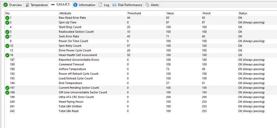

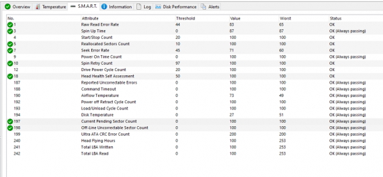

And after power on, the HDD was working normally. I rebooted the PC, like 5 times, it worked fine.
I did multiple quick tests with SeaTools and it said "failed" for some and "passed" for others, without any explanation.
But this latest version of SeaTools looks very sketchy, seems like it was written by a scholar, with UI layout bugs and no explanations.
HD Sentinel showed nothing to worry, everything 100% healthy, not a single SMART sign to indicate issue, at least to my knowledge.
