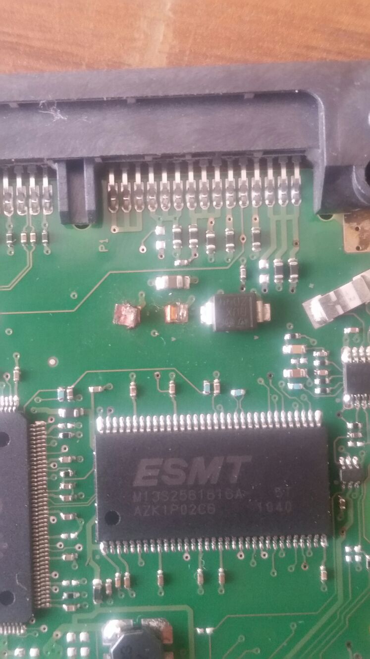

If there is no other damage, a DIY fix will cost you nothing. Can we see a detailed photo of your PCB?
Hello again!
Here is he the picture of my PCB. Two components in a black circle were burn. I am sorry for bad quality of picture. I cannot do a new one, because I will pick up my drive only on Monday.
Thank for you help!
Narodon
P.S. it is not the original PCB. It is other one with firmware cc37.
 Post subject: Re: Seagate ST31000528AS Repair (Bunt PCB)
PostPosted: December 4th, 2010, 18:42
Posts: 17316
Narodo, the two components are inductors. Clean up the area with a toothbrush and isopropyl alcohol (tape head cleaner). Then replace the inductors with wire links, or solder blobs if you are careful. Remove the 12V TVS diode located at 7 o'clock to the inductors. You can cut it out with flush cutters.
If there is no other damage, then the drive should work without the diode, but you will no longer have overvoltage protection on the +12V supply, so be absolutely certain your power supply is good. For continued protection you can replace the diode with an SMBJ12A from Farnell, Mouser, Digikey.
Thanks a lot! I will try it this week.
Narodon
PostPosted: December 8th, 2010, 15:50
Joined: December 3rd, 2010, 17:04
Location: Germany
Hello again!
For all who burned components of hard drive like me. I followed advices from fzabkar and changed two inductors and an equivalent diode. It worked and I could recover all my data form drive.

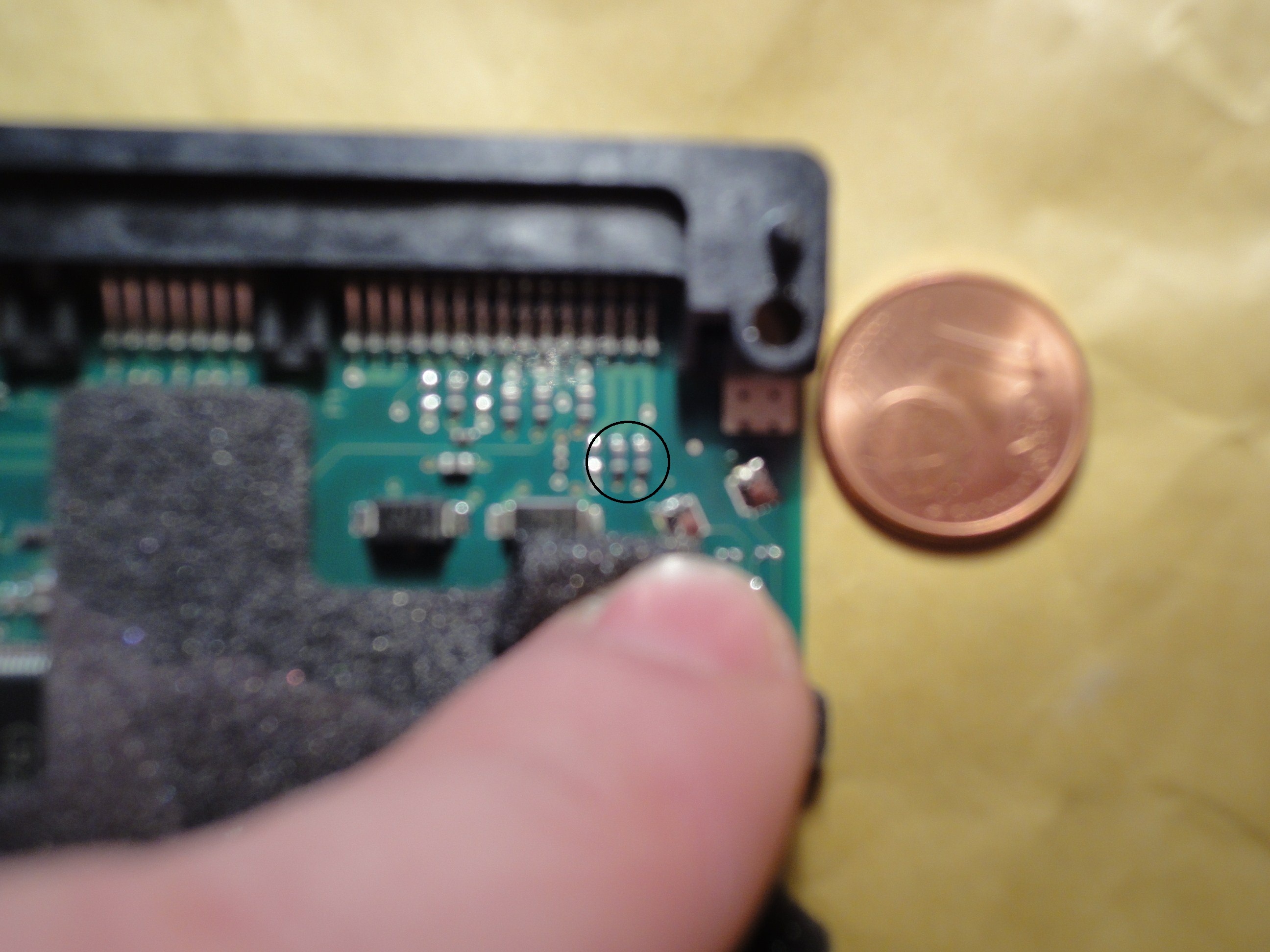

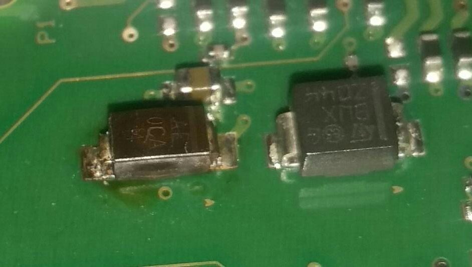

just wanted to confirm, does this look like the diode which was spoken about above?
I just clip the charred remains off?
thanks for your time,
greg
PostPosted: December 23rd, 2010, 19:48
Posts: 17316
The part marked "LEK" is the 12V TVS diode. The burnt components are inductors. Remove the diode, and replace the inductors with wire links.

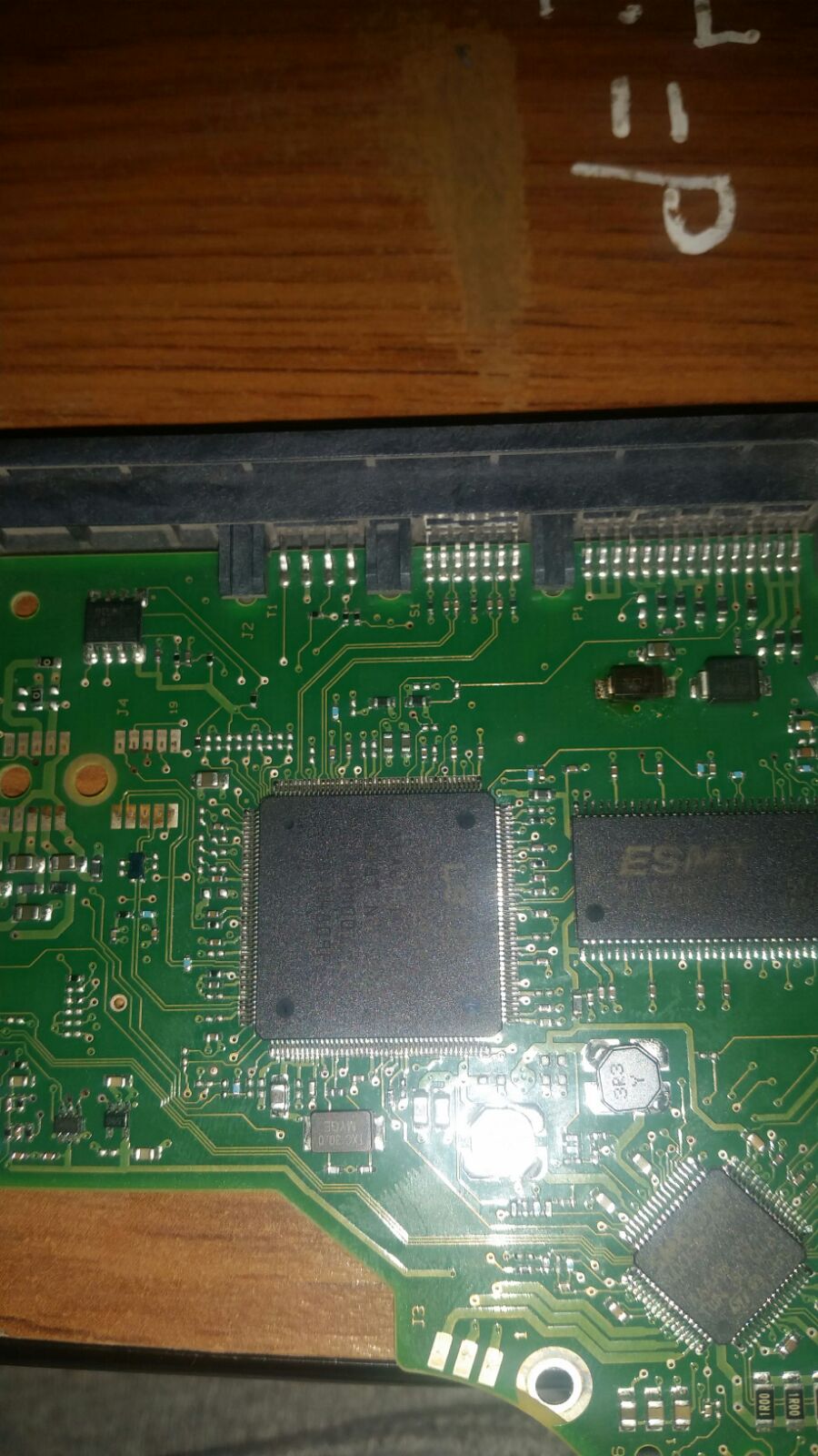

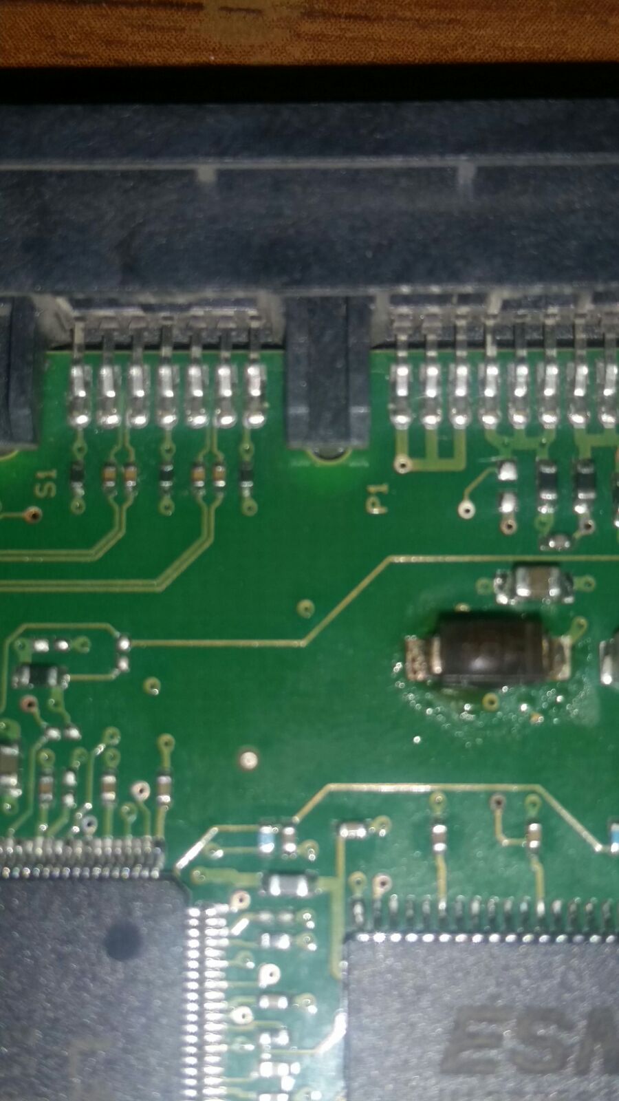

hi there, same situation here the difference is that my 5v TVS is burnt, What should I do????
Please help me, I had my entire life in that HDD.

Posts: 17316
PostPosted: May 10th, 2016, 17:20
Joined: May 10th, 2016, 0:33
Location: perth
Thanks a lot, so I was a quite nervous about taking off the TVS diode as described at number 9 in the FAQ, however the process is a few rustic finally works successfully.
I just took off the damage TVS 5v Diode, and my HDD is working as a normal but without being protected.
I extremely recommend the HDD-TVS Diode FAQ. cheers fzabkar...
