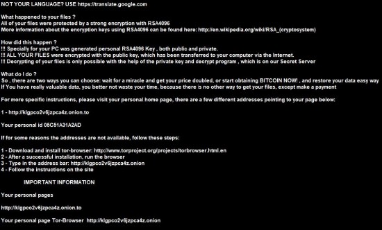

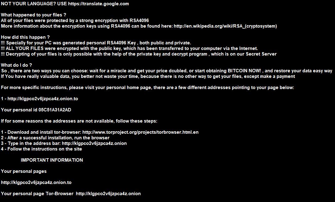

Hello friends
I have a document encrypted virus .crypt help me
I did try many ways but not decipher
thank you

That's because you don't have the CoinVault or Bitcryptor ransomware.
Try this instead:
http://www.bleepingcomputer.com/news/security/gomasom-crypt-ransomware-decrypted/
make sure you are WORKING ON A COPY of the data, and always keep a good original copy safe. If you have had trouble simply identifying it, then maybe consider giving this job to someone that has the experience to give it the required diligence.
You could have TeslaCrypt 4.0, and if so... ouch, sorry :-(

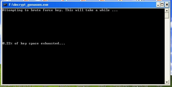

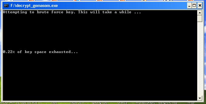

I use this screen notice how you
help me

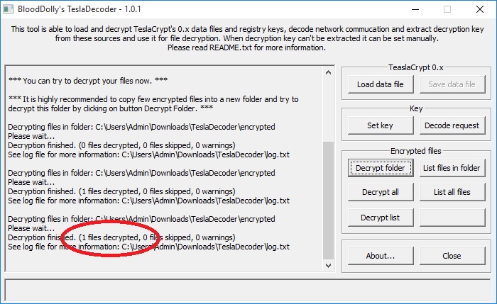

datahdd116 wrote:
Spildit wrote:
Please read here :
http://www.hddoracle.com/viewtopic.php?f=150&t=1583
And try the attached tool.
I've used this tool but can not decipher

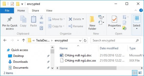

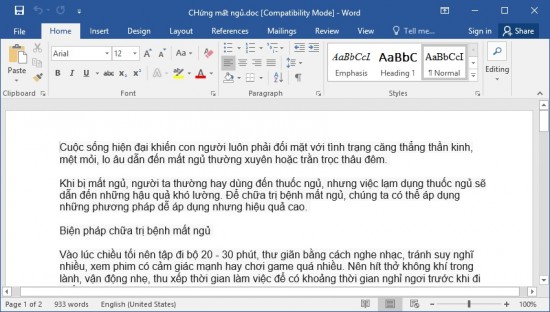

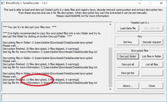

yes it can.

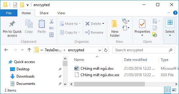

steps to reproduce:
1. Extract tool to c:\TeslaDecoder
2. Make folder "encrypted" in that folder and put encrypted files in there (c:\TeslaDecoder\encrypted\)
3. add the file extension ".xxx" to all files.
4. run TeslaDecoder.exe.
5. Click "Set Key" and choose ".xxx, .ttt, .micro, .mp3" and click "set key"
6. Click "Decrypt Folder" and choose your c:\TeslaDecoder\encrypted\" folder, then say "no" to deleting your original files.
7. Do the happy dance!
You owe me AU$400! :-)~

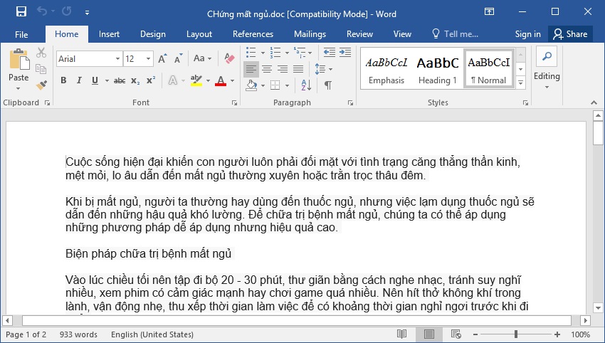

before I am using the old version not get the key.
I downloaded the new update 18/5 fine.
thanks
I invite you to whisky :D :D
