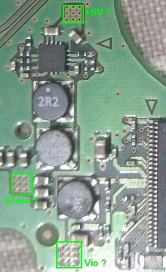

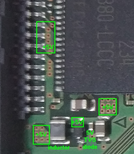

Measure the Vcore, Vio, and 5V test points in the attachments. Use a screw hole as your ground reference.

As fzabkar said, you can check voltages in the showed points.
Step by step:
problem with +5 V -> inductor and/or suppressor (diode)
problem with V core / IO Voltage -> MOSFET DC/DC converter (or surround elements)
if voltages are OK -> motor driver IC (or surround elements)
With less probability, it can be problem with MPU, but it's rare enough. BTW, do you have any activity in terminal? Log?
As it said above opening the drive was a bad idea, so close carefully and do not touch ;)
Fastest way to solve problem - check preamp voltage pins for short circuit, move ROM IC to the good PCB and proceed working with drive with new PCB (with original ROM). Good luck.

if Vcore : 1 V, and Vio : 2.3 V, other 5Vs seems ok.
