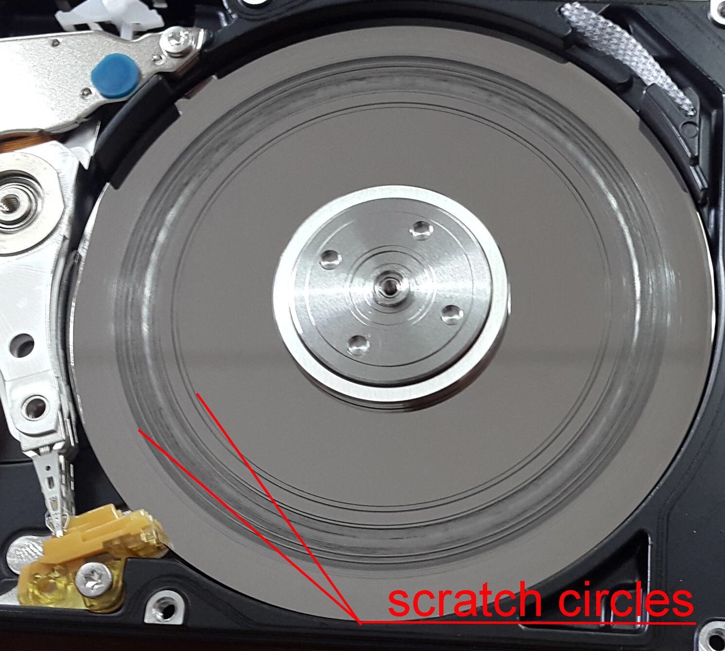

Is it possible to recover data in this state?

Of course. Get the data from the filter.

Beyond data recovery.
How long this drive was scanned with HDD Regenerator?

What about the other sides?

Who took the picture you posted? Is the drive with a DR company now, and they gave you this picture, and at the same time they said they will order spare parts for this and recover your data?
Is this correct?

If this a actual photo of your drive ?
I would not advise to spend any parts on that one :(

If that is actually your drive, don't waste any money on it. Even if the other platters aren't as bad, you're not going to get back any significant amount of data worth paying for.
I could be mistaken, but I believe that Kroll's policy is they only charge if data is recovered. However, it doesn't matter how little or much they recover. If they manage to save one useless Windows system file, they expect you to still pay the full amount. Gotta read the fine print my friend.

We recently had a case where we had a 2.5" hitachi drive where we were able to read about 98% of the drive. Sadly, the 4GB of data that they wanted was stored within the first 5% of the drive and after we finally conceded that we were not going to get any more, even though the drive still was quickly coming ready, we gave up. When we opened the cover, the top platter surface was completely gone. We were very fortunate to get 98% of the drive imaged, however, we were only able to get about 30% of the target data.
So, I can see how the first company might have been able to get a clone, but not a full recovery...and subsequent companies will be lucky to get a 75% clone, if they even bother to try.
