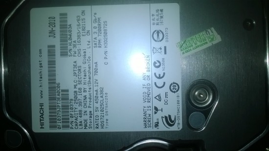

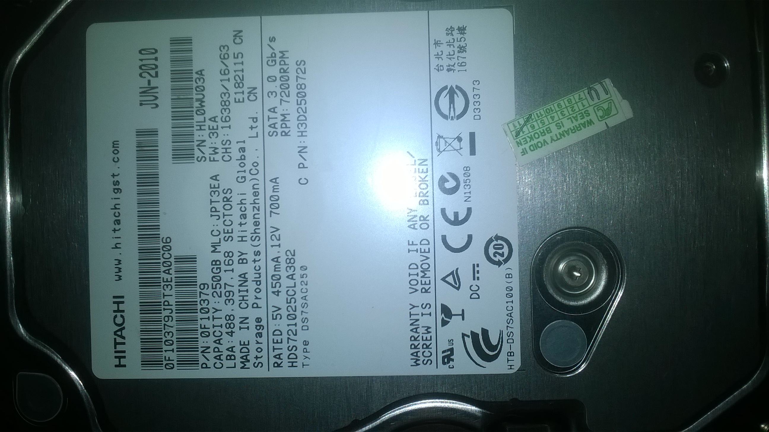

Hi, i'm newbie here
May i have some advise for my HDD problem ? it's Hitachi GST 250Gb, for serial and model, i will inform later when i'm going back home.
I'm running on Asus P5K Mobo, with windows 10 installed, the drive was connected directly to SATA via 5.25 docking bay (HDD Dock on Cooler Master Elite 431). The current problem are the HDD are suddenly disconnected with unplugged device sound on windows, after reinserting to it's docking, the HDD was able to recognized.
Even without dock, it was a same result, can anyone help ? or any component on PCB should have a test ?
I already check the SATA port/connector, there are no issue with other HDD. i already clean the HDA and motor pin pads also.
Thank You

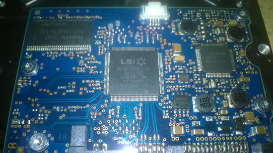

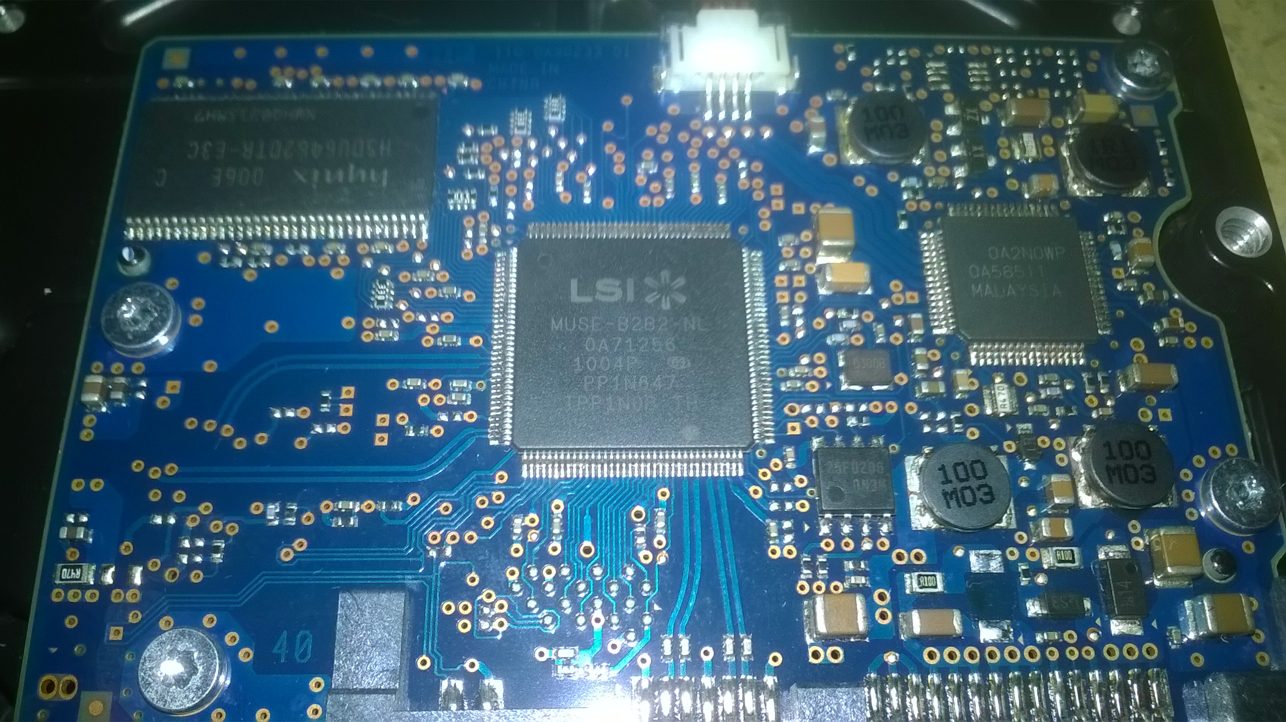

I have basic knowledge and instruments on electronic, can anyone help me where should i start to check the power line components on mainboard/PCB ? or can send me the common HDD schematics ?

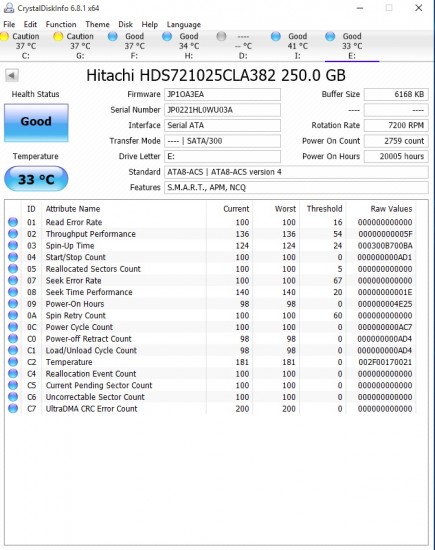

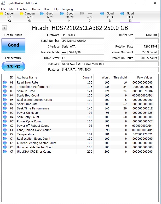

SMART could be checked with MHDD, hddscan, hddtune, crystaldiskinfo.
Based on my experience with Hitachi drives and the info provided so far by you, the drive should not have a PCB problem. Rather a bad sector or read-write component failure. Overall, I would lean toward a SATA cable connection, maybe a power supply issue as well.
Start with SMART tests and go from there.

Hi All,
this is what i'v got from crystaldisk

Hey, it looks like the drive are missing one of the TVS diode, does it impacting to the board power distribution ? can anyone tell me the equivalent for the replacement ?

I already replace the missing TVS diode (googling and found the same code from another bad drive), problem still the same.
If the problem are on inner parts of the drive, so it's time to say "Done" for the drive.

I had replacing four tiny capacitors on Tx - Rx SATA circuit, it's seems the problem has disappering, and i got more write/read speed also, from about 15 Mb/s to be 90+ Mb/s.
I'm now reformatting the drive, and re-copy as much as files into the drive.
Hope this is the permanent solution, and caused by weak caps.

A missing TVS diode would have made no difference to the drive's performance.
If those Tx/Rx capacitors were problematic, I can't understand why there were no UDMA CRC Error Counts in your SMART report. In fact there is no hint of any problem in the SMART data.
FWIW, ISTR that at least some Hitachi models had problems with NCQ. Perhaps you could try disabling this feature.
