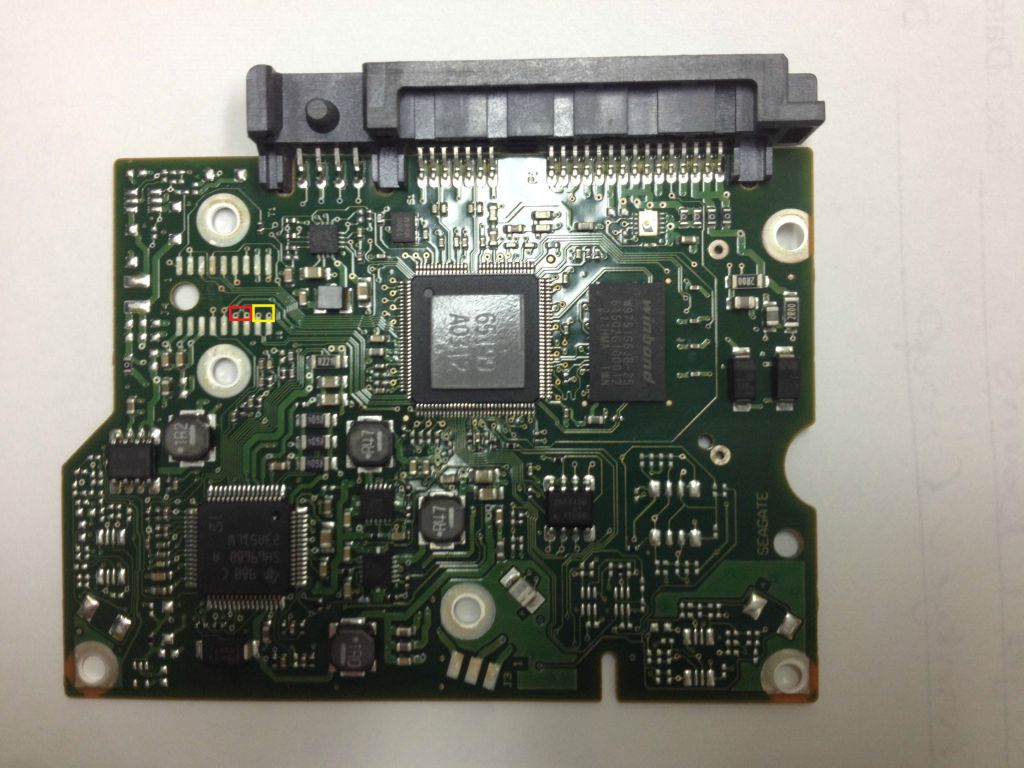

Hi everyone, Glad to finally be a part of this great forum.
I'm having a problem with a ST1000DM003
"Boot 0x40M
Spin Up
RECOV Servo Op=0100 Resp=0005[LBA=0x000042F9]N01010C10o0o0o0o0o0o0o0o0[LBA=0x000042F9]NO1111
RECOV Servo Op=0155 Resp=0005[LBA=0x00066E3B]N01020C10o0o0o0o0o0o0o0o0[LBA=0x00066E3B]NO1111
RECOV Servo Op=0055 Resp=0005[LBA=0x00028F1D]N02020C20o0o0o0o0o0o0o0o0[LBA=0x00028F1D]NO1111
RECOV Servo Op=0155 Resp=0005[LBA=0x0008BA5F]N03030C20o0o0o0o0o0o0o0o0[LBA=0x0008BA5F]NO1111
SimError - Remaining in BootFW
Perform a double download without a power cycle"
help me

That's normally an indication of read-write head failure.

 Post subject: Re: ST1000DM003 Sim Error-Remaining in BootFW
PostPosted: April 24th, 2016, 3:10
Posts: 242
you need short pcb

galaxy wrote:
you need short pcb
Next I choose green and red you help me
thank you

I plugged into the computer then get 137GB bios error smart F1

galaxy wrote:
you need short pcb
I did try to but still do not have the results . I would like ask head replacing Is this the best way
