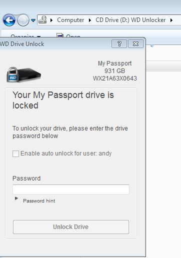

Hi all
An express 'thank you' to anyone who can confirm whether or not this might be possible.
I am an IT tech and I have a customer's WD My Passport 1TB drive which he's locked with the drive lock software & forgotten the password.
The situation is all legit as he has provided us with a drive receipt and he's essentially wanting the pictures of his former dog recovered.
In prep for trying to bypass the security we've set a password on a different drive (one of our techs), used MHDD and successfully recovered the password from the .22 bin file.
The test drive that worked had a SATA interface but the customer drive has a USB3 connector soldered onto the PCB.
It's now my understanding that MHDD is unable to assist unless we're dealing with an ATA drive and I've a hunch that a USB3 to SATA convertor cable won't help our situation either.
It's a shot in the dark but has anyone worked with the newer USB3 connected drives and would you know if bypassing the WD Unlock is possible with this setup.

When people say they have a password set on WD USB drive they usually refer to WD SmartWare password, which in most cases(so far) is not an ATA password.
Moreover those drive are encrypted with AES and user password would lock the drive, preventing it from being decrypted
Generally speaking (with some exceptions) bypassing WD SmartWare password does not exist because it's involved in encryption process.
Sometimes when smartware SW asks for a user password this doesn't mean it been set .
Ask your customer about is he sure he used user locking option or not. In a case when he didn't use it , there is a chance to restore data .

The customer definitely did create a password (We've beengiven a list of possible's) and I'm assuming it's the WD Smartware software that generates to WD Unlock window which is requesting the password. (See attached).
I can obviously push the drive to request a re-format but would welcome a method of being able to access the data and rcover the required photos.
Maybe it's just not possible, in that case "Well done WD for a secure method of protecting your data" :)

Then either the customer have to remind it, or in alternative pay a lot of money to have drive data recovered OR live without data/wait for better times leaving the drive "as is" (data is still there albeit encrypted).
I can't tell you more or anything different, sorry.
