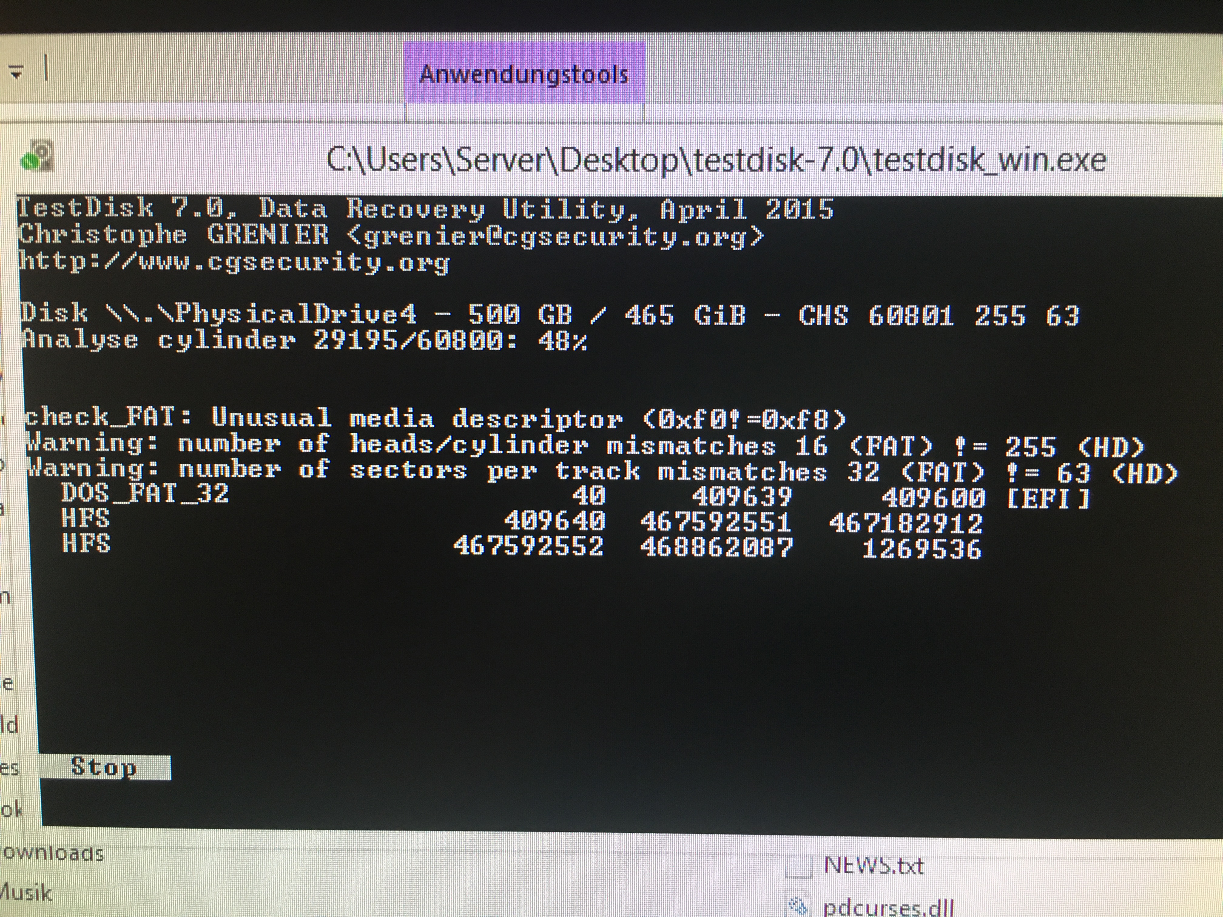

Hello guys,
already cloned the drive.. wondering why there is a FAT32 partition at the beginning of the drive. Might this be the cause why the HD is not recognized? R-Studio does not have any problems extracting files...
Maybe someone mounted it to a windows pc? Does this write a partition?
some non technical side story: She wanted the MAC to be repaired by a store (the owner owes me 2000 € - weird guys - funny she didn't knew that at that time) they damaged the MAC and said there was a problem with the drive not readable.. but before the MAC worked fine beside the touchpad problem.... really weird story... - after that she was at a PC repair shop maybe the mounted it and the partition was written to the drive
I hope I can use the MAC migration tool to transfer the settings e.g. to the new MAC of a friend of mine. Once the partition is fixed it is worth a try to use the MAC migration tool?
diskutil list with terminal doesn't list the attached usb drive... strange..
Greetings
Benjamin

This is the result of the command.. maybe the error has something to do with the FAT32 partition written to the beginning of the drive?
diskutil verifyvolume disk2s2
Started file system verification on disk2s2 Macintosch SSD
Verifying file system
File system check exit code is 8
Error: -69845: File system verify or repair failed
Underlying error: 8: POSIX reports: Exec format error
Benjamins-MBP:volumes Benjamin$ diskutil repairvolume disk2s2
Started file system repair on disk2s2 Macintosch SSD
Repairing file system
Updating boot support partitions for the volume as required

The FAT32 Partiton - it was not a fault..
Wikipedia
On Apple–Intel architecture Macintosh computers, the EFI partition is initially blank and not used for booting.[11] However, the EFI partition is used as a staging area for firmware updates;[12] specifically, it places a firmware flash utility (EFI binary) and data file (FD – "Firmware Device"[13]) in the directory EFI/APPLE/FIRMWARE which is then run when rebooting the system in "flash firmware" mode.[
In the end there is still a question:
How make the the partition mountable?
