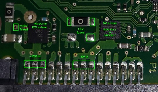

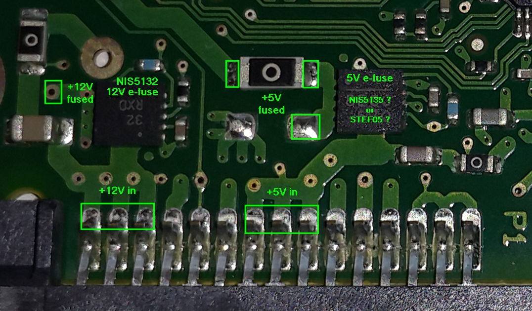

Hi Folks,
I have a a Seagate ST4000DX000 with faulty PCB - looks like a classic TVS problem.
But i never seen this PCB, and can't find the TVS's on this one.
Please see PCB on the links below:
https://dl.dropboxusercontent.com/u/49559271/PCB-3.jpg
https://dl.dropboxusercontent.com/u/49559271/PCB-1.jpg
https://dl.dropboxusercontent.com/u/49559271/PCB-2.jpg
Any help with finding the TV's on this one would be great.
 Post subject: Re: ST4000DX000 with faulty PCB -tv's?
PostPosted: May 17th, 2016, 4:24
Posts: 17333
The devices near the SATA power connector appear to be electronic fuses.
I would test the output side of each fuse. If the corresponding voltage is not present, then test for a short circuit between the output and ground.
NIS5132, 3.6A 12V Resettable Electronic Fuse, marking 32:
http://www.diodes.com/datasheets/NIS5132.pdf
http://www.onsemi.com/pub_link/Collateral/NIS5232-D.PDF
NIS5135, 3.6A 5V Resettable Electronic Fuse, marking 35:
https://www.onsemi.com/pub/Collateral/NIS5135-D.PDF
NIS5135 appears to be equivalent to STEF05:
http://www.st.com/web/en/resource/techn ... 034383.pdf
