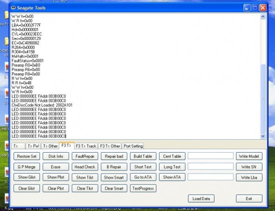

Hello friends
I'm working with 2.5 sata hard drive laptop ST500LT012 500Gb.
Connect with Seagate Tool error
rst 0x10M
  SIM Error 2009
  RW Error
LBA = 0x00006933
Hd = 0x00000000
CYL = 0x00024B64
Sec = 0x00000129
EC = 0xC4090082
R264 = 0x0000
R304 = 0x415B
MxHalts = 0x0001
FaultStatus = 0x0001
Preamp R0 = 0xB0
Preamp R6 = 0x00
Preamp R8 = 0x00
R W h = 0x00
R R h = 0x38
W W h = 0x00
W R h = 0x00
LBA = 0x0002F77F
Hd = 0x00000001
CYL = 0x00023EEC
Sec = 0x00000129
EC = 0xC4090082
R264 = 0x0000
R304 = 0x415B
MxHalts = 0x0001
Preamp R0 = 0xB0
Preamp R6 = 0x00
Preamp R8 = 0x00
R W h = 0x00
R R h = 0x4B
W W h = 0x00
W R h = 0x00
LED: 000000EE FADDR: 003B00C0
CfwDiscCode Not Loaded: 2002A101
Hope you help me fix this
thank you

 Post subject: Re: hard drive SATA 2.5 ST500LT012 connection terminal error
PostPosted: May 18th, 2016, 14:55
Posts: 190
Location: egypt
try to log to Terminal
with any way
