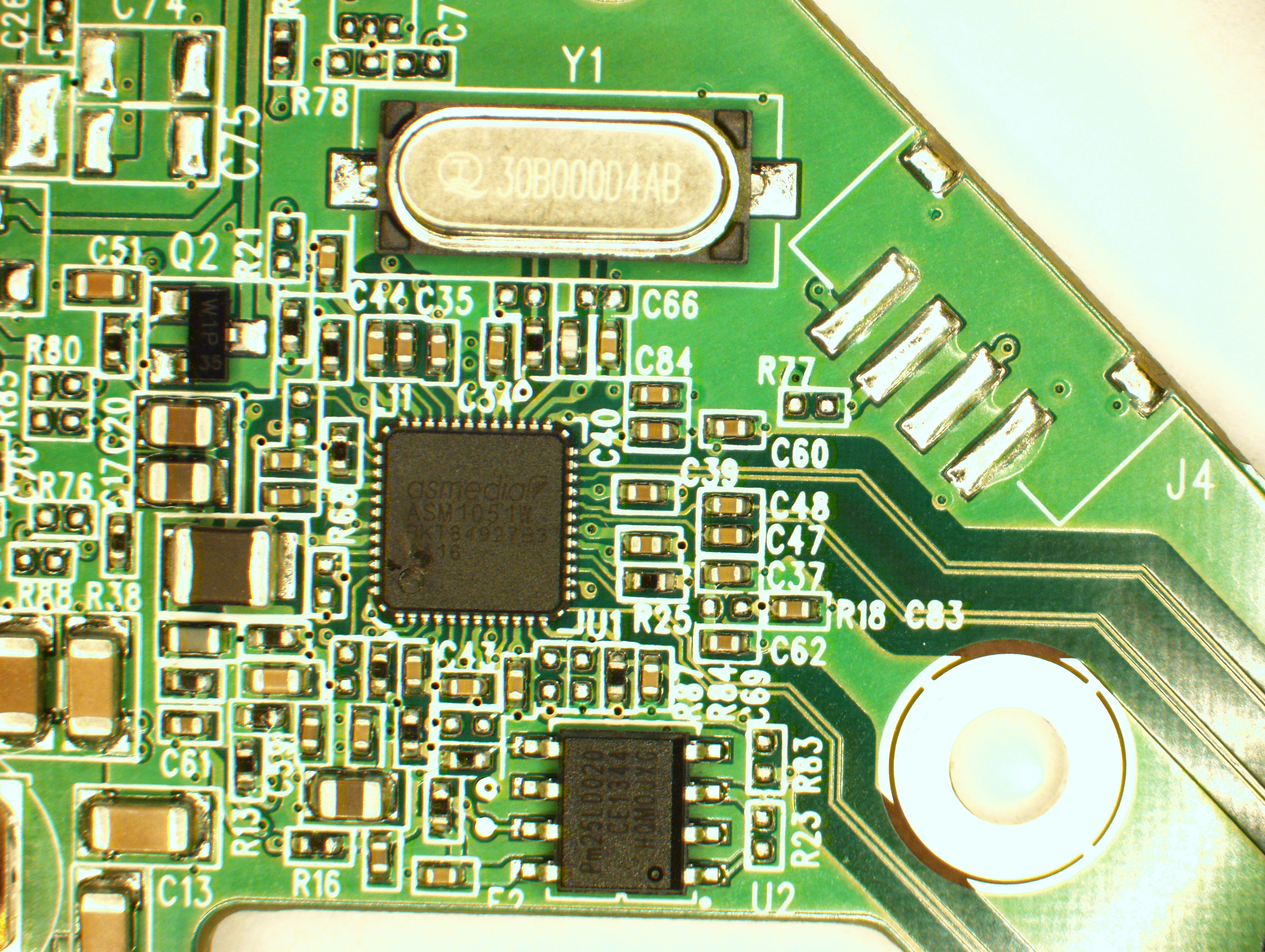

I have a WD MyBook USB 3.0 4TB External HDD that's acting up (WDBFJK0040HBK-04). I put about 3.2TB of my laboratory's data on it when we were at our old institution. We relocated the lab and the HDD physically came with us. At the new location, the drive would not boot. I flew back, got another HDD, and repeated the process. In the new location, I got the same result - no power, no whir, no LED, nothing.
Seeing as we had two of these, I figured I would shell/look inside one of them to see what was wrong (I have modest EE training). Turns out, the electrical outlets at the new location have way too much fluctuation (they were recently installed as part of a lab renovation) to keep these bridge boards happy. Diagnostically, I had the following:
Outlet + Surge Protector: LED is working, but the drive doesn't spin up
Outlet alone: SATA Bridge Board makes that popping sound, square controller chip starts to smoke :roll:
So, to see how far the electrical damage had gone, I disconnected the USB/SATA bridge board and put the HD directly into a computer that has matching drivers/OS. Here's the exciting part: it boots up/spins, and Windows even recognizes it as "Drive E:" where it should be. However, I can't see the information on it - I get asked to reformat the drive.
With that in mind, my reading suggests that I need to replace this board/chip. As I understand it, there is a level of encryption at this stage, so even though I can (in theory) bypass the USB for data Tx and the shorted power circuit, I can't get the data back without that board.
I was hoping someone could confirm that this was the direction I needed to go in - replacing the part (4060-7051749-000 REV A) and power transformer (just in case). Is there any aspect of this I might be missing? After getting through this stage, I would hope to see a prompt for the BitLocker password (which I have).
Thank you so much for your time.

What was the bridge IC on the USB panel?

I make the Bridge Square IC to be:
asmedia
ASM1051W
BKT8 4927B3
1116*
*this is where the plastic melted

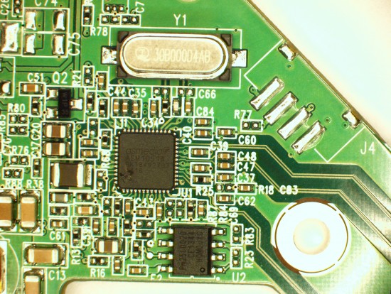

Here is as zoomed out as our scope camera would get, and you should be able to make out the burnt-out IC.
File comment: Bridge

The documentation confirms that the product incorporates hardware encryption:
http://www.wdc.com/wdproducts/library/A ... 705863.pdf
That said, I would have thought that Windows would have prompted you to initialise the drive rather than formatting it ... unless you had already mistakenly initialised it. Did you?
BTW, the bridge IC should be getting power from the onboard regulator and/or the USB port. AFAICT, there must be additional damage upstream.

You need to replace 4060-7051749-000 REV A. Usually it's enough to get access to data if you didn't do anything else with drive.

I think you'll find that the number should be 4060-705149, not 4060-7051749.
BTW, if the damage was the result of an external event, then I would expect that U5 would be damaged as well (U5 is the 5V regulator). AFAICT, the damage to the bridge IC appears to be in the area of its on-chip Vcore regulator. I believe that Vcore would be derived from the 5V rail. If U5 is damaged, then this would point to a problem with the adapter.
Here is a detailed photo of the PCB:
http://cdn2.goughlui.com/wp-content/upl ... 0-0066.jpg

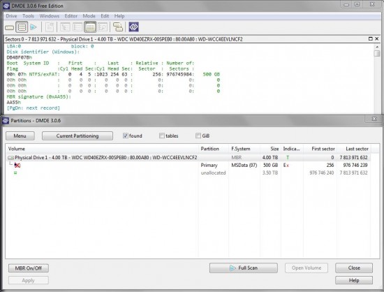

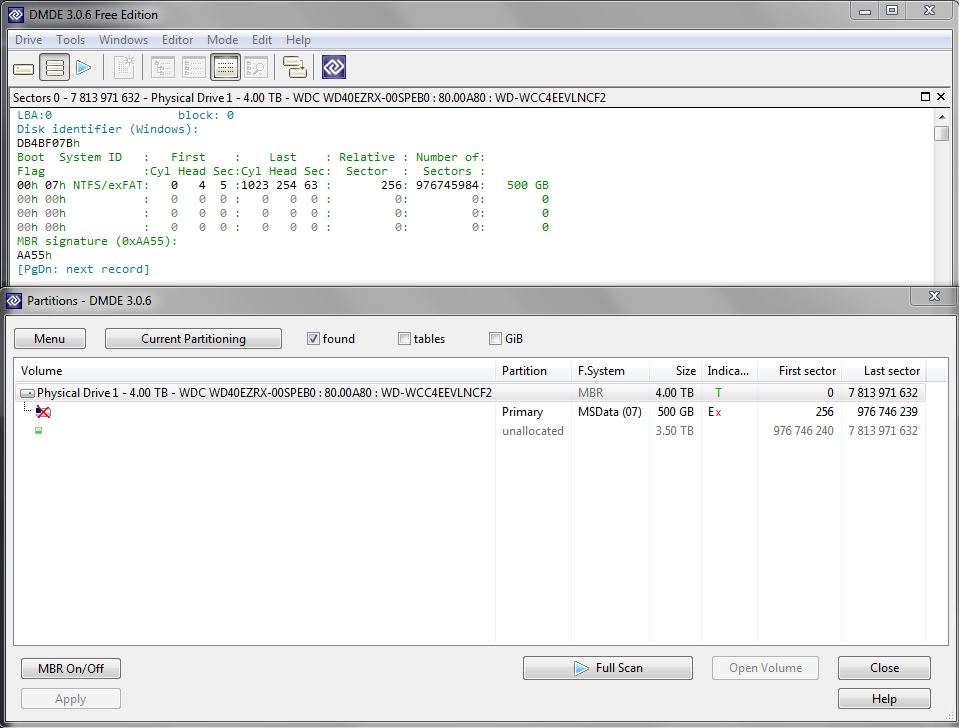

Here is a DMDE screenshot for the drive and the background is when the top "MBR" section is selected - the disk is inside of the computer, and is still recognized as initialized volume E: that needs to be formatted.
I'm reading my way through the manual/help - but the "primary" data table has all lines with the following:
NUMBER: E5 E5 E5 E5 E5 E5 E5 E5 E5 E5 E5 E5 E5 E5 E5 E5 a(dot on top) 16 times
Is this what it reads when it's empty/inaccessible/damaged?
