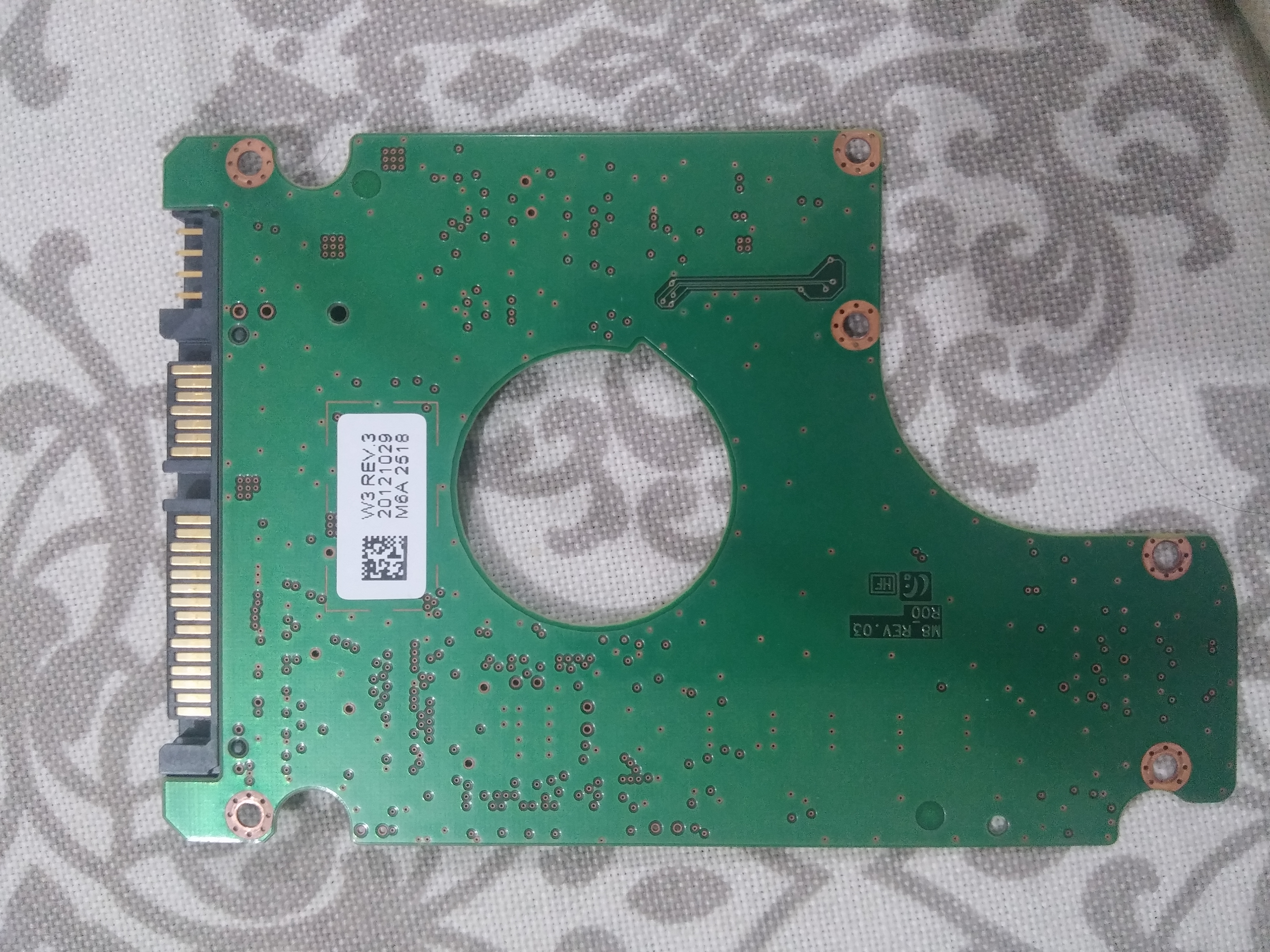

When problem begun first time, computer was recognising hdd hardly..after try to connect many times..Now it doesnt recognise at all...Just the led is blinking, there is no any sound...motor doesnt turn..i checked out the motor connection with multimeter, there is no voltage.
First i think i would solve problem with changing sata-usb converting card (box) but it doesnt help (now i am sure that both is working)
After watching a video in utube, i oepened cover of hdd (to be sure head doesnt stucked on disc, it was in parking possetion)
Probably problem is the pcb, is there any solution /check to pcb....or i have to change it ?

If you upload detailed photos of both sides of the PCB, I will try to help you.

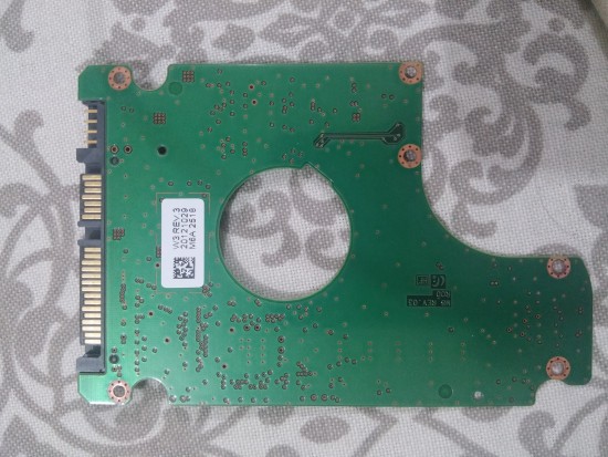

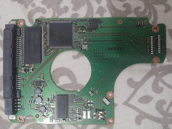

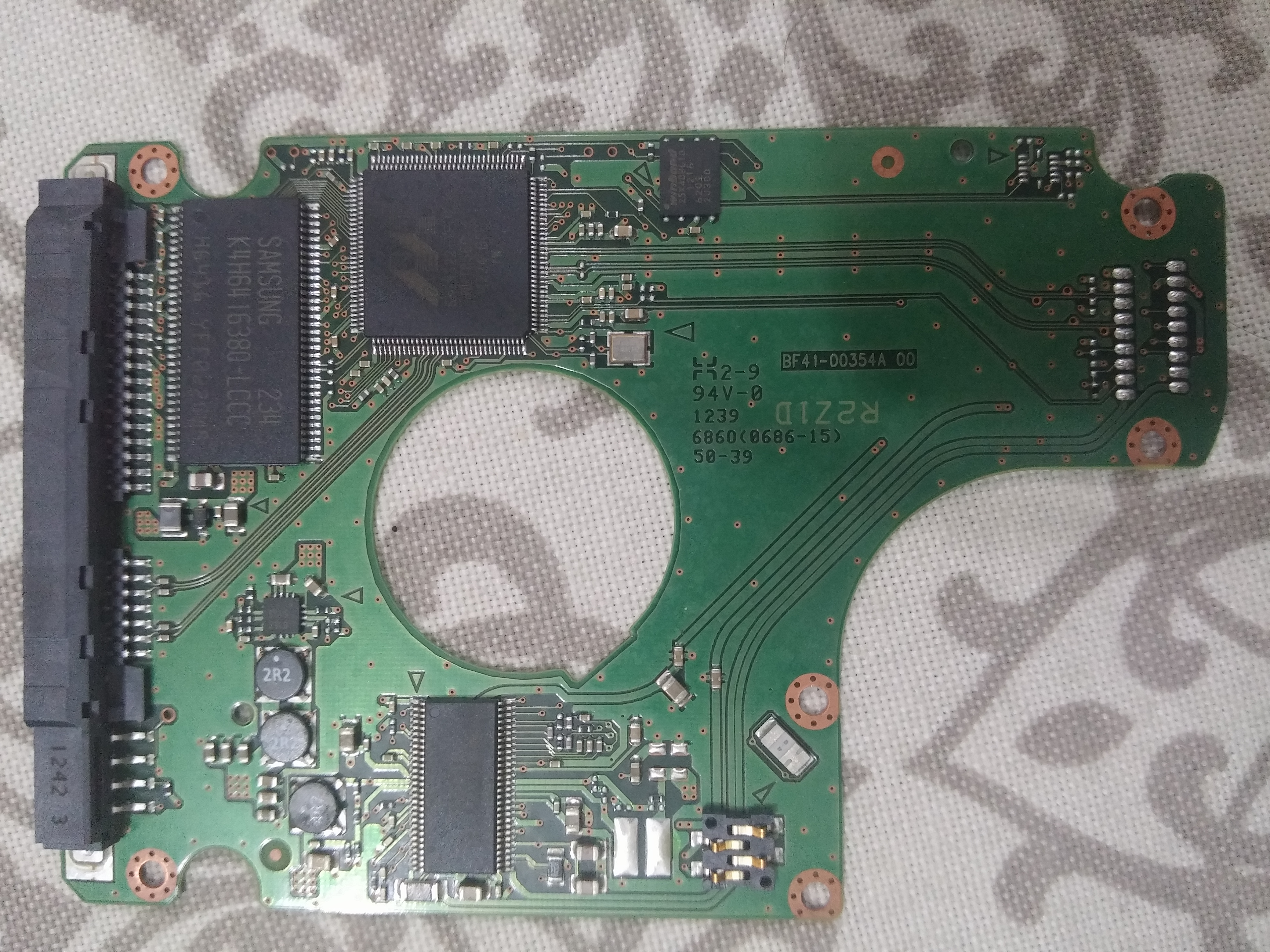

 Post subject: Re: Samsung ST000LM024 1 TB HDD PCB Problem
PostPosted: May 19th, 2016, 16:04
Joined: April 24th, 2016, 11:35
Location: Turkey
Here both side of PCB.Thank you for response.

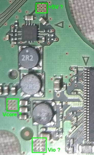

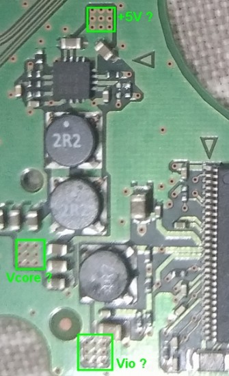

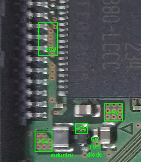

PostPosted: May 19th, 2016, 18:14
Posts: 17328
Measure the Vcore, Vio, and 5V test points in the attachments. Use a screw hole as your ground reference.
PostPosted: May 19th, 2016, 19:19
Posts: 219
As fzabkar said, you can check voltages in the showed points.
Step by step:
problem with +5 V -> inductor and/or suppressor (diode)
problem with V core / IO Voltage -> MOSFET DC/DC converter (or surround elements)
if voltages are OK -> motor driver IC (or surround elements)
With less probability, it can be problem with MPU, but it's rare enough. BTW, do you have any activity in terminal? Log?
As it said above opening the drive was a bad idea, so close carefully and do not touch ;)
Fastest way to solve problem - check preamp voltage pins for short circuit, move ROM IC to the good PCB and proceed working with drive with new PCB (with original ROM). Good luck.
PostPosted: May 22nd, 2016, 11:45
Location: Turkey
if Vcore : 1 V, and Vio : 2.3 V, other 5Vs seems ok.
i know openening it wasnt a good idea but i came the point all or nothing.and in video he says its often problem (stucking head) so i thought i found the solution.i was careful, didnt touch disc.
if i can be sure that fault is in PCB, i will try to find new one (complete hdd) and replace it.
thank you for response.
