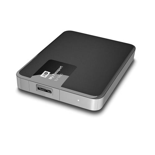

HI I NEED TO COVERT WESTERN MY PASSPORT ULTRA 2TB. USB TO SATA IN ORDER TO RECSCUE DATA.
THANKS.

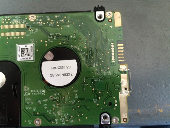

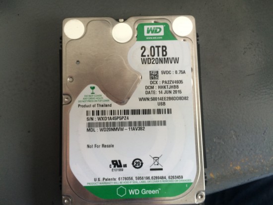

The hard disk is not recognized by any computer but if it works, I have a DFL DATA DR. PRO. 3.0 but it is not usb
SO I it have to do BY sata

771959 will do
Of course need to transfer the ROM chip (or its contents)
Need to take care on SED ... I hope you know the drill

Convert your hdd in sata by changing PCB.
PCB number of your hdd is 2060-771961, swap it with equivalent sata board...
771960, 771939, or 771959 (MCU version should be the same written on native pcb MCU).
You have to swap ROM from usb native pcb to donor sata pcb, then try to clone surface with DE or similar.

Use xx1960 SATA PCB instead of patient PCB, it is complete analog. 1959 is compatible functionally, you can use it also, but not all screw holes have the same location as on the original PCB (fit it carefully).
Can you make photo of USB bridge IC?
Usually it is JMS569 (not crypting). SED could be applied, but not so often.
