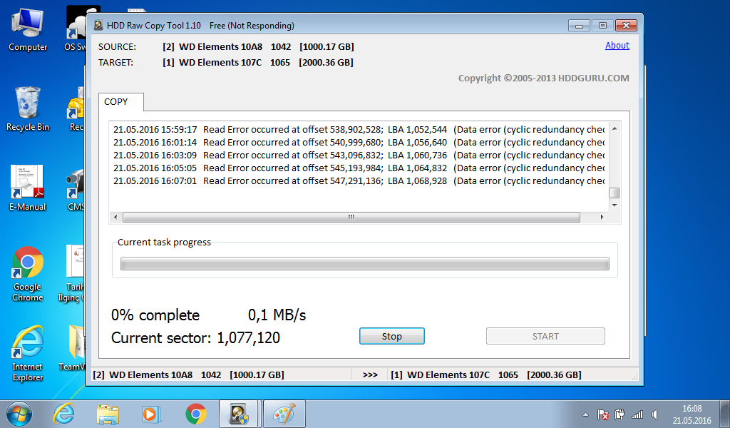

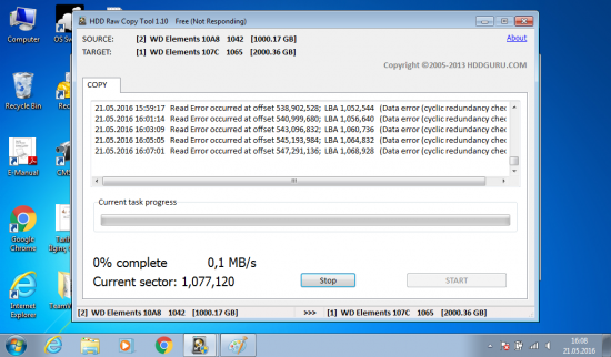

I tried Hdd raw copy tool but after half hour still %0 percent complated, what should I do ?

merhaba Abi.
there are underlying issues with hard drive.
need to diagnose it first.

Very likely surface is damaged.
Check SMART with CrystalDisk, if you see reported errors on attributes 'pending sectors' or 'reallocated sectors' then is definitely surface issue.

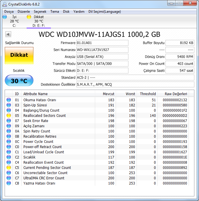

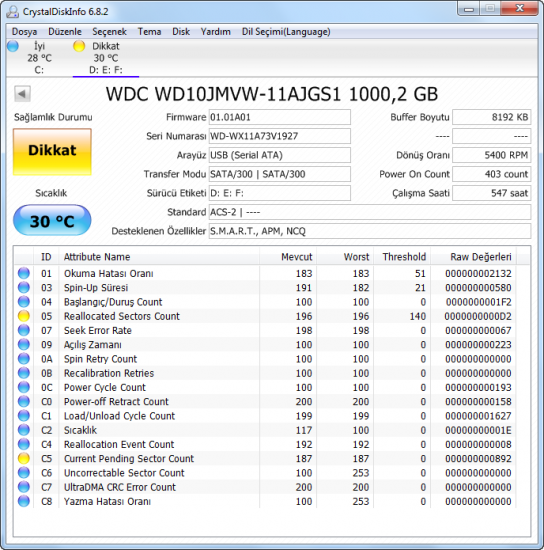

 Post subject: Re: WE elements recover
PostPosted: May 25th, 2016, 6:42
Joined: May 25th, 2016, 3:16
Location: Turkey
I forgot to say; I have made quick format to 2 partition, I can but one partition I can not quick format does not allow I have added crystal disk info to attachment.
thanks for help.
thanks for help.
do you need data on the drive ?
why quick format it ?
its probably a FW / Bad Sectors or worse case 1 of head has issue.

Posts: 219
Actually, recovery utility and SMART directly tells about problem (bad-sectors). Cloning the drive is necessary (by any possible type of tool/equipment), then scan&copy process.
PostPosted: May 26th, 2016, 19:22
Posts: 219
Drive have current pending sectors so RE-LO list have entries and that list is loaded to RAM taking up resources
Wow :)
First of all, having pending problem (slow processing/responding) drive will give ID with big delay. So how much time user spent for getting drive ID? In second, drive is USB and for such drives it is normal to have big delays during processing of bad sectors. Of course, pending process could go collaterally increasing delays. Utility goes (trying to read) by equal ranges (4096 sectors) with CRC error. Did it read anything within this ranges? Or it jumps over problem areas with fixed ranges? If no, so problem could be up to heads problem. Did it read anything before 1 milllion LBA? Problem could be a pending/bs issue up to heads problem.
One thing is clear - this situation oversteps the limits of usual customer, so preferably to ask for help of professional (until drive get worse).
apply a mod 02 patch and clear RE-LO
No need to clear mod 32 if you edit mod 02 correctly.
