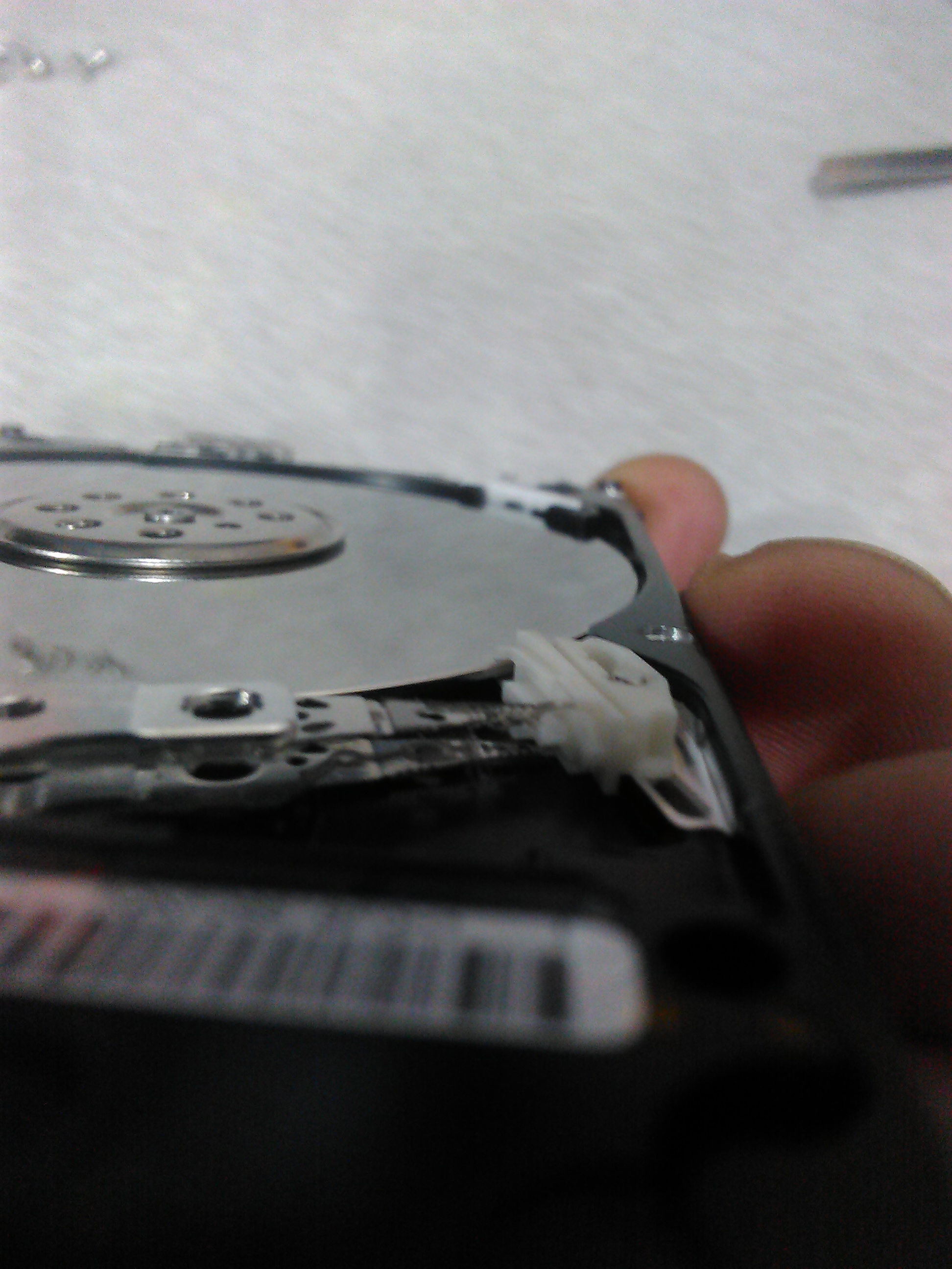

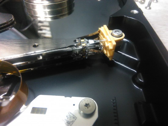

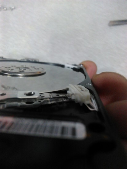

Hello!
Looks like this is not my lucky week. :D
I have received this drive as it is. Opened in another two companies before.

 Post subject: Re: WD5000LMVW-11CKRS0
PostPosted: May 24th, 2016, 12:34
Posts: 331
Hi!
The upper picture is NOT a WD5000LMVW-11CKRS0 drive, it looks like a Seagate F3 drive
PostPosted: May 24th, 2016, 12:57
Joined: December 16th, 2015, 12:37
Posts: 99
Location: GCC
yes ,
this drive comes with 1 platter 2 heads ..

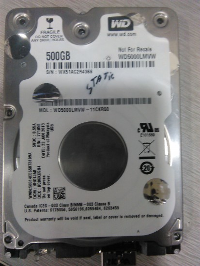

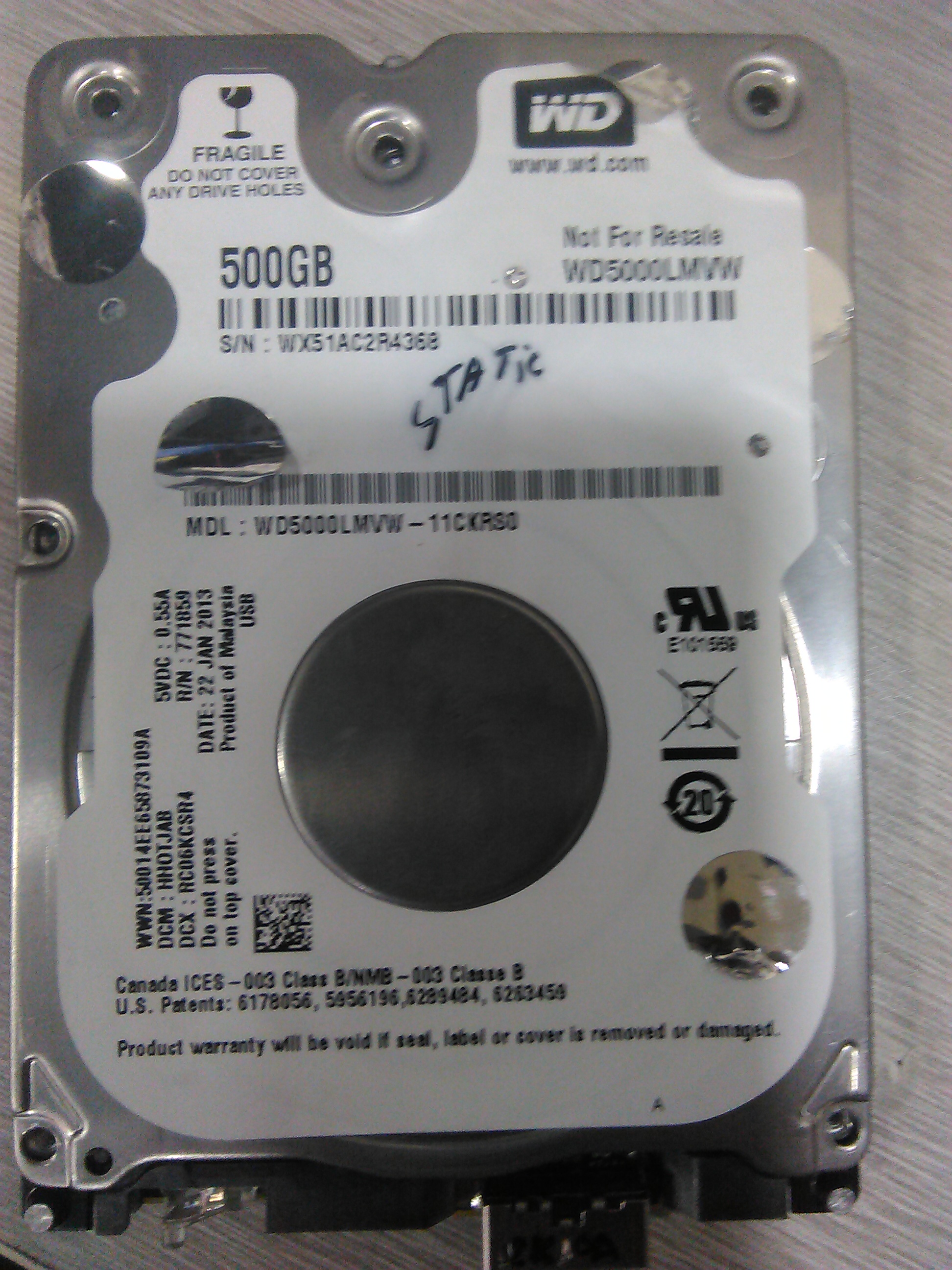

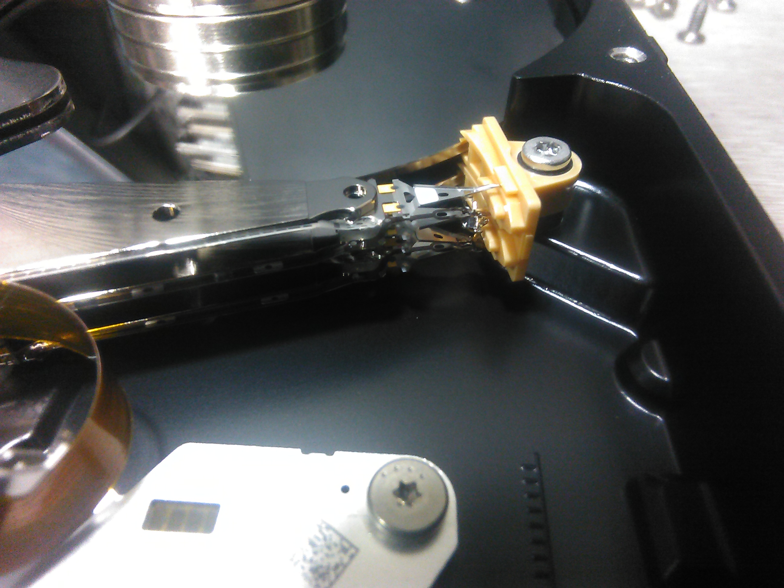

PostPosted: May 24th, 2016, 13:05
Posts: 1748
Sorry. :)
PostPosted: May 24th, 2016, 13:21
Posts: 1748
Update:
After replacing heads the drive ID's correctly with full model, FW, Capacity and SN.
In DE it shows partition NTFS and I can see the full structure of data but when imaging it images until first 168 MB then gives error. Backward copy gives the same error.
Soft reset, hard reset and reset power but also shows error.
Any suggestions?
Thanks in advance.
