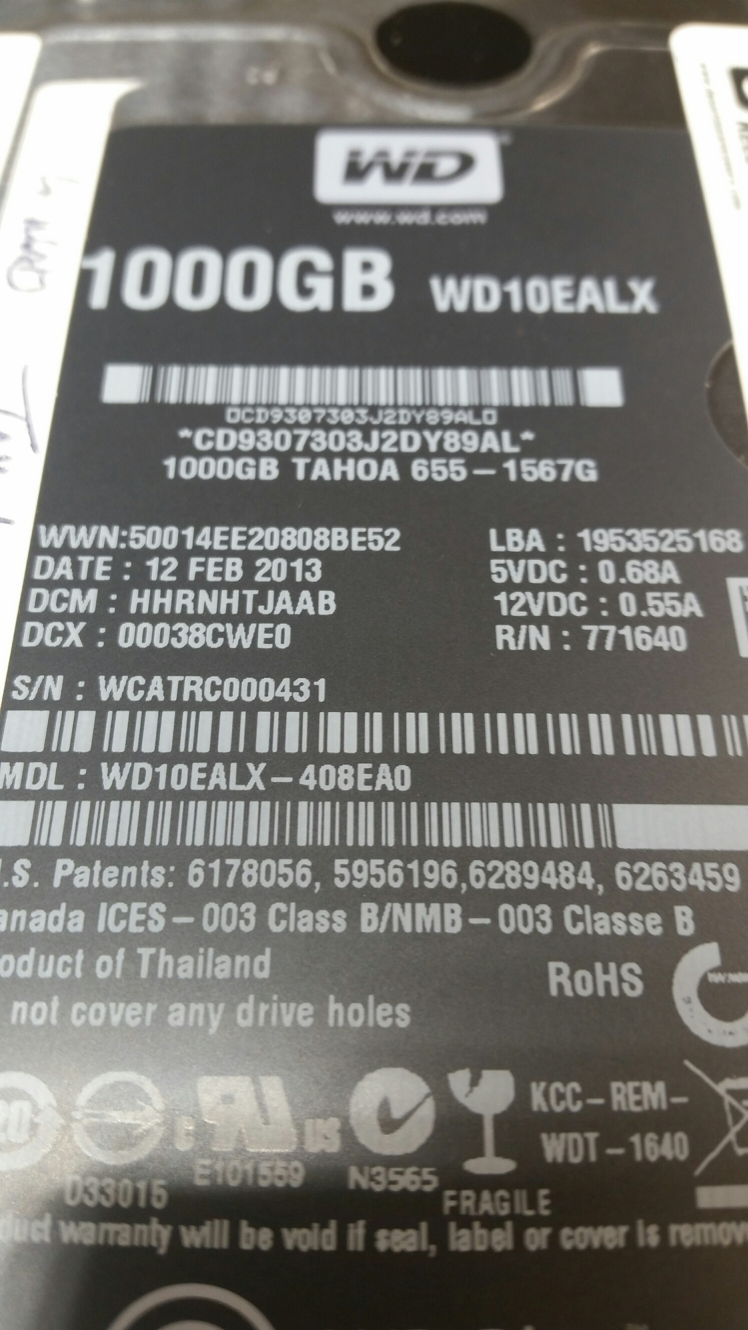

I have an Apple drive that needs a head swap. It's a WD Blue pretending to be something special. Being Apple these drives are very expensive for donors. Anyone know of a compatible donor Family ID? Its a Tahoe 2D
WD10EALX 408EA0
FW: 07.01D03
Others in drive family are E4 9B E3 Z8 Z3

Unfortunely, this family have no compatible families.

Thanks Martin. Someone asked me to post an image of the label by PM.

You can use a WD1001FALS-xxY6xx
Much more common :-)

Thanks Sean :D
