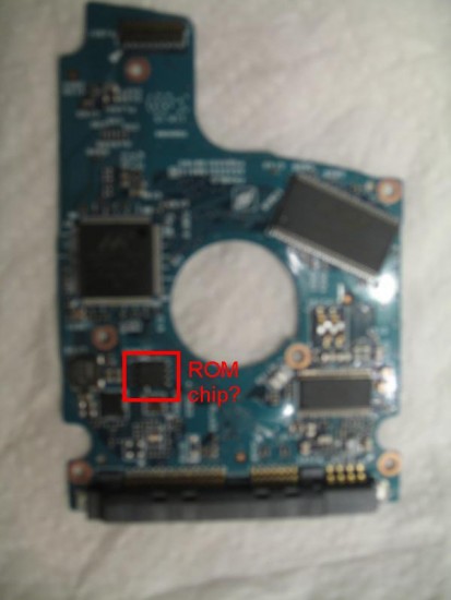

Yes, I will get a picture posted. Is there anything in particular you are looking to see? I can't seem to get a very good focused picture of it. lol. I also tried a program called Disk Recoup. When I ran that, all I got back was "Data Error: Cyclic Redundancy Check." I have posted a pic of that as well. Again, this was with the new PCB board, as it would not even recognized the drive with the original PCB. I have also included pics of the Toshiba drive showing up in Device Manager and Disk Management. In Disk Management it is Disk 1 Unknown, and again, this is with the swapped PCB, and the drive does not show up at all with the original PCB.

I think this might be your ROM chip that must be transferred to the new PCB. But you need to send up a better image to be sure. Also, be very careful when removing the chip, they are very sensitive and break easily. I learned that t he hard way.

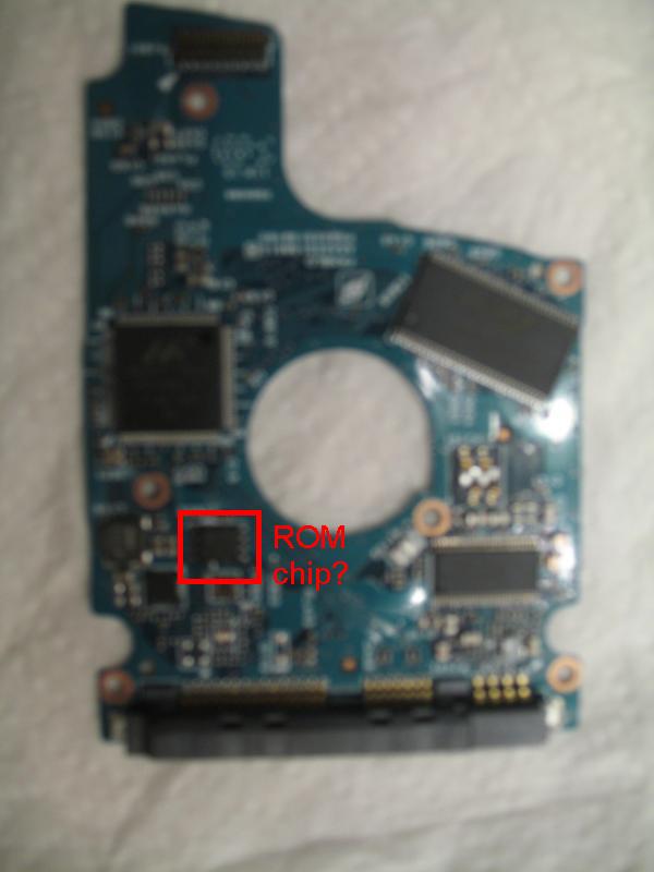

Thanks for all of your help so far. Will this image work, or is it the numbers on it you are trying to see?

IC602 is your ROM chip, it MUST be swapped.

Thank you all again for your assistance. Can I ask this...what does it mean, if anything, that when I put a new PCB on the drive, that even though I couldn't read anything from it, that is still showed up in Disc Management and Device Manager? I'm hoping it means something positive, and that my data is likely recoverable if I can get a matching PCB with ROM chip swap.

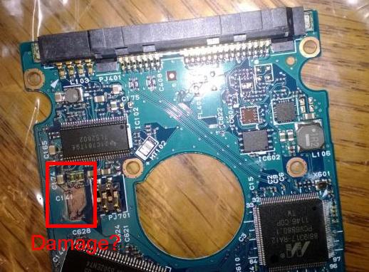

In theory, the drive should work if its only been a water spill on the pcb. By the way, do you have a closer image of the PCB. there seems to be some damage to the upper left of the board under the motor controller chip.

It actually does look like it from that pic, doesn't it? Just got home and looked and took another picture. Here is a closeup of the area. Appears to be just fine. Yeah, I sent pics of my hard drive and PCB to four different places to see if they could match, Donor Drives was the only one to even respond to me. I'll likely be sending it in tomorrow for the chip swap.
