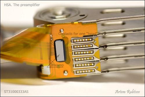

Maybe possible, without any information from the Pre-Amp it's difficult to analyse, is there some where documentation concerning repair / Replacement of the Pre-Amp ?
 Post subject: Re: Samsung HD203WI Not reconized.
PostPosted: June 9th, 2016, 5:07
Joined: June 2nd, 2016, 7:46
Posts: 15
Location: France
It seems impossible to exchange the preamp !!! Because this one is so close from the HSA ...

DO NOT SWAP PLATTERS!
"All" it needs is a replacement heads assembly, which the preamp is a part of.

Nobody swaps platters if problem in preamp (except some "special" models like n40p). Nobody changes preamp too if problem in preamp (except "special" models like Viper), but it's possible for your samsung. First of all you need to find out what is main problem. It's look like it was problem with system modules or errors. If preamp is dead you need change heads, solve problem with modules and read data.
