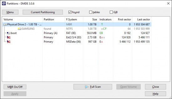

Hi guys, i know everybody here use a lot win32DiskImager... and i had one problem that maybe some have experienced it.
I have Accidentally wrote a retropie image(*.img) (using Win32DiskImager) to my external hard disk instead in my SDCard.
5s after i start have canceled the win32diskimager.
Now it reads 55MB as a partition is established on that.
there is any way to recovery the DATA that was in my external hd.
Oh god... i had so much important stuf there.....

Try an NTFS Search using DMDE:
https://dmde.com/
Can you show us DMDE's Partitions window?

So this is what I did in the weekend .
When I checked the partition that the windsik32 make, i had this ( atached Partition img )
Then i made the partition readable on the windows and start to use WONDERLIST to recovery the folders.
It found all the folder, pic, archives and the all 800G that I had.
So at the end of the process the program transfer everything for another extra HD that I have.
Today wen try to open a pic, a Excel , word or a program.... it is corrupted.
I have the 800G that I had, and the folder and archives are all there… but I can not use it.
I Still have the original drive the new archives are in another drive… And im desperate… I don’t know what to do 
the DMDE is atached on this post
File comment: DMDE Partition

 Post subject: Re: Accidentally wrote a retropie image on External Hd.... :
PostPosted: June 6th, 2016, 18:36
Posts: 17335
Double-click the 1TB Samsung partition.
Expand the Root
... or ...
Expand [All Found + Reconstruction]
- select Default Reconstruction
Select a large file, r-click and Recover the Object to another drive
Test the recovered file
