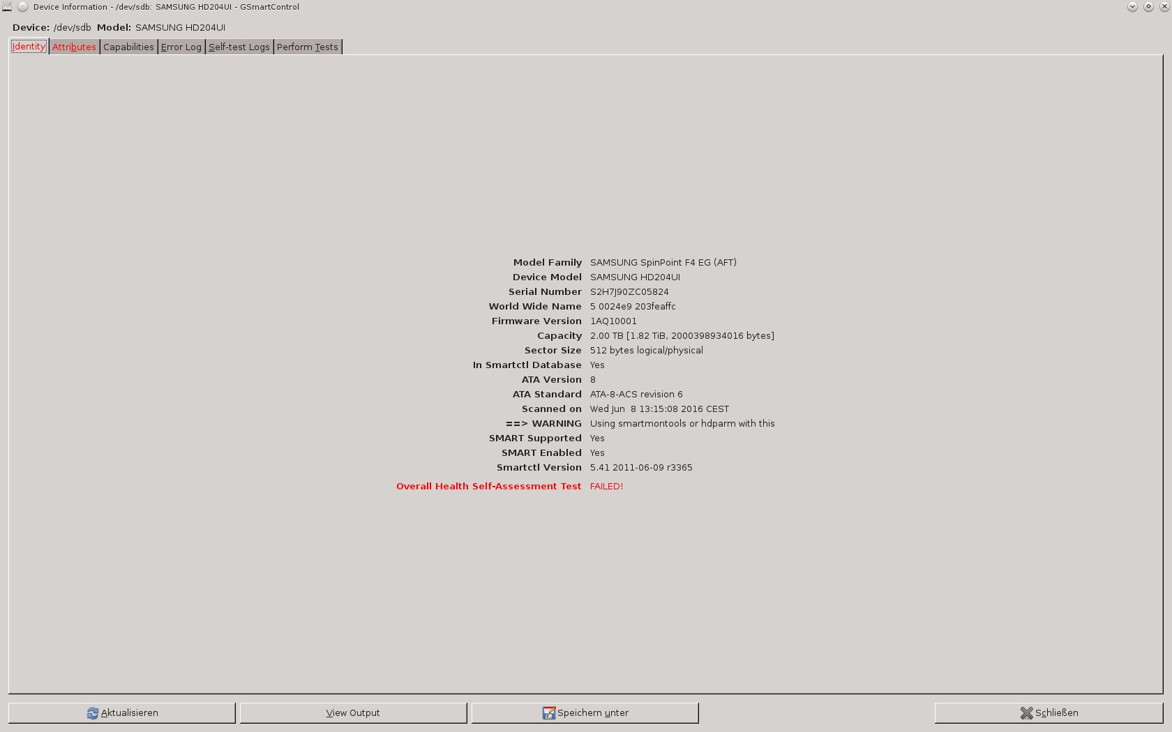

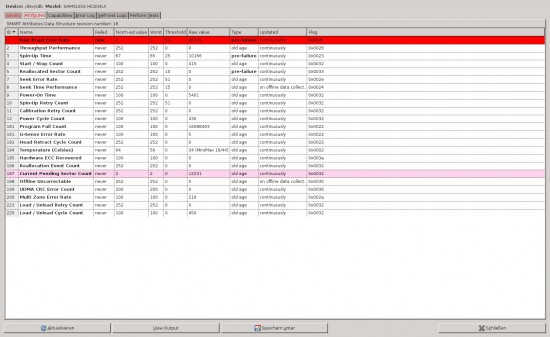

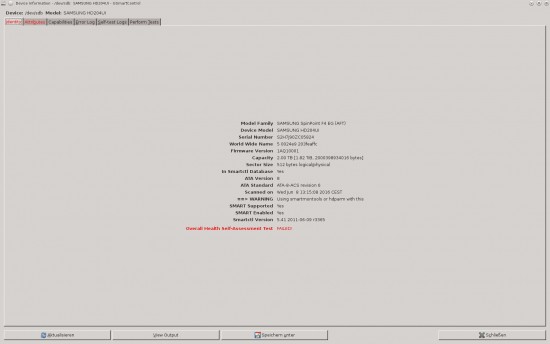

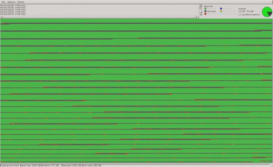

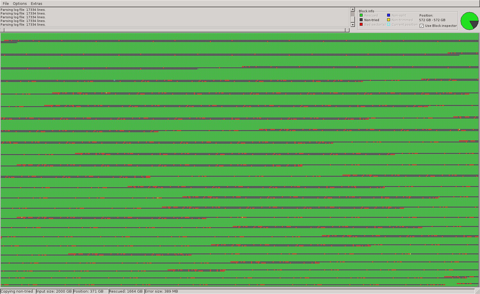

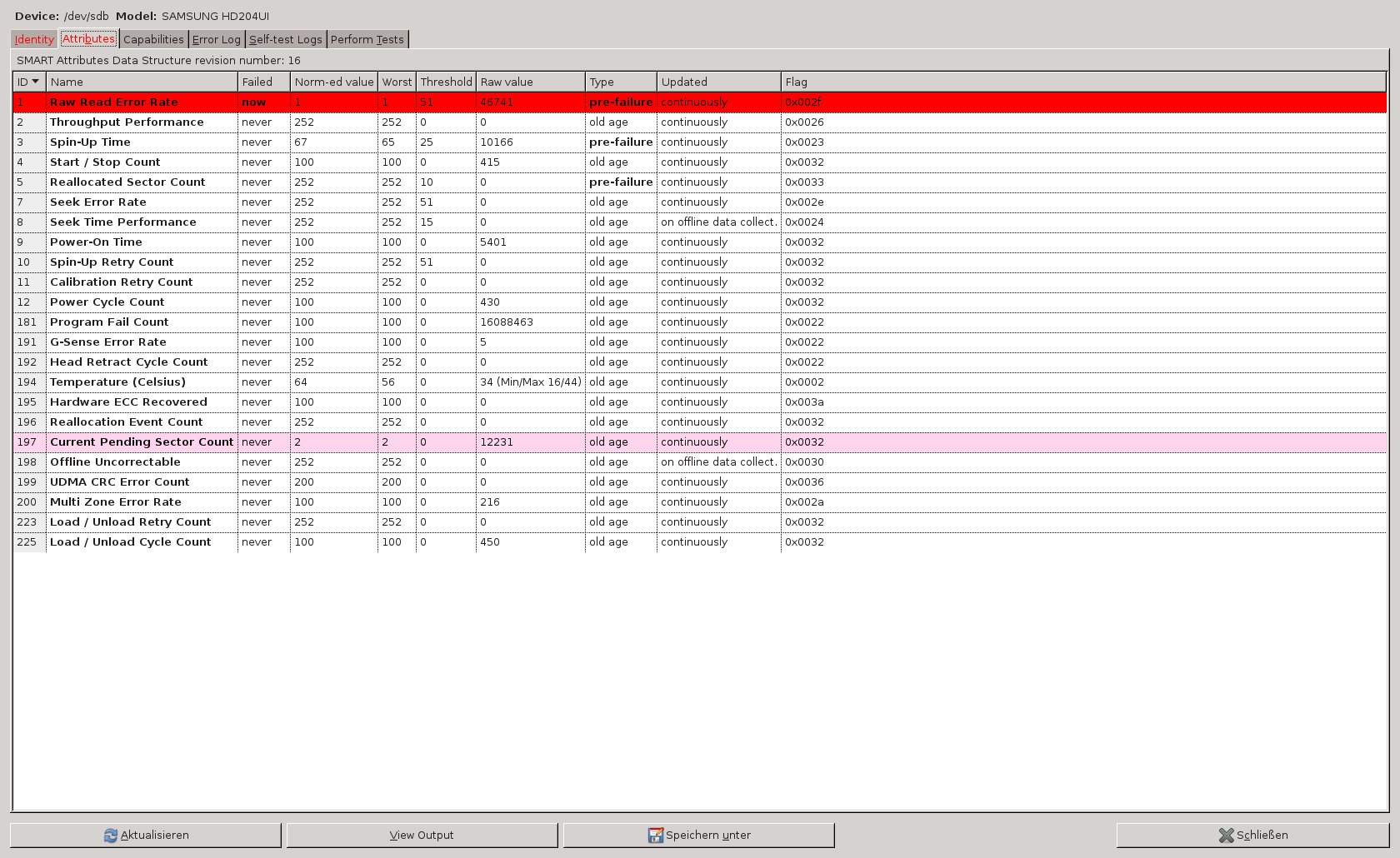

I have a problem with my hdd. From one second to another i got much pending sectors and read errors...
I've attached a screenshot of smart data and a screenshot of ddrescue log viewer.
This looks somehow as if an entire side of a platter no longer accessible. According to my research the drive have three platters... with two sides... so when i calculate 100/6*5 .. i got my 83% of recoverable data.
The drive doesn't make unusual noises. Everything sounds normal.
This condition seems stable.
I have already cleaned the contacts on the backside of the PCB.
Unfortunately has brought nothing.
I have access via TTL Adapter.. i attached a Logfile on access a bad sector...
Does anyone have an idea what I could try to get to the missing round about seventeen percent of data from the drive?
I am grateful for every idea.

I suspect a failing head on at least one surface.
The calculation of 83% is often misleading. It is not quite accurate. If there are bad sectors within a file, then the file is not good, despite imaging 90% of its residing sectors. This is especially the case with large files. Due to design, this Samsung model is more tolerant in getting files recovered compared to other drives.

I'm no expert, but ISTM that your ddrescue log viewer is telling us that there is one completely dead head (head #3).
Your TTL log appears to be telling us that defects are being written to the RList. I don't know what would happen if the RList were to become full. Would the drive become read-only, or would it go offline?
Drives normally write several sequential tracks on one head before switching to the next head. Most seem to write 100 tracks or so, but Samsungs write as much as 1GB, AFAIK. That's why you have a better chance of recovering complete files.
You can see this behaviour in a short-stroked read benchmark in HD Tune.
Sorry, I assumed that the screenshot began at LBA 0. This is not the case, so I have probably identified the wrong head. Not that this makes much difference to the outcome ...

@fzabkar:
You're right .. this was the LBA 0 ... there was no partition table and no partitions on the drive... with linux i dmcrypted the complete device.
So the only way to get the complete data from the HDD is a replacement of the head group?
I suppose the chance to swap the head group as a layman, approaches zero?
