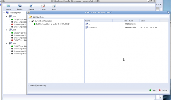

I am trying to recover my data from raid10 (ext4 filesystem) with Ufs Explorer Standard Recovery. I have three disk images (one missing disk is damaged).
File comment: screen1

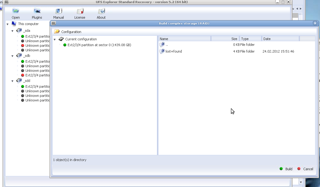

I used plugin to build virutal raid. I added ext4 partition as first and unkown partition as second.
File comment: screen2

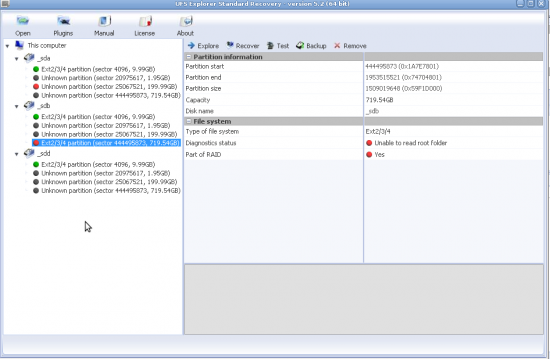

In "raid preview" filesystem is opened but I see only one dir named "lost+founds" and it is empty...

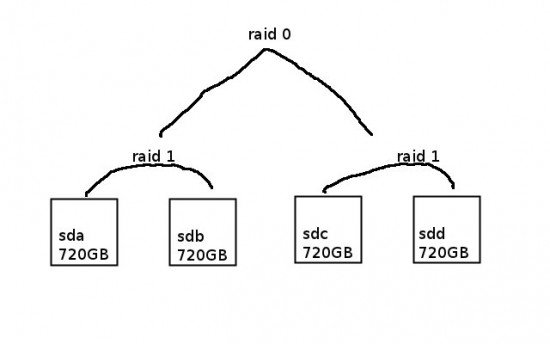

File comment: screen3
what should I do now to recover my data?

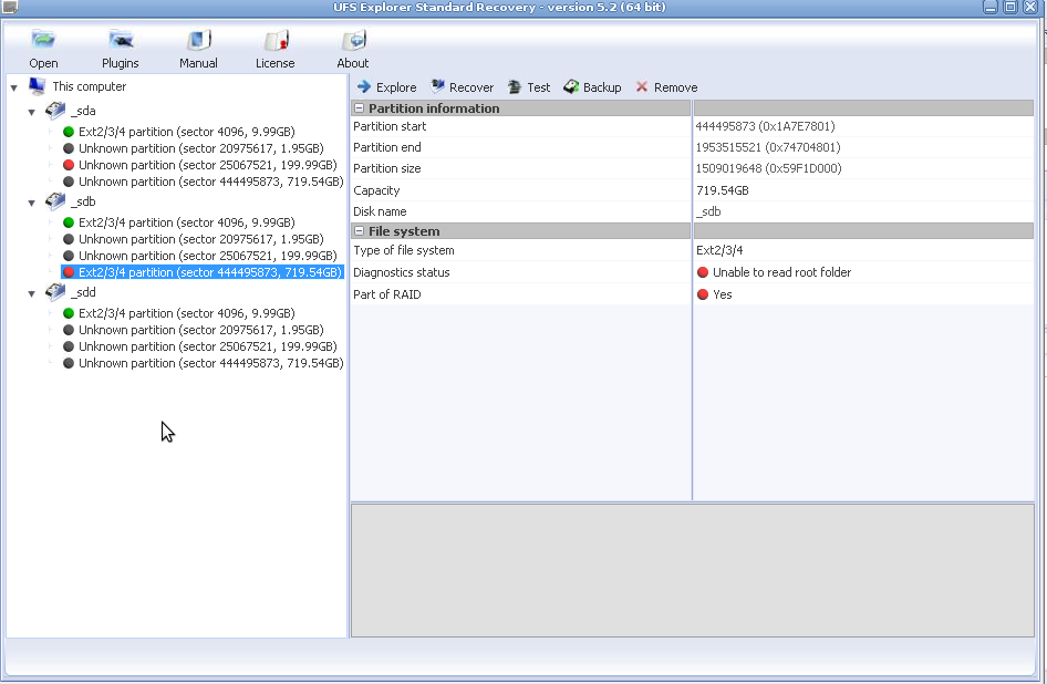

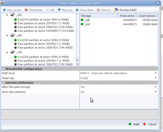

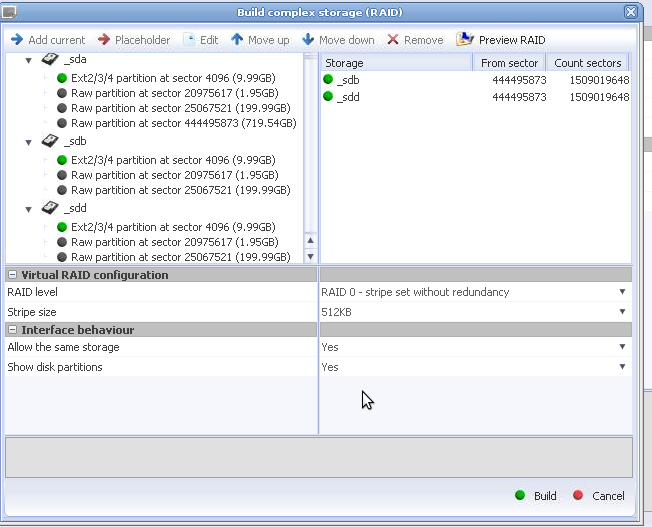

2 questions.
From the 3 drives, have you found out already which ones are belonging to the RAID0?
Also, are you sure about the stripe size?
 Post subject: Re: RAID10 Recovery in UFS Explorer
PostPosted: March 9th, 2012, 9:03
Posts: 2984
All disks will have MBR because striping does not start at sector 0. This is why you see all same information.
Use Winhex to look at sector 20975619, should be Linux superblock at at least 1 disk. Other disk should have empty space (probably)

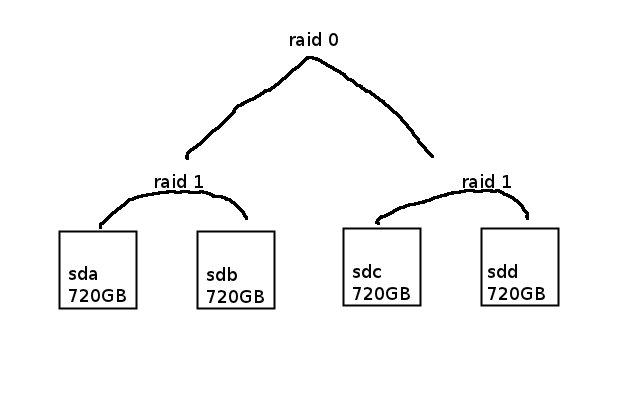

File comment: mdadm raid
it is mdadm software raid with default options (chunk-size=512)
I think sdd does not contain valid file system..
