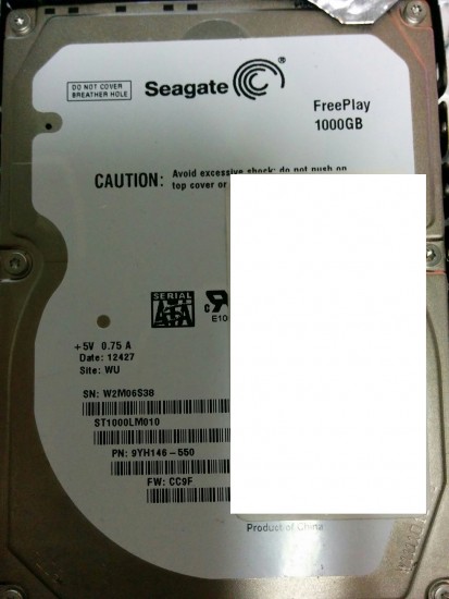

My ST1000LM010 that I think it was from a seagate expansion ext harddrive series was making clicking sounds and not recognizing.
Sent it out for a quote for data recovery and was told one of the head out of 7 heads was not working. The cost of full recovery was too expensive that I had to cancel, but they accidentally gave me the recovery data for what they could read with the working heads, which I got back around 25% of my files.
Im thinking its worth a try to replace the heads my self, but couldn't find an exact match of the drive. Anyone have an idea on the compatibility with a slightly different codes on the drive?

PostPosted: June 15th, 2016, 2:32
Not the easiest drive to swap heads in, even for some pros.
It's like asking a student nurse to perform a triple heart by-pass on their first day.
Sorry to say I'd give your chances of success on this beast as less than 1% :-(
Not what you want to hear I'm sure, but fact nonetheless.

aww :(
Not the most important data on it but still I need to give it a try before giving up.

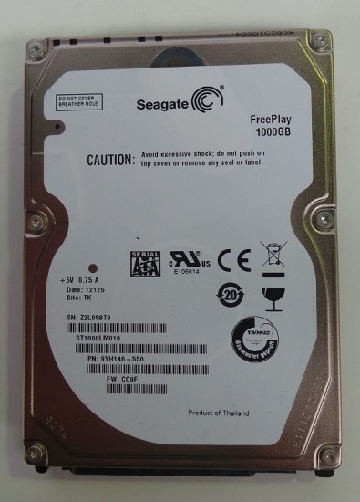

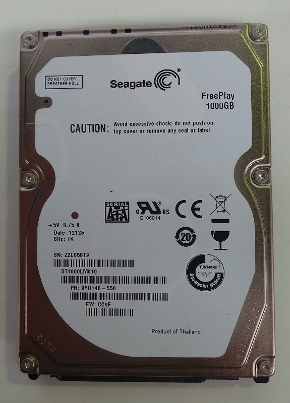

So, would something like this have compatible head?
cant seem to find one with site WU
 Post subject: Re: ST1000LM010 Head swap
PostPosted: June 17th, 2016, 8:42
Not compatible
