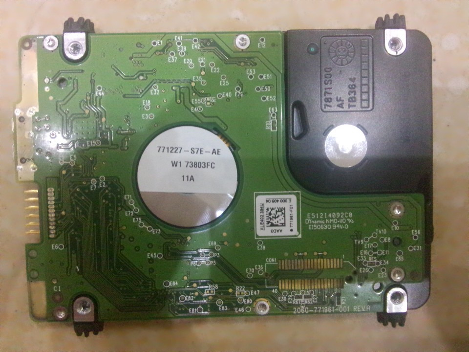

Hello friends
I have received the customer's portable hard drive USB 3.0.
WD my passport 500gb PN: WDBKXH5000ABL
Currently not detect plugged smooth rotary engine does not sound weird
hope you help me recover data
I use PC3000
thank you

Share PCB no.
 Post subject: Re: Data Recovery Hard Drive wd USB 3.0
PostPosted: June 20th, 2016, 6:56
Posts: 1388
Location: isreal
As implied by "VaibhavS", you have to convert it to sata first for proper diagnostic
USB -> SATA
771859 - 771852
771949 - 771959
771962 - 771931
the ROM chip or its contents must be transferred

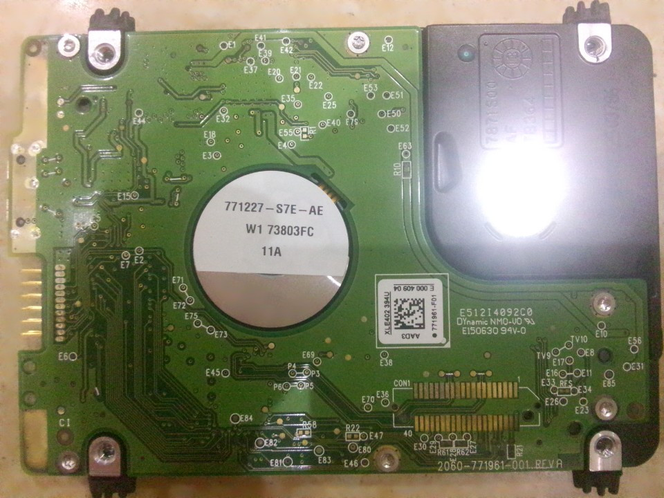

VaibhavS wrote:
Share PCB no.
USB -> SATA
771859 - 771852
771949 - 771959
771962 - 771931
I can send pictures PCB attached forward to helping
thanks

USB -> SATA
771961 - 771960, 771939, or 771959
need to transfer the ROM chip (or its contents)
also need to take care on SED ... I hope you know the drill

771960 (perfect match)
771959 (has different shape)
/771939
771933 - difficult to get
other jemy has already instructed you..
