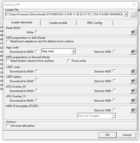

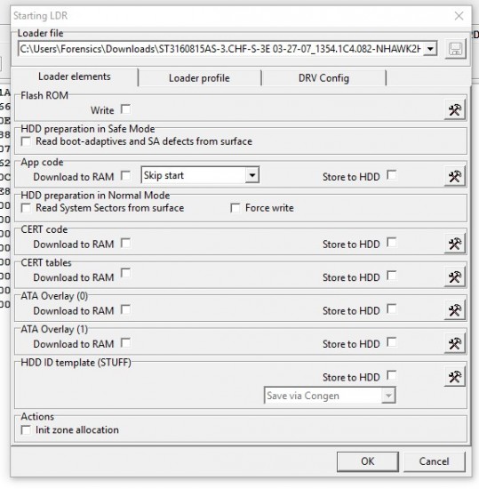

Hello All,
Thanks for keeping me on track.. and giving hints for my query,
I search on different forum for my query and I think loader for Seagate is solution for my problem,
I went through procedure.. and found loader on web..
but Im confuse on which options to select on loader element window..

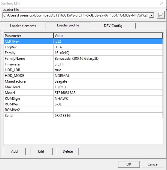

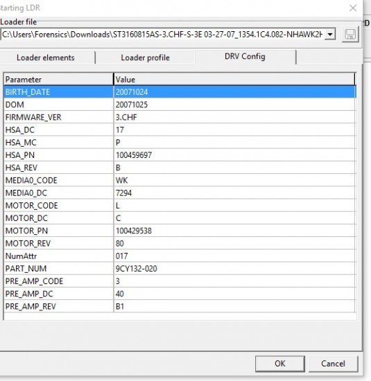

Also , is it correct loader ?

Sorted out :D its go to basic formula.. loader works successfully..
Thanks all ..

I have MRT Pro.
Before i changed HSA i have read out all HDD stuff, and made a LDR, but if i want sending loader i got this error message:
begin to load LDR ...
Path : ...............................E:\MRTPRO\Seagate U5 Bara\Barracuda 7200.10 Galaxy2D\ST3160815AS-3.CHH-9RXEEEV4\SgLdr.ldr
start writing Cert Code ...
Please switch to the T-stage
Write CertCode : .....................Failure
start writing Cert Table ...
Write Cert Table : ...................Failure
start writing ATA 0 ...
Write ATA 0 : ........................Failure
start writing ATA 1 ...
Write ATA 1 : ........................Failure
start writing HDDIDSTUFF ...
Write HDDIDSTUFF : ...................Failure
Load LDR completed
Please help....

Remove cert component loading as part of your loader. Not sure if that is possible in MRT.

Can you upload your loader and SA resources? I have worked out the structure of the Seagate F3 loader. Perhaps I could make sense of yours.
Hello labtech!
With MRT not possible remowe components from loader. :-(
Thank you fzakbar!
Here it is!
ST3160815AS-3.CHH-9RXEEEV4.ZIP [1.08 MiB]
Downloaded 530 times
 Post subject: Re: 7200.10 Barracuda stay Busy with continue terminal messa
PostPosted: June 26th, 2016, 4:27
Posts: 219
...I have worked out the structure of the Seagate F3 loader...
His drive is not F3.
