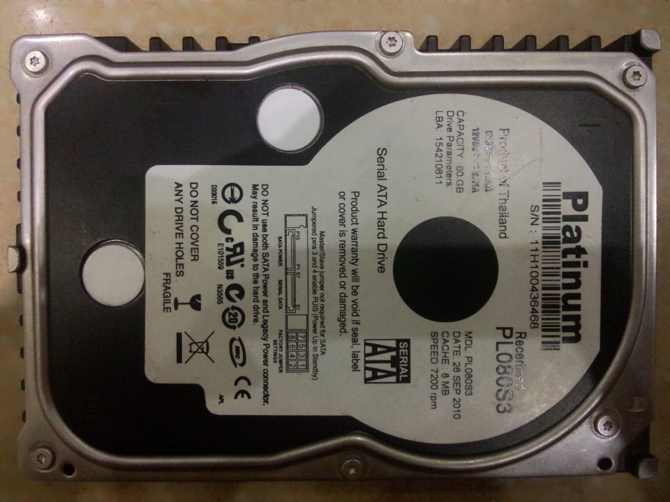

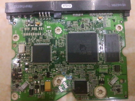

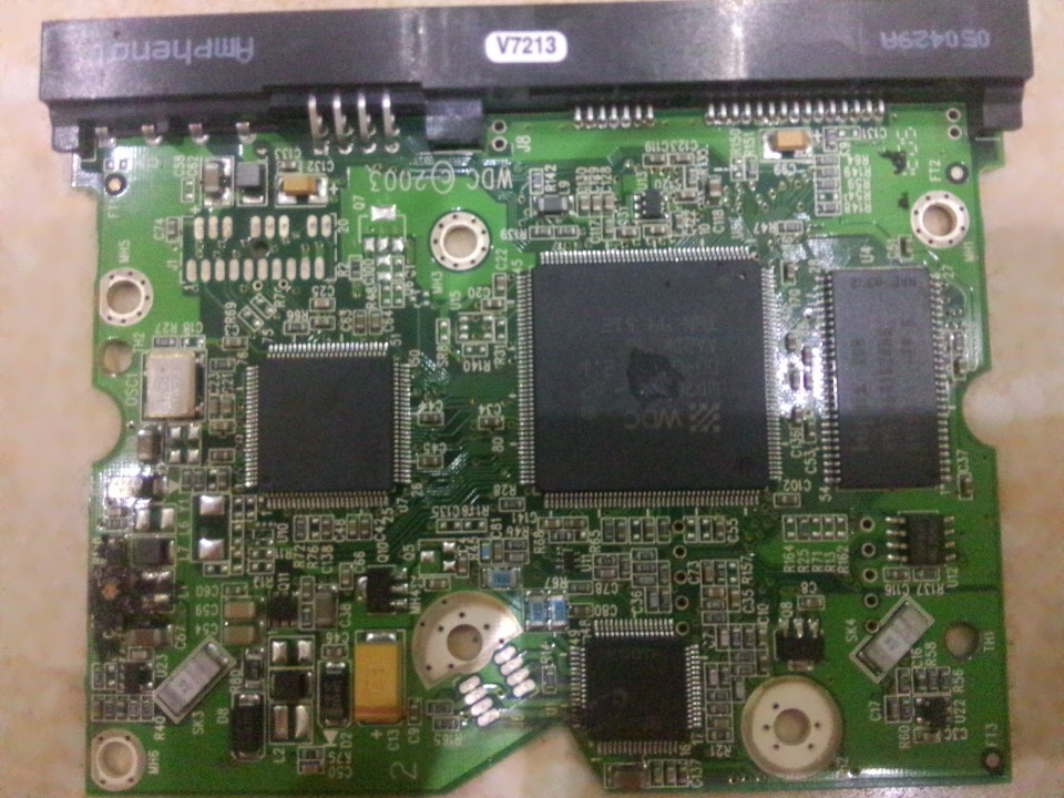

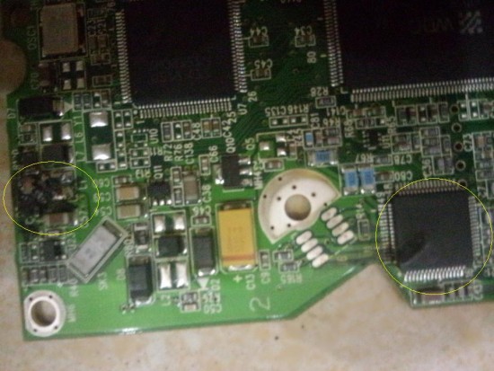

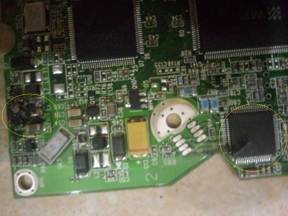

I have received a burnt hard drive PCB
I sent the attached picture wish to you help to replace data recovery
thank you

Find an identical PCB, transfer the U12 ROM physically or logically and you should be good to go...unless the head pre-amp is damaged too.
