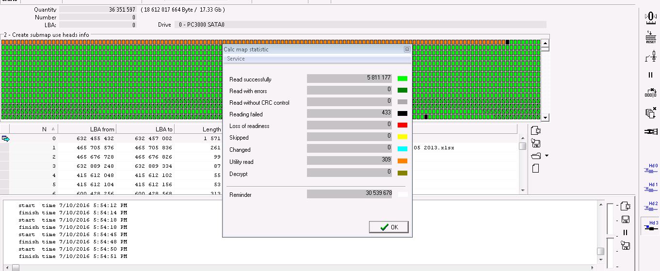

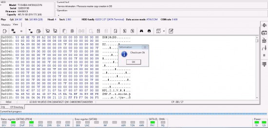

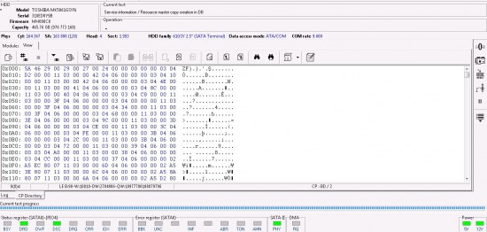

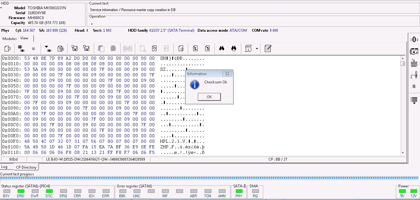

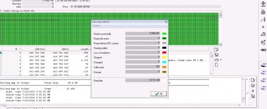

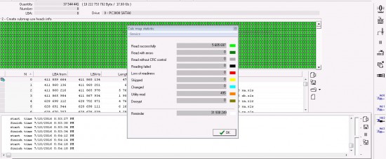

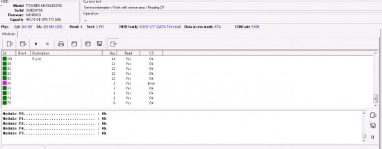

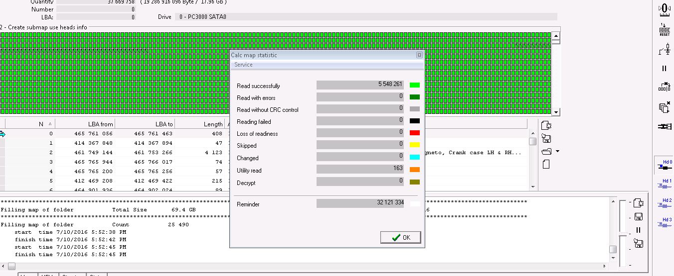

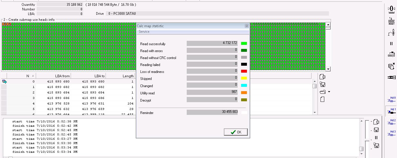

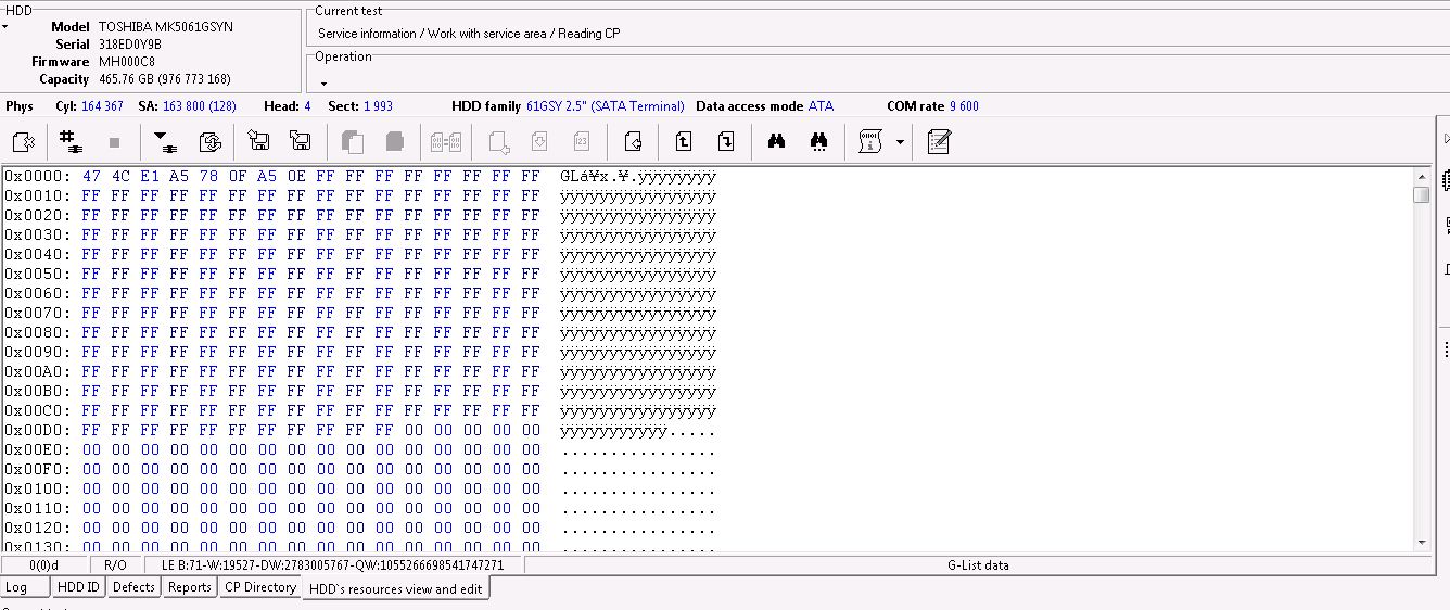

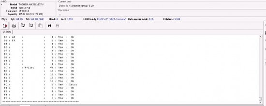

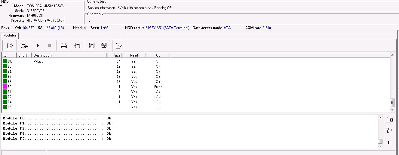

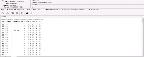

Hi

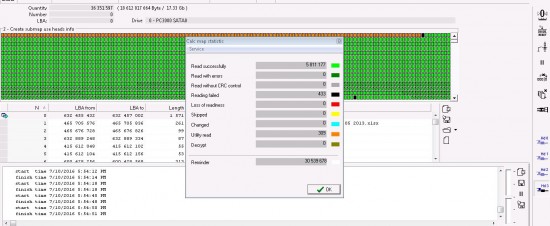

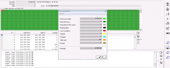

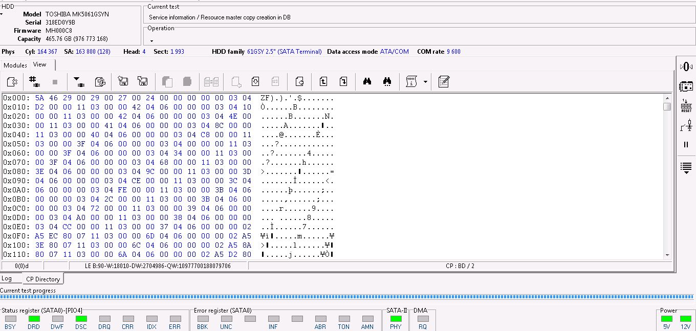

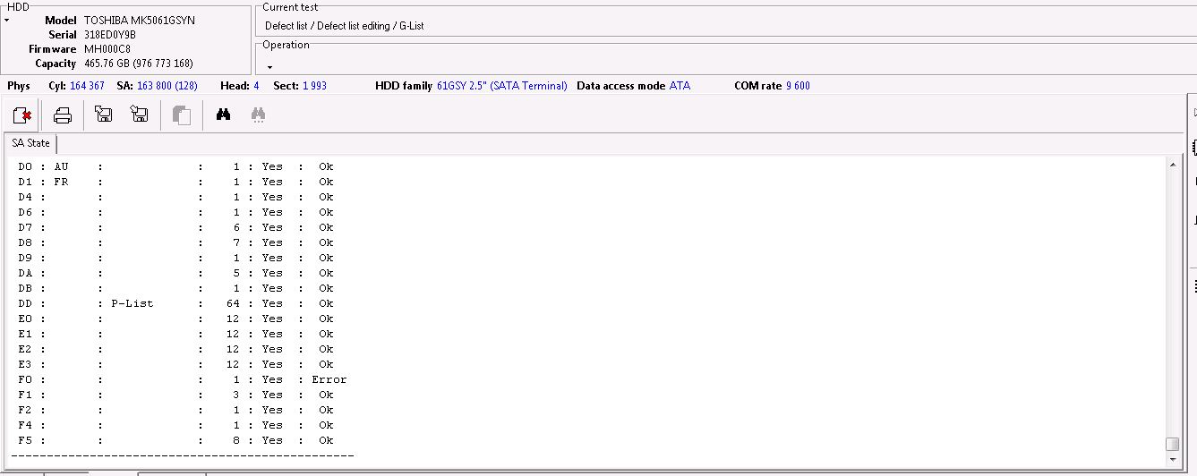

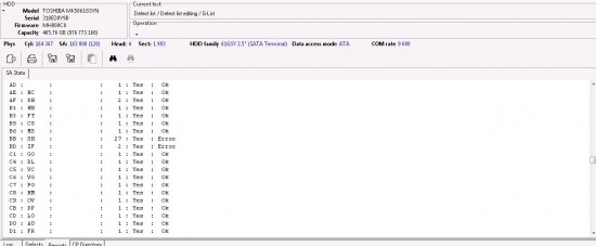

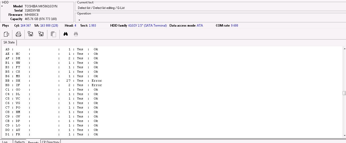

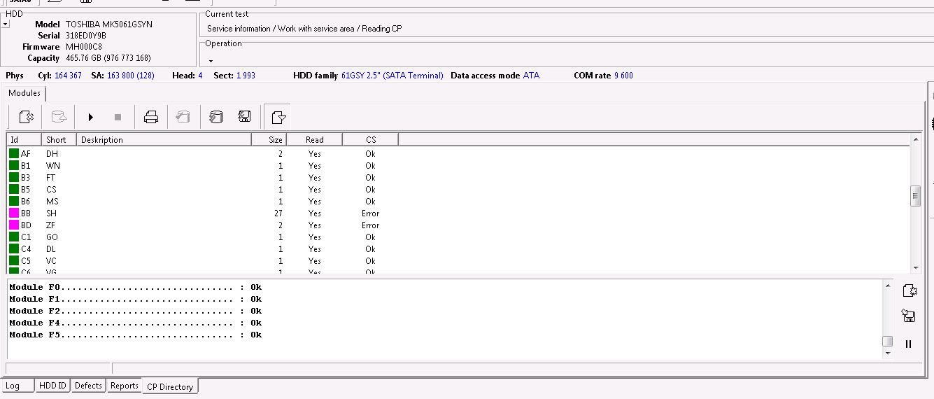

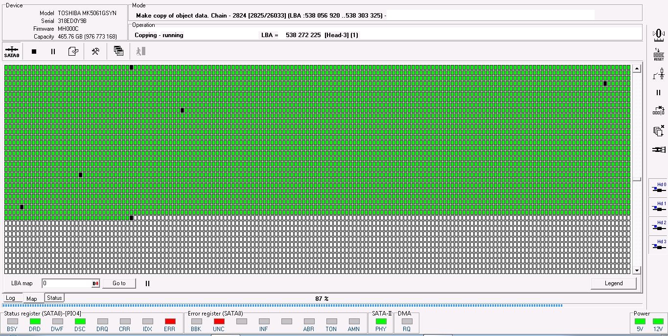

I have Toshiba MK5061GSYN hard disk , I could read all CP normally without any error.

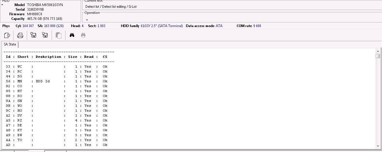

Crucial P list & list are perfectly fine. Only CP BB ,BD & F0 are having errors.

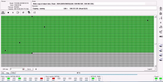

Disk give ID gets initialized normally but gives read errors randomly ( UNC). Reading through utility also does not makes much improvement.
disk is very slow as well.
Is there any co relation between BB, BD & FO CP with this ? There is no importance mark .
Unlike other hard disks there are nodules and little can be done. I think CP's are stored on PCB .
What could be the reason and what should I do.
While selecting reading through utility I have not selected G-list damage option.
Experts in Toshiba pls. help.
Thank you

FWIW, in a thread at the HDD Oracle I examined the firmware resources for an MKxxxxGAS drive and found that there were several checksum algorithms in use. For example, some modules had an 8-bit checksum while others used XOR8 or XOR16. Perhaps that is the reason that your three modules appear to read OK but fail the checksum test?
Also FWIW, the 0xBB CP ("SH") occurs in both the ROM and SA in the MKxxxxGAS while CP 0xBD ("ZF") appears to be resident in ROM.
If you upload your drive's firmware resources (ROM, SA modules, tracks) I could examine those suspect CPs for you.
BTW, ISTM that your G-list has 211 (= 0xD3) defects.

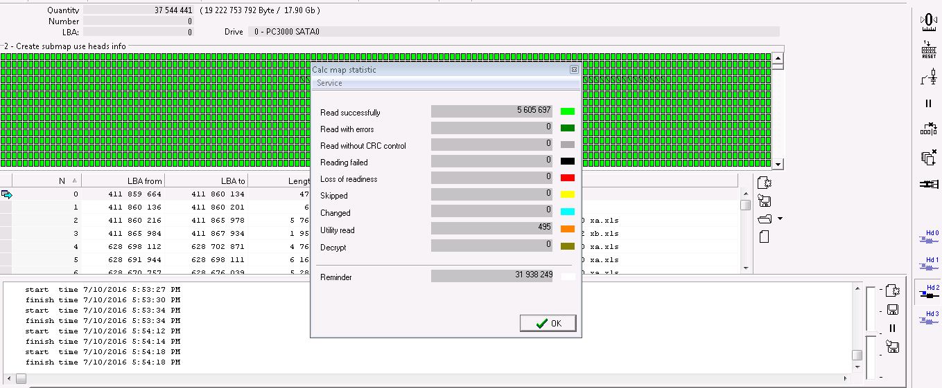

Most likely a heads problem.
 Post subject: Re: Role of BD / BB & F0 modules in Toshiba GSYN hard disk
PostPosted: July 7th, 2016, 7:52
Posts: 1388
Location: isreal
+1, build HM and try to read with each head individual

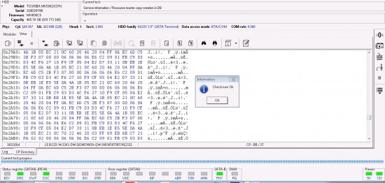

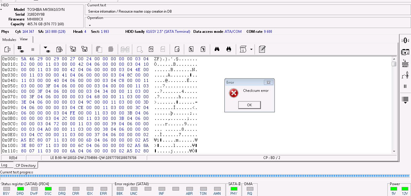

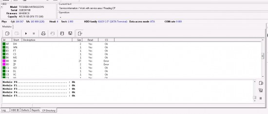

The ROM has a table of CPs at offset 0x247A8. For each CP, this table defines its ID, mnemonic, size in bytes (in ROM and SA), and relative address in ROM.

At the end of the table is a group of 4 modules -- SH, SZ, HP, and ZH. These same 4 modules are found in CP 0xBB in the SA.
Each module has an integrity byte at the end. That is, the integrity bytes for the SH, SZ, HP, and ZH modules are 0xC3, 0x09, 0x01 and 0x90, respectively.
00070620  53 48 8E 7D 89 A2 D0 D0 00 00 00 00 00 00 00 00  SHŽ}‰¢ÐÐ........

I suspect that the ROM table defines the extents of each module as follows:
name  size in ROM/SA
SH    20 / 20
SZ    D0 / D0
HP    10 / 10
ZH    2B10 / 2D00

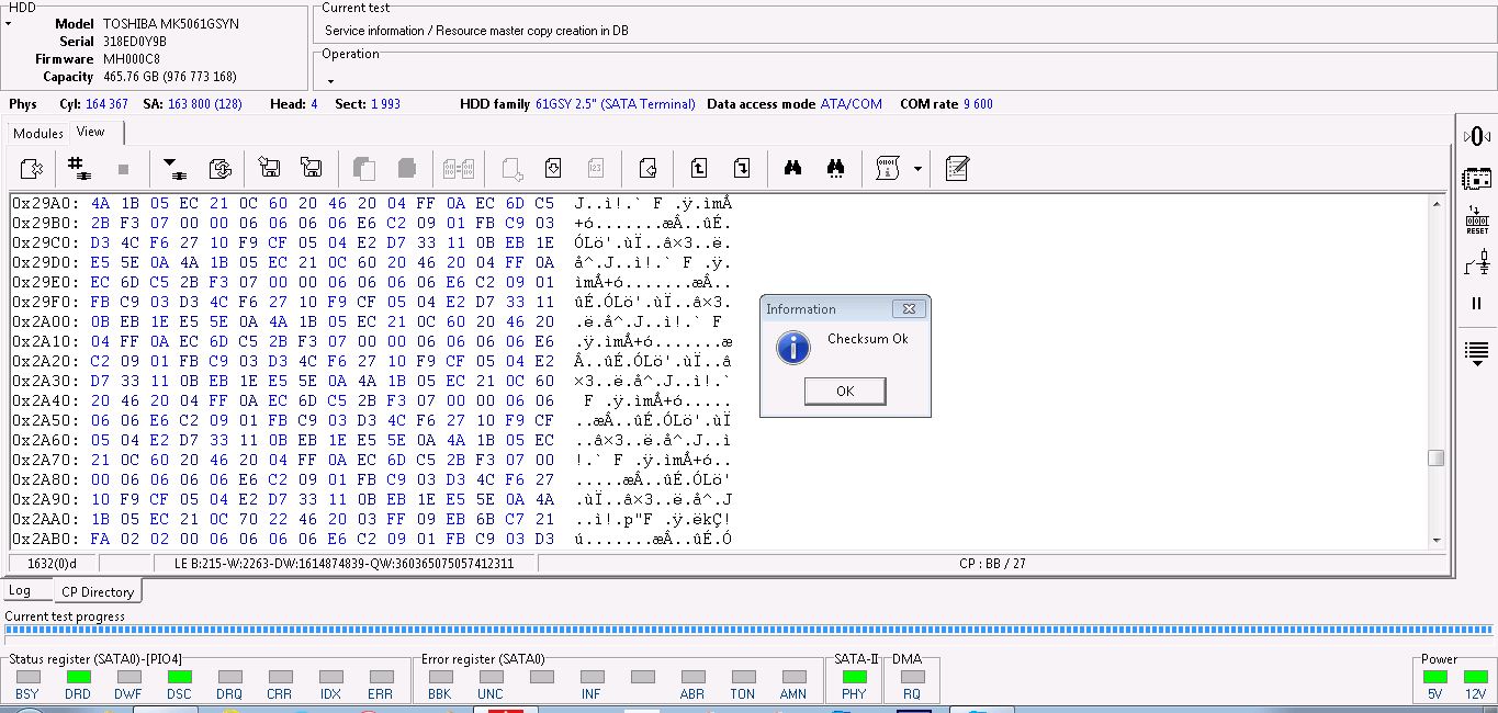

Therefore ISTM that the 0xBB CP should have a size of 0x2E00 bytes. However, the size in the resource dump is 0x3600. That is, the dump contains extra stuff at the end.

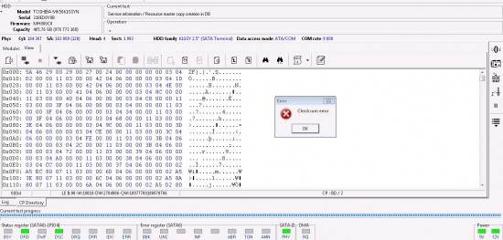

I executed various tests against the CP modules in the dump and found that all modules had XOR8 sums of 0x81 with the exception of the following:
    DD.RPM: XOR16 checksum = 0x0000
    BB.RPM: XOR8 checksum = 0x7B
    BD.RPM: XOR8 checksum = 0x45
    F0.RPM: XOR8 checksum = 0x1A
I also performed simple 8-bit and 16-bit sums, but there was no pattern in the results.
To test my suspicions, I cut module 0xBB to a size of 0x2E00 bytes (as specified in the ROM table) and found that it now tested correctly.
    BB_CUT.BIN: XOR8 checksum = 0x81
So ISTM that this suggests that the tool is incorrectly determining the extents of the 0xBB CP.
If we take a similar approach to CPs 0xBD ("ZF") and 0xF0 ("NT"), we find that their sizes in ROM are 0xD70 and 0xFD0, respectively. However, their sizes in the resource dumps are 0x400 and 0x200. This time it appears that the tool has underestimated the sizes of these CPs.
Here is CP 0xF0:
00000000  4E 54 00 00 00 00 00 00 00 00 00 00 00 00 00 00  NT..............
00000010  00 00 00 00 00 00 00 00 00 00 00 00 00 00 00 00
000001F0  00 00 00 00 00 00 00 00 00 00 00 00 00 00 00 00
Note the absence of any integrity byte.
In short it seems that there is a bug in the tool, or perhaps some corruption in the directory (?) which the tool is using to locate the modules.

Posts: 198
Location: Universe
Diagnostics and checking of fzabkar was 100 % right.
I have selected ATA+COM as reading mode and copied all resouces again. This time reading cp tool more time. ( earlier it was quick)
I have checked checksum of all 3 error giving cp's. While one of the CP is having errors in checksum , other 2 are having good checksum.
I have taken backup of all original CPS .After that I opened these 3 faulty cps and recalculated checksum and saved them on hard disk.
But this has not improved sector access which is still slow with lots of errors.
what should I do now.
I am attaching rom and cp's read by ata+com mode.
toshiba new.rar [1.1 MiB]
Downloaded 1196 times

Hi Team
Update to case --- I have tried to write CP's from backup. I got error while writing BD cp.
continued to image - still drive is slow with errors.
As fzabkar has traced pc3000 udma is unable to read full rom and cp's .I don't have any other tool.
I am confused what to do now.

PostPosted: July 10th, 2016, 9:16
Posts: 198
Location: Universe
Hi Sean labtech and fzabkar
Sorry I missed out head test part. Unfortunately utility is not having option to check heads similar to WD and Seagate,
Yes except these 3 cp's resy of the cps' are fine including G list and P list.
only way to head test is through DE. So far I have been able to image approximately 11Gb data from one partition. However it is full of defects. Is there any alternate technique to check heads ?
It seems I can read using all 4 heads so we have following 2 possibilities -
1) All 4 heads are weak & are causing bad sectors.
2) Heads are fine & its corrupted CP's are to blame.
Wishing you a nice weekend.
