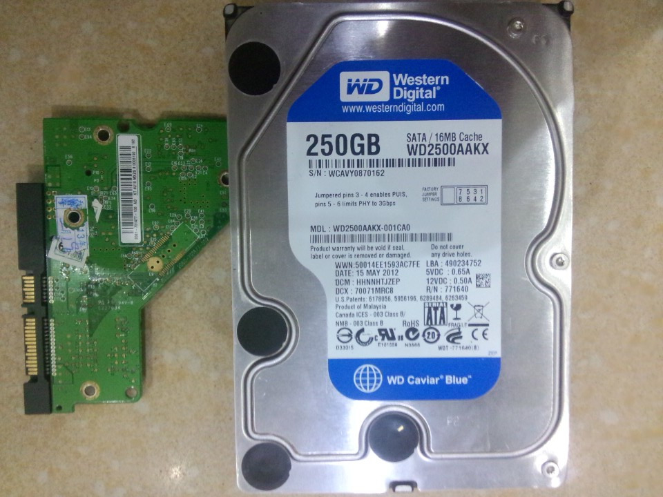

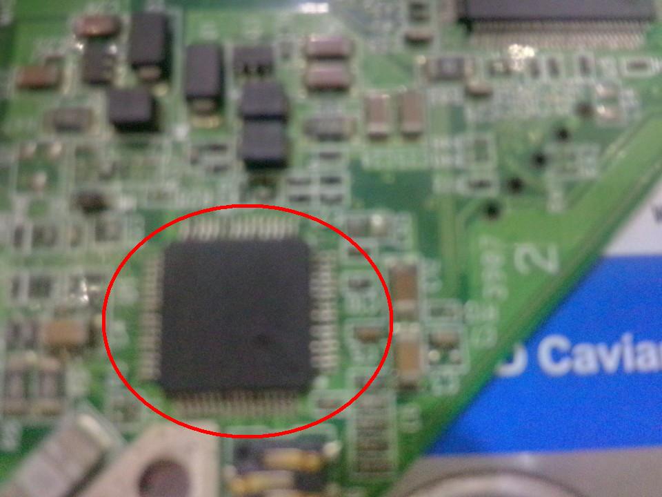

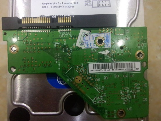

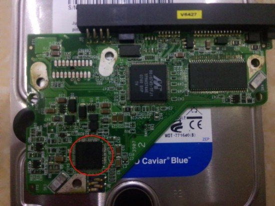

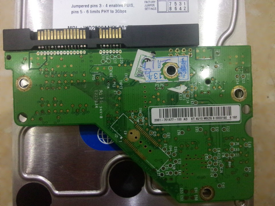

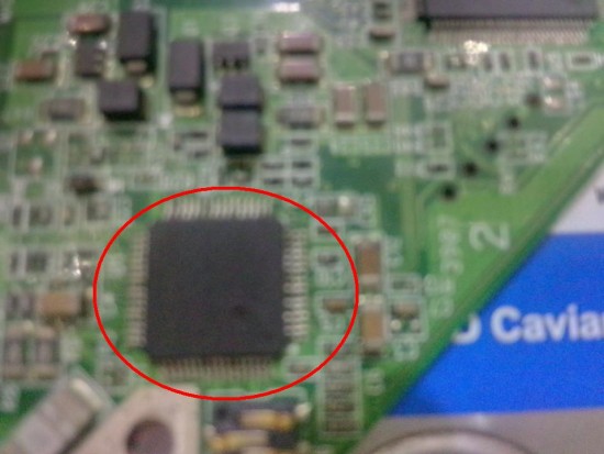

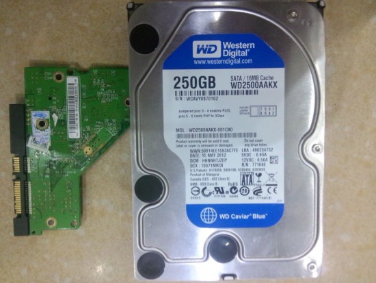

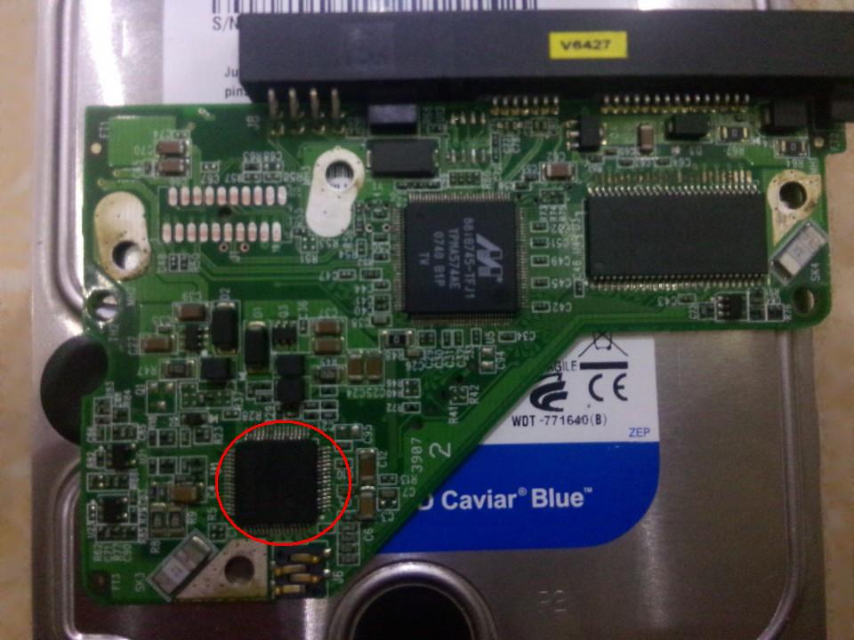

I have received a 250Gb WD hard drives
Fire was broken ic controls Motor
I replaced Circuit PCB 2060-771640-003 Rev A
I want to know this model is compatible with PCB original hard drive
2060-701477-002 Rev A
Help me to recover data
Thank you

Hey Friend,
This pcb is not compatybile with this drive.
Only PCB: 2060-771640-003 Rev A.

pikus_09 wrote:
Hey Friend,
I can replace the IC from pcb motor controller 2060-771640-003 Rev A for 2060-701477-002 Rev A be not
help me
thank you

pikus_09 wrote:
Hey Friend,
I find the right model 2060-701477-002 PCB Rev A
Replacing the hard drive but not received
help me
thank you
I am from cuudulieuocung.org and I am currently banned from this forum for creating multiple accounts to promote my crappy website.
 Post subject: Re: Fix PCB IC motor 250Gb WD fire error
PostPosted: June 30th, 2016, 5:04
Posts: 430
Change ROM chip. U12.
But If your drive is WD2500AAKX, your PCB 701477 is not compatybile.
Only 771640.
PostPosted: June 30th, 2016, 7:36
Posts: 849
Location: Pakistan
Only 771640.
this pcb does not have an external ROM chip (U12).
Data Recovery Pakistan
PostPosted: June 30th, 2016, 11:45
Posts: 430
aaa, ok thanks.
