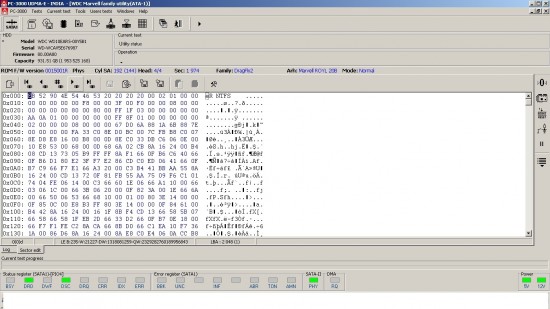

Hello, ,
WDC WD10EARS-00Y5B1-80.00A80
Cap : 1 TB
No Data Access , HDD detected DRD DSC.
unable to read any sectors .
Some Modules unable to Read from SA. Attached Screen Shot.

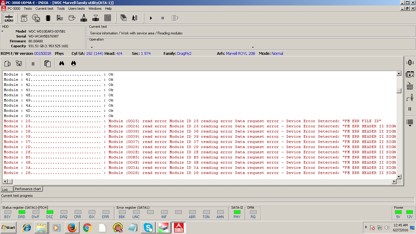

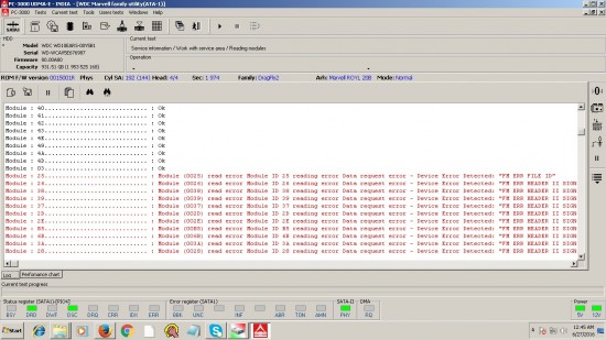

Module : 42............................. : Ok
Module : 43............................. : Ok
Module : 4E............................. : Ok
Module : 49............................. : Ok
Module : 4A............................. : Ok
Module : 4D............................. : Ok
Module : 03............................. : Ok
Module : 25............................. : Module (0025) read error Module ID 25 reading error Data request error - Device Error Detected: "FM ERR FILE ID"
Module : 26............................. : Module (0026) read error Module ID 26 reading error Data request error - Device Error Detected: "FM ERR HEADER II SIGNATURE INVALID"
Module : 38............................. : Module (0038) read error Module ID 38 reading error Data request error - Device Error Detected: "FM ERR HEADER II SIGNATURE INVALID"
Module : 39............................. : Module (0039) read error Module ID 39 reading error Data request error - Device Error Detected: "FM ERR HEADER II SIGNATURE INVALID"
Module : 37............................. : Module (0037) read error Module ID 37 reading error Data request error - Device Error Detected: "FM ERR HEADER II SIGNATURE INVALID"
Module : 2D............................. : Module (002D) read error Module ID 2D reading error Data request error - Device Error Detected: "FM ERR HEADER II SIGNATURE INVALID"
Module : 2E............................. : Module (002E) read error Module ID 2E reading error Data request error - Device Error Detected: "FM ERR HEADER II SIGNATURE INVALID"
Module : B5............................. : Module (00B5) read error Module ID B5 reading error Data request error - Device Error Detected: "FM ERR HEADER II SIGNATURE INVALID"
Module : 6B............................. : Module (006B) read error Module ID 6B reading error Data request error - Device Error Detected: "FM ERR HEADER II SIGNATURE INVALID"
Module : 3A............................. : Module (003A) read error Module ID 3A reading error Data request error - Device Error Detected: "FM ERR HEADER II SIGNATURE INVALID"
Module : 28............................. : Module (0028) read error Module ID 28 reading error Data request error - Device Error Detected: "FM ERR HEADER II SIGNATURE INVALID"
Module : 3B............................. : Module (003B) read error Module ID 3B reading error Data request error - Device Error Detected: "FM ERR HEADER II SIGNATURE INVALID"
Module : 3C............................. : Module (003C) read error Module ID 3C reading error Data request error - Device Error Detected: "FM ERR HEADER II SIGNATURE INVALID"
Module : 3D............................. : Module (003D) read error Module ID 3D reading error Data request error - Device Error Detected: "FM ERR HEADER II SIGNATURE INVALID"
Module : 3E............................. : Module (003E) read error Module ID 3E reading error Data request error - Device Error Detected: "FM ERR HEADER II SIGNATURE INVALID"
Module : 3F............................. : Module (003F) read error Module ID 3F reading error Data request error - Device Error Detected: "FM ERR HEADER II SIGNATURE INVALID"
Module : 6F............................. : Checksum error
Module : 116............................ : Module (0116) read error Module ID 116 reading error Data request error - Device Error Detected: "FM ERR HEADER II SIGNATURE INVALID"
Module : 118............................ : Module (0118) read error Module ID 118 reading error Data request error - Device Error Detected: "FM ERR HEADER II SIGNATURE INVALID"
Module : 119............................ : Module (0119) read error Module ID 119 reading error Data request error - Device Error Detected: "FM ERR HEADER II SIGNATURE INVALID"
Module : 68............................. : Module (0068) read error Module ID 68 reading error Data request error - Device Error Detected: "FM ERR HEADER II SIGNATURE INVALID"
Module : 69............................. : Module (0069) read error Module ID 69 reading error Data request error - Device Error Detected: "FM ERR HEADER II SIGNATURE INVALID"
Module : 6A............................. : Module (006A) read error Module ID 6A reading error Data request error - Device Error Detected: "FM ERR HEADER II SIGNATURE INVALID"
Module : 120............................ : Module (0120) read error Module ID 120 reading error Data request error - Device Error Detected: "FM ERR HEADER II SIGNATURE INVALID"
Module : 04............................. : Module (0004) read error Module ID 04 reading error Data request error - Device Error Detected: "FM ERR HEADER II SIGNATURE INVALID"
Module : 05............................. : Module (0005) read error Module ID 05 reading error Data request error - Device Error Detected: "FM ERR HEADER II SIGNATURE INVALID"
Module : 3700........................... : Ok
Module : DE............................. : Ok
Should overwrite modules for Donar HDD ?

Both copies ?
Most of the above mod's are not required to access user area or can be taken from the same model/FW ver. (I.e. not unique to the HDD), Except for 25 & 38 in case of encryption.
But there is missing from the list you have provided some other unique mod's, why are they not on the list ?

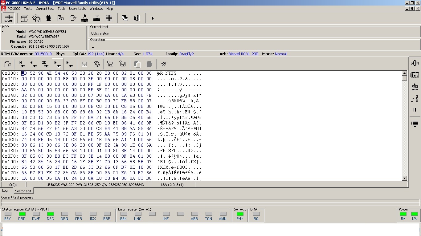

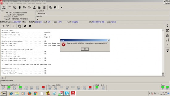

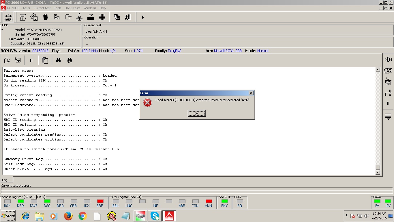

All Modules Re-written from Exact Donar drive .
Now After SA Structure Test , all modules are ok .
But Still Can't Access Data , Any Sector Reading Gives Error - Address mark not Found.
How to Resolve ? Data is imp for client.
