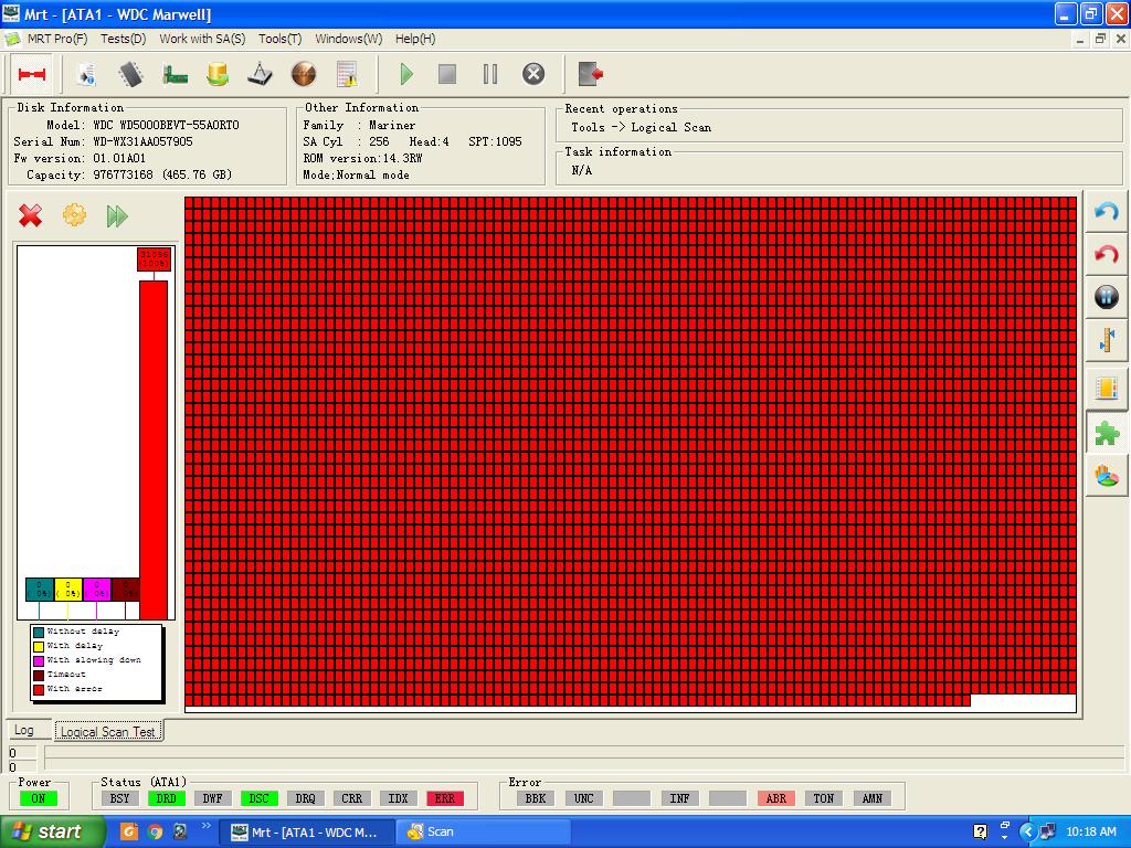

I'm working on a 500Gb hard drive wd
I need to recover data
Full hard disk bad press Red
Looking forward to your help
I sent the attached picture
Help me
thanks

 Post subject: Re: Bad hard drive to fix all wd 500Gb
PostPosted: June 30th, 2016, 1:43
Posts: 17343
Password?
Any bad SA modules?
PostPosted: June 30th, 2016, 5:08
Posts: 430
This is a fake fake drive, Model W15000 is not
available, and translator not initialize propertly.
You mus SA backup, and
several modules must be edit, 02, 31, 32,
available
Why do you think its fake ? It a WD5000BEVT-55A0RT0
PostPosted: June 30th, 2016, 11:12
Posts: 430
I see there W15000BEVT,
PostPosted: June 30th, 2016, 11:14
I see WD5000BEVT-55A0RT0
PostPosted: June 30th, 2016, 13:26
Posts: 1388
Location: isreal
Click on the pic.
PostPosted: June 30th, 2016, 18:28
Posts: 430
Ok, I see WD5000BEVT, sorry for the confusion.
Autor have problem in translater, or one of head is bad and translater not propertly initialize.
I have tried to regenarate the translator from two ways, and I have do the SA module search and I can not find anything wrong in module 02

Hi.
Weather the P List G List and Translator are Ok, or any issues in these three modules?
Weather the drive has issues with Read redo block.
Check for SPT value and microcode of the hard drive shows exact same as required or not.
