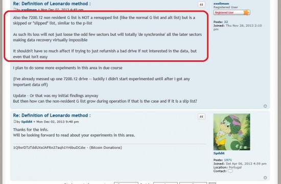

 Post subject: Re: Seagate F3 NRG list Dangers
PostPosted: July 1st, 2016, 1:41
Posts: 198
Location: Universe

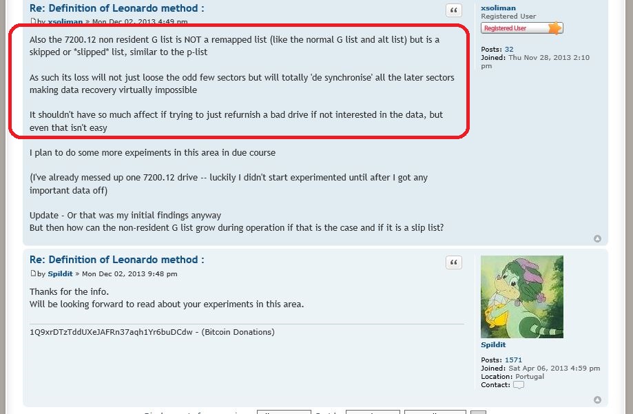

Hi
Thanks all for valuable contribution.
Jermy : --- I did not understood what you mean.
Here is particular thread.- http://forum.acelaboratory.com/viewtopi ... ist#p28275
I am also attaching snapshot of the comments.
PostPosted: July 1st, 2016, 3:01
Posts: 3550
m0,6,3 does not affect NRG entries.

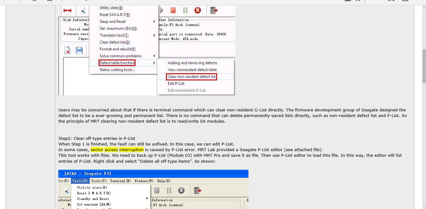

PostPosted: July 2nd, 2016, 1:21

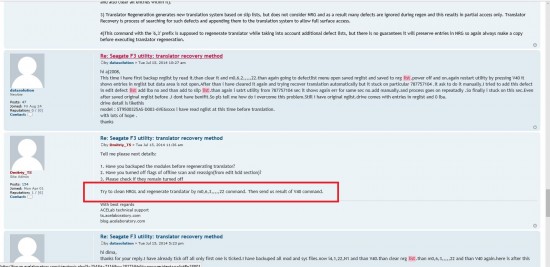

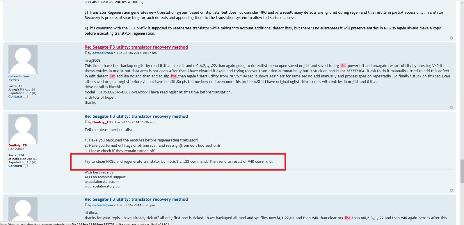

Posts: 198
Location: Universe
Here I have found warning on direct clearing NRG list
PostPosted: July 2nd, 2016, 1:42
Joined: June 5th, 2006, 1:09
Posts: 93
Location: INDIA

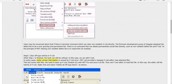

MRT lab has added P list into consideration in this issues ( Sector access interruption).
here is post --
viewtopic.php?f=28&t=31342&hilit=sector+access+interruption

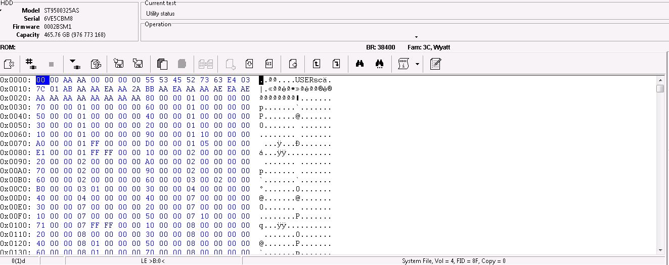

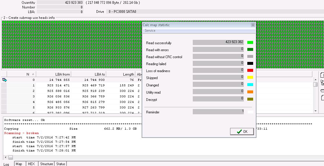

PostPosted: July 2nd, 2016, 10:07
Posts: 198
Location: Universe

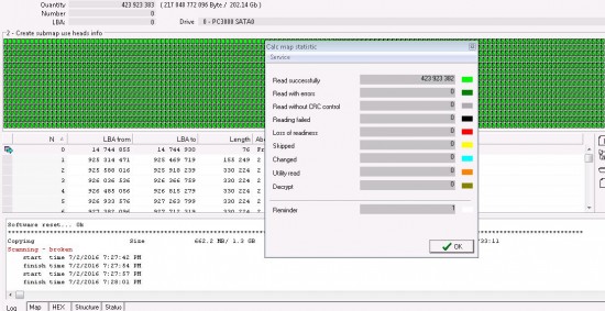

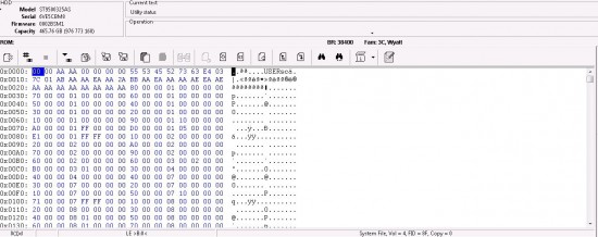

Thanks to all particularly hpwlab , drive has become obedient. Earlier I was able to clear flags from 08F file.
I have beena ble to image required data sectors using 3 heads.
Only head 0 is remained .It is reading very slow. What could be the reason for this behaviour ?
Now Terminal output has also changed -
what should I do to speed up reading by Head 0
P) SATA Reset
RW: Error processing Performance Parameter File: 203A
Set Transfer Mode selected
Ultra DMA selected
Starting LBA of RW Request=0475ABC7 Length=FFFFFFFF
PostPosted: July 3rd, 2016, 22:57
Posts: 347
Location: india
I had already erased NRG list many times (Whenever i get Partial Access Problem), A clean sysfile 35 (without NRG entries) from same model with same size (firm version is not problem) and sysfile 28 uploaded to HDD both copies.
Then Power Reset then used m0,6,3,,,,,22 then clear SMART before format cleared G-List(i4,1,22) then applied pending fix
First time hdd took some time to detect (Less than min) then hdd imaged
I had succeeded this only on ST3500418AS and ST500DM002.
This process may be wrong but in my all cases for these two models it worked
Note: Always backup before apply anything
