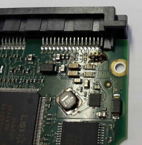

Hi Guru's,
Can someone help steer me in the right direction to identify the below chips circled in red. The image below is not my board but identical, plus the ones on my board are fried beyond recognition.
Regards,
Sharne

Those appear to be inductors. You will find that your 12V TVS diode is shorted.
Remove the shorted diode and run a jumper wire from the +12V SATA pins to the cathode pad of the diode (the striped end, marked with "v" on PCB).
Something like this ...
http://www.users.on.net/~fzabkar/HDD/ST ... S_wire.jpg (different PCB, same idea)
See the TVS Diode FAQ (heed the warnings):
http://www.hddoracle.com/viewtopic.php?f=100&t=86&p=102
If you upload a photo (or scan) of your own PCB, I'll show you what to do.

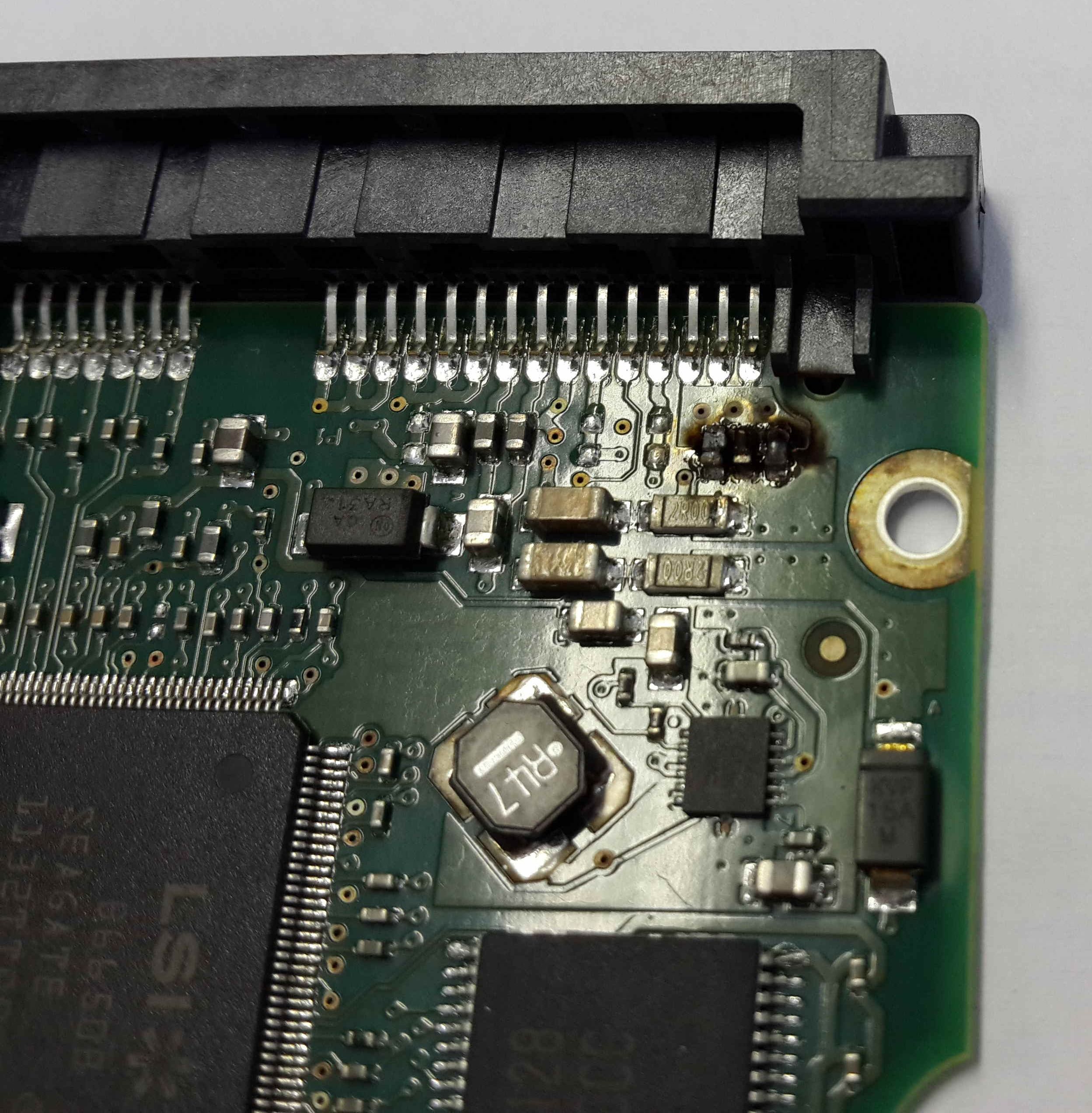

Hi fzabkar,
Thanks for the assist. Below is a image of the board. I would prefer to identify and replace the parts that have fried.
Regards,
S

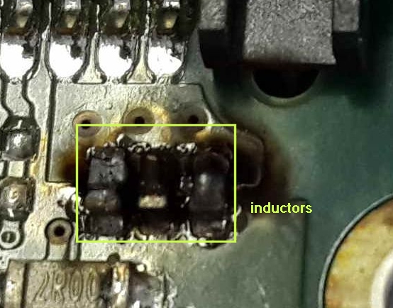

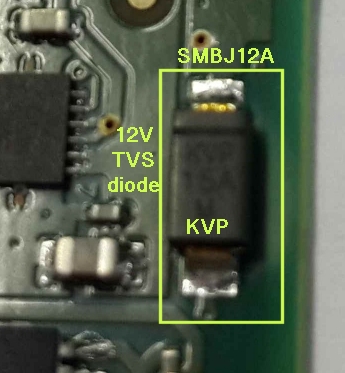

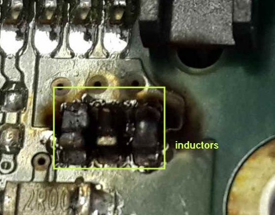

The 12V TVS diode can be replaced with an SMBJ12A.
The values of the chip inductors are unknown to me.
TPSMB13A, General Semiconductor (Vishay), 12V TVS diode, unidirectional, marking KVP, standoff 11.1V, breakdown 12.4V - 13.7V:
http://www.vishay.com/docs/88406/tpsmb.pdf
http://www.datasheetcatalog.org/datashe ... Xuytsz.pdf

@Sharne, FYI newer Seagate PCBs use zero-ohm resistors in place of inductors. This would suggest that Seagate has dispensed with the need for low pass filters on the supply input.
http://www.hddoracle.com/viewtopic.php? ... 1615#p8876
