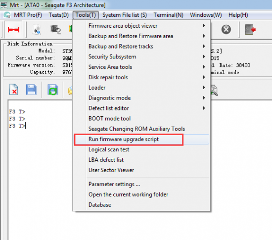

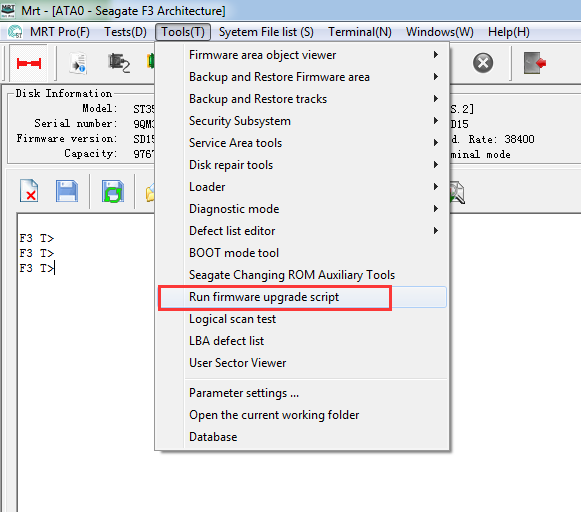

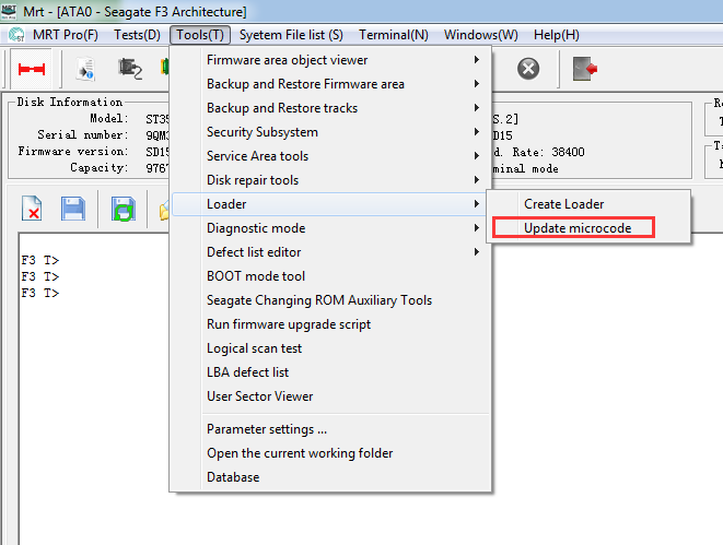

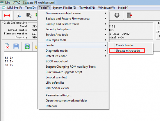

Hello, if the loader is created by a third-party tool, and in MRT Seagate utility, you can try to use those methods below:
The first one is to use the function of " Run Firmware Upgrade Script" in "Tools" function;
Then second way is to use the function of "Update microcode" in "Tools" function (Tools>>Loader>>Update microcode);
But I suggest you to use the first one, because it can support the universal loader form.

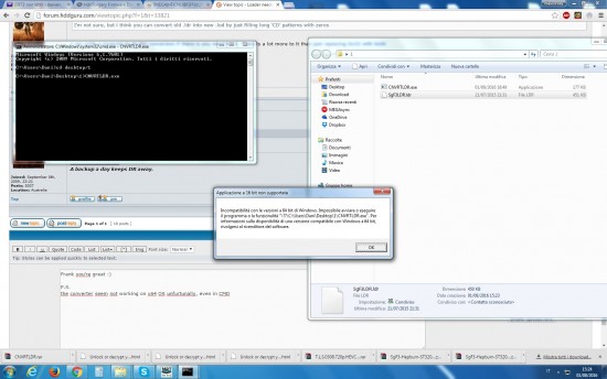

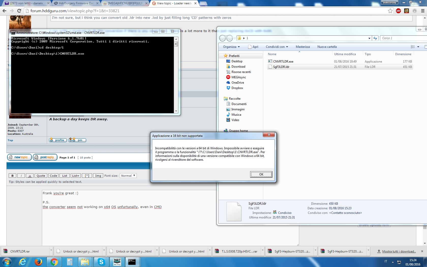

P.S.
the converter seem not working on x64 OS unfortunately, even in CMD mode.
My firmware database:
 Post subject: Re: Loader needed
PostPosted: August 1st, 2016, 14:44
Posts: 17232
Sorry, I have no way of testing that.
This is what you should see:
C:\>cnvrtldr
Conversion format not specified
Usage:  CNVRTLDR [enc2dec / dec2enc] infil=["input filename"] outfil=["output filename"]
Examples:
    CNVRTLDR enc2dec infil=SgF3LDR.ldr outfil=SgF3LDR.lod
    CNVRTLDR dec2enc infil=SgF3LDR.lod outfil=SgF3LDR.ldr
I'm not much of a programmer, so I write programs for the command line. This means that I don't need to deal with a GUI, nor do I need to be concerned with all the different flavours of Windows. Or so I thought ...
It should be easy to write an equivalent conversion routine in Python. Maybe that would be more universal. Basically all that you need to do is to read bytes from the input file, look up the converted bytes in a byte map, and then write them to the output file.
