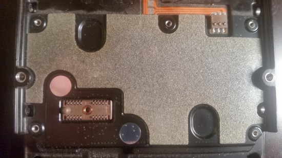

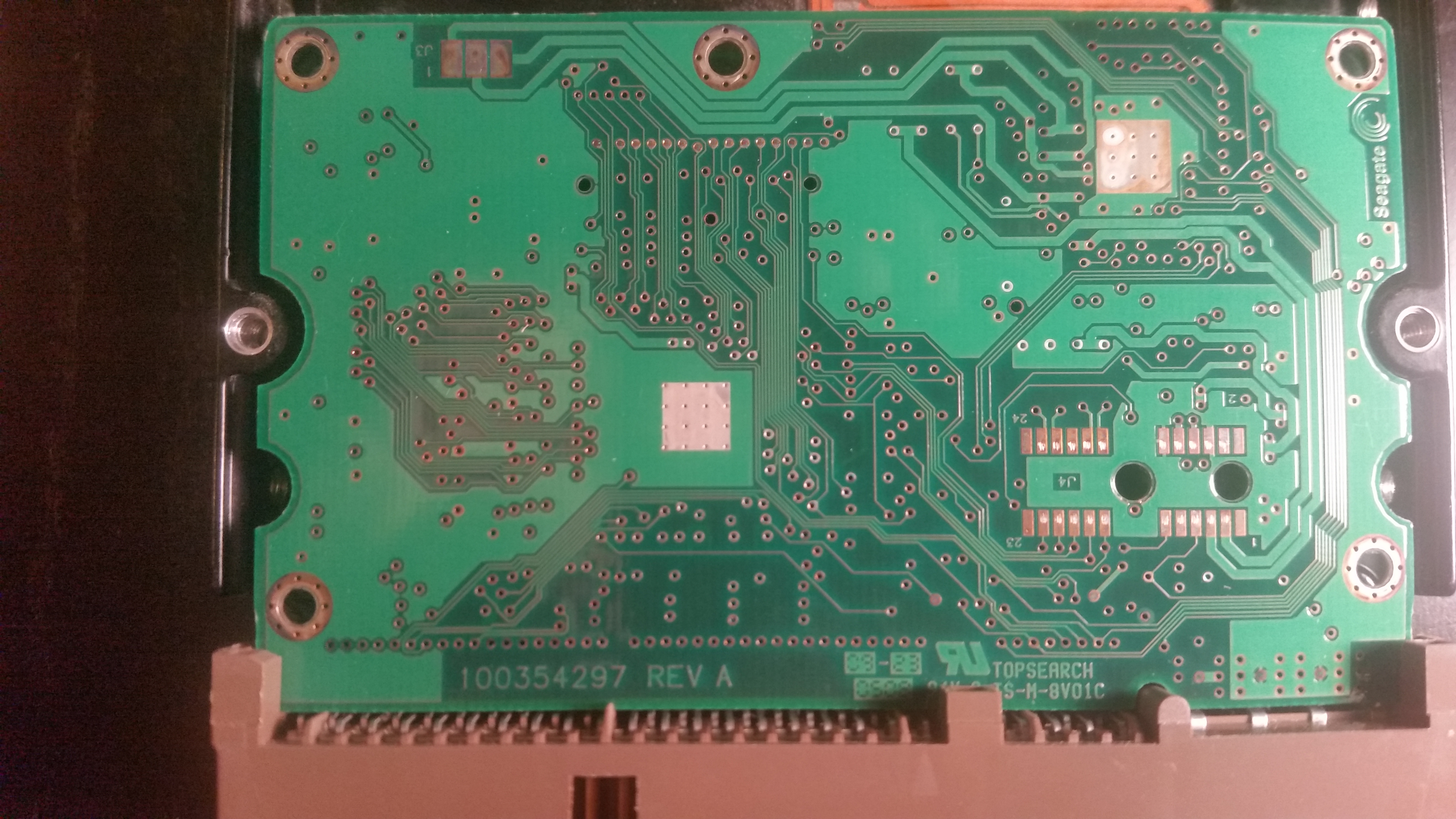

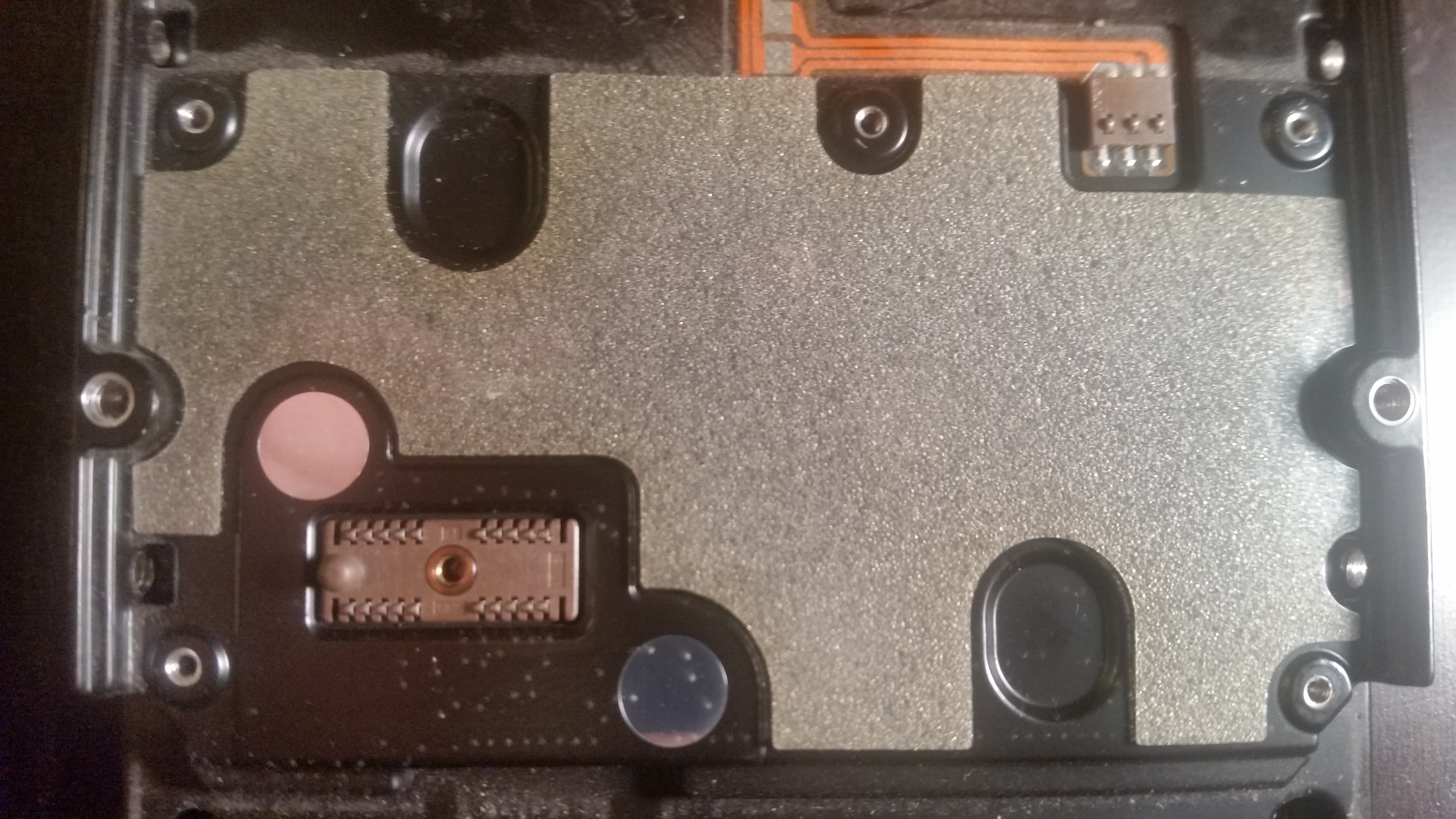

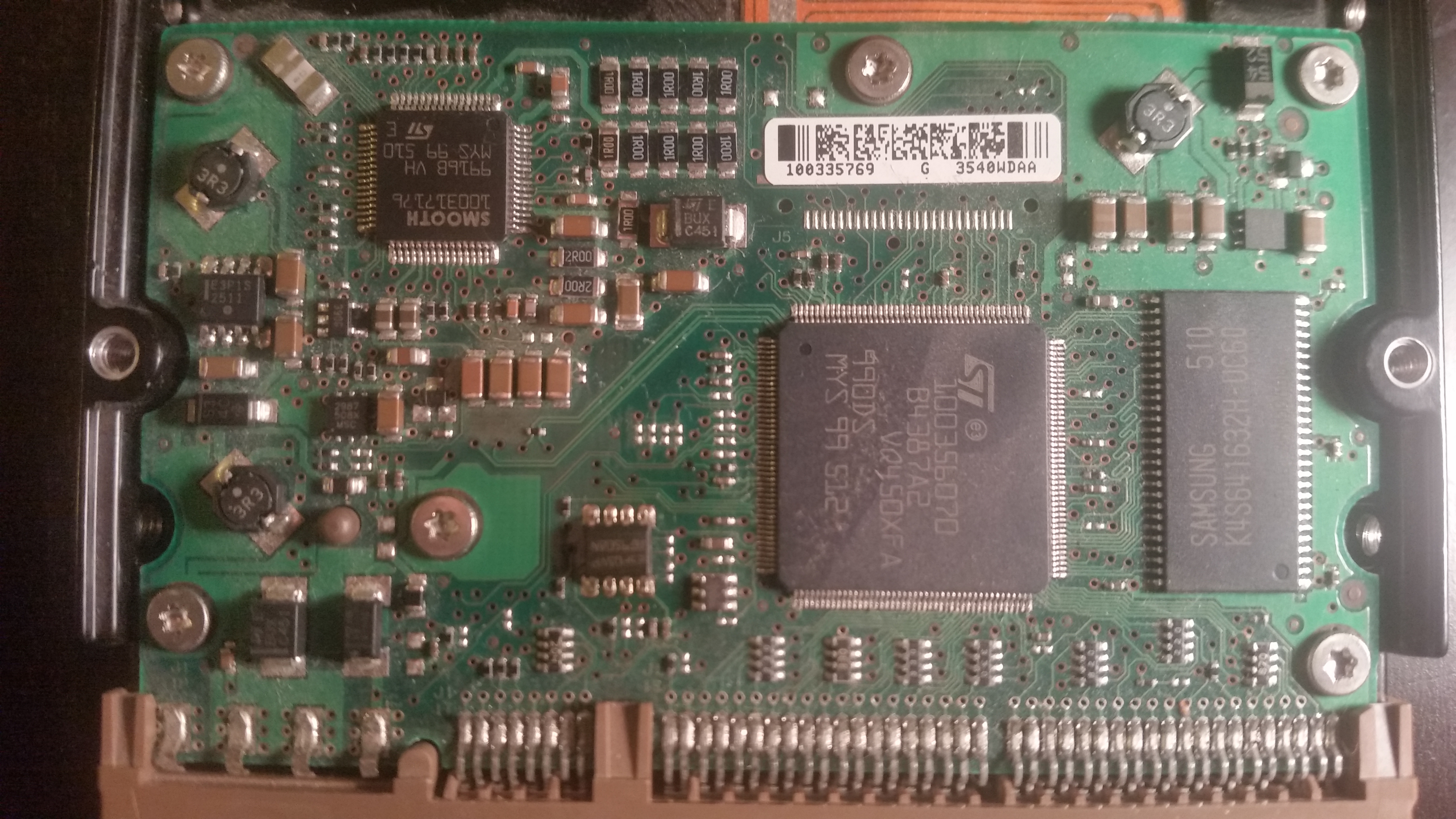

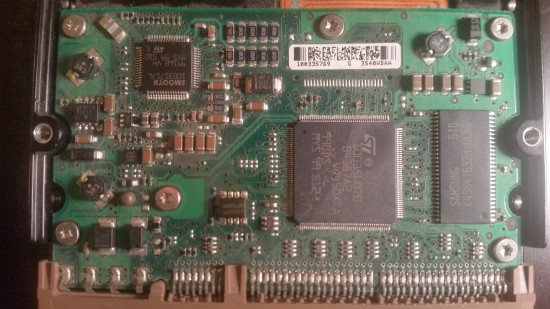

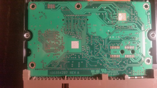

Here are high-res photos of front and back of PCB and the HDA and motor connectors of the donor drive.

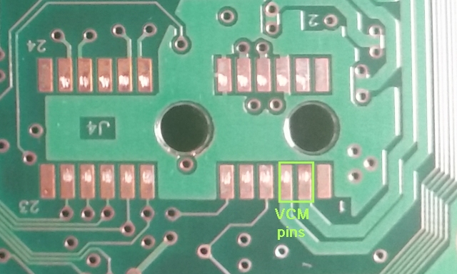

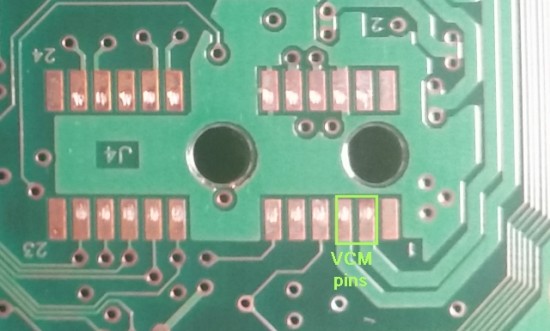

If you place insulation tape over the indicated pins, that should prevent the voice coil from moving.

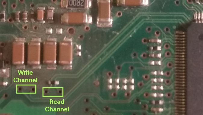

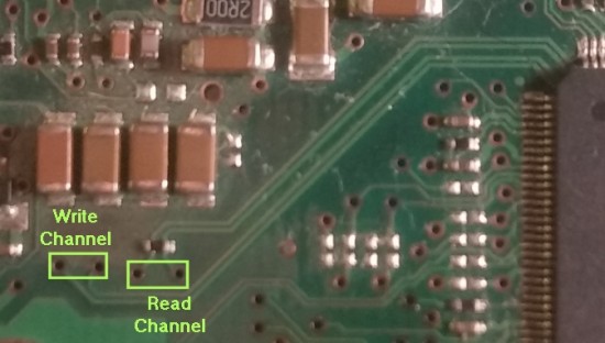

Another thing you could try would be to short the read channel test points together with tweezers. This would prevent the servo from working, which means that you should hear the heads click as they attempt to locate the "discware" area (aka System Area, SA).
