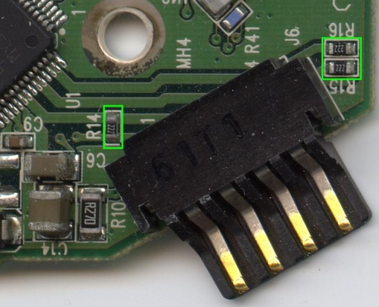

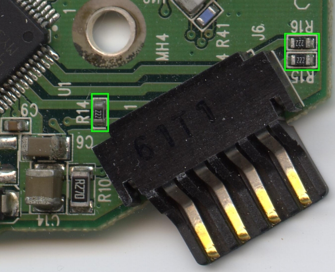

The original PCB tests bad. There should not be a "short" between any phase and ground.
For example, here is the relevant area of a WD PCB:
There are 2.2K resistors (R14/R15/R16) between each of the 3 phases and the common terminal. I measure 2.2Kohm phase-to-common and 4.4Kohm phase-to-phase. This means that the resistance looking into the SMOOTH chip is essentially infinite.
