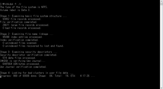

I just re-writing up new thread with change question as more simply, because i could not get clear answer of this issue for months.
This is the screen just before exiting chkdsk. There were bad sectors on the disk. In that case some files, I heard, could be deleted when chkdsk is executed with /r switch, so I turned it off in haste. As you see, chkdsk didn't leave any messages that it deleted or modifed something. Still could there be any files already deleted? When I checked it out after the terminaton no found.xxx folder or chk file was found.
It is said that there could be losses in the data recorded on the sectors marked as bad in the recovery process using /r switch. What I'd like to know is if there could be any possibility that when the job occurred it proceeded without leaving any job history on the prompt screen.

1. Files are not deleted for just having bad sectors in them.
2. The content of the file may be lost/damaged when there is a bad sector. The bad sectors are just that - bad, cannot be read. /R switch just discovers the fact the sector is bad.
3. The copy of CHKDSK progress/job report can normally be found in the event log (System I recall).

Unfortunately log was not created in this time because of abort chkdsk by myself. after abort chkdsk, i moved all data to new disk by TeraCopy and some folder was in not able to copy so i deleted and replaced from back up data. also according to screenshot, chkdsk was checking 869 clusters and did not find any errors yet (judging by prompt, any error messages aren't leaved on prompt), so i assume chkdsk did not touch any data/sectors yet, and i canceled before something can happen with data/sectors by chkdsk. how do you think about this conclusion?

If you cancelled at the point shown on the screenshot, nothing happened (yet). I recall if there are bad sectors, this is indicated immediately (can't recall exact wording though).
