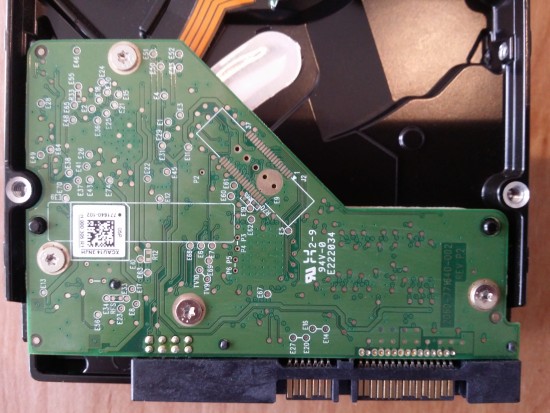

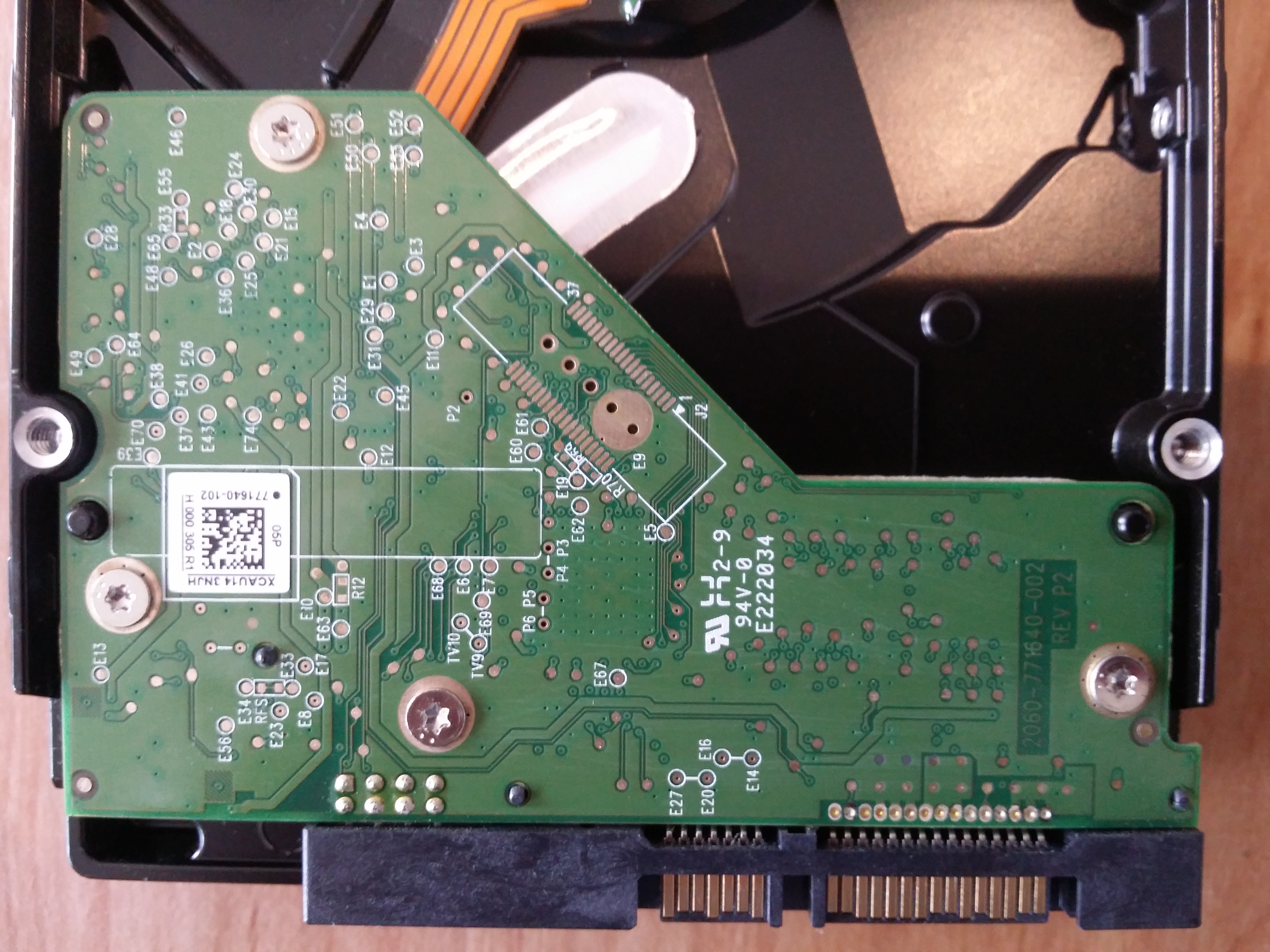

Please show as pcb photo. Any sound from drive if you will try to hear very close to drive?

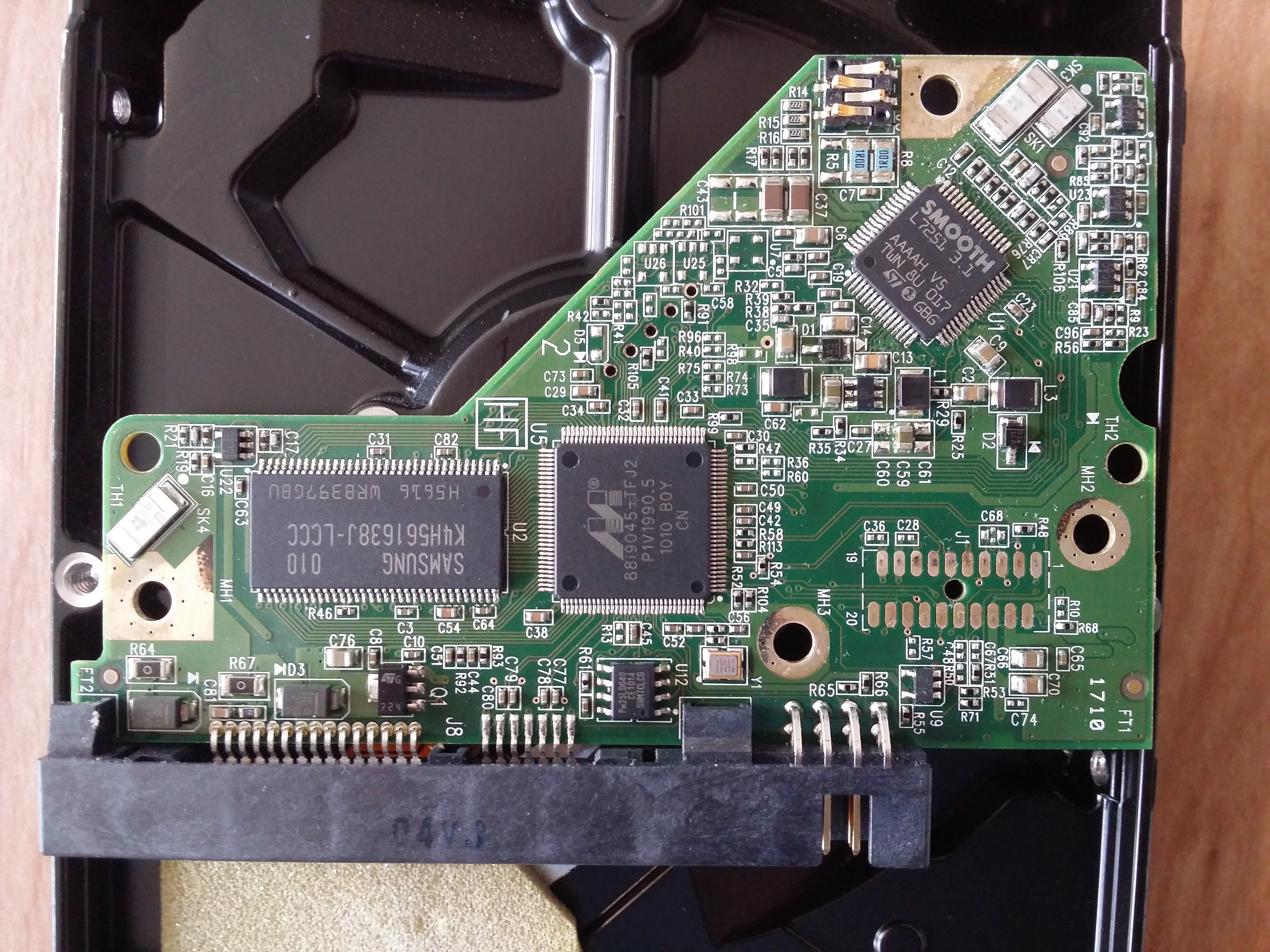

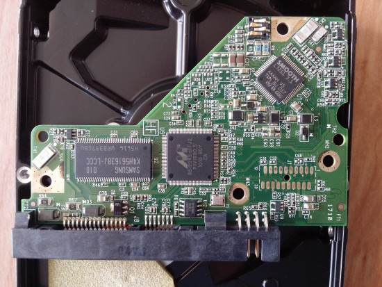

I hear no sound at all from the drive when giving it power, and my hearing is pretty good. I can hear my LCD monitor and occasionally the CPU in a laptop.
Photos attached.

First thing to do is check the TVS diodes and "zero ohm resistors" at the bottom left of your last picture.
Easiest way to test is to get a meter with a continuity test (beeps when you touch the probes together).
The TVS diodes (the larger two black components with a small white stripe at one end) should NOT make the meter beep, but the resistors (smaller black components with a "0" on them) SHOULD make a beep.

C81 and D3 are open across, R64 and R67 make a beep, so I guess that checks out.

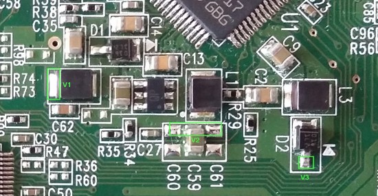

 Post subject: Re: WD doesn't spin/power on
PostPosted: August 10th, 2016, 18:19
Posts: 17230

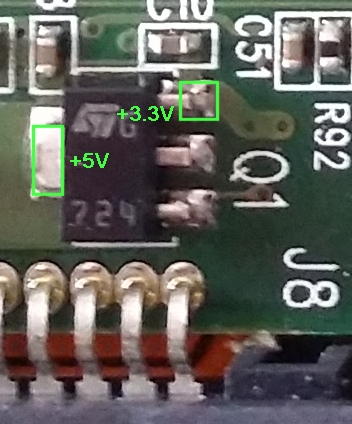

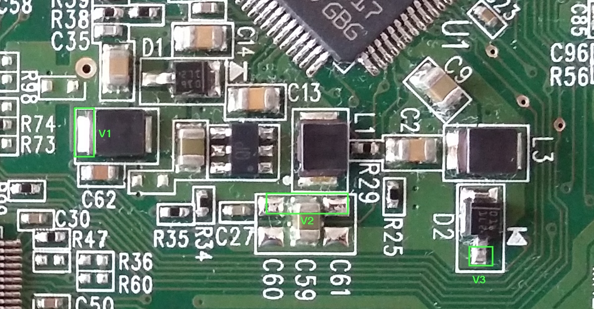

Measure the voltages at 3V3, V1, V2, V3. Be careful not to slip with your probes, as catastrophic damage may result.
If you replace the PCB, you must transfer the chip at U12 from patient to donor. A vendor such as hdd-parts.com provides a PCB plus firmware transfer for US$50.

Results of votage testing:
5V: Good
3.3V: Good
V1: 2.55V
V2: 1.1V
V3: 0
I'm guessing the V3 value of 0 at diode D2 is not what we hoped.
PostPosted: August 12th, 2016, 17:12
Posts: 17230
AIUI, all the readings are as expected.
V3 is the negative supply for the preamp inside the HDA. It is -5V when the drive is spinning, but it needs to be switched on by the Marvell MCU (via the motor controller). You may find that the voltage rises to -5V immediately after power-on, but settles at 0V when the Marvell MCU fails to detect the preamp. If this is what is happening, then this would suggest that the MCU is not braindead and that the motor controller is communicating with the MCU.
