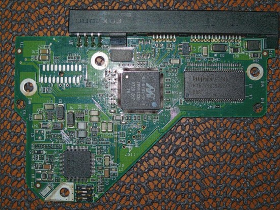

AS requested here is the "bad" PCB photo ...
Apparently there is no visible damage so what could be wrong ?
File comment: Bad PCB

ROM on this PCB is embended
measure diodes and 0 ohm resistor

It seems that the "D3" and "D4" diodes have different from 0.0 Ohm values ...
Were all of them supposed to have 0.0 Ohm ?
Any ideas are appreciated ...
 Post subject: Re: WD3200AAKS Dead
PostPosted: August 26th, 2016, 14:47
Easiest way is to select continuity mode on your MM, one that "beeps" on continuity.
R64 and R67 should beep, D3 and D4 should NOT beep.
