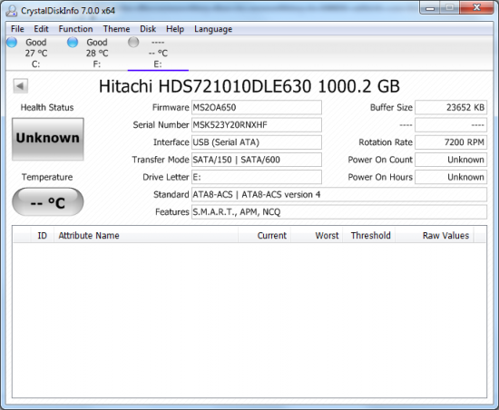

Thanks for the replies.

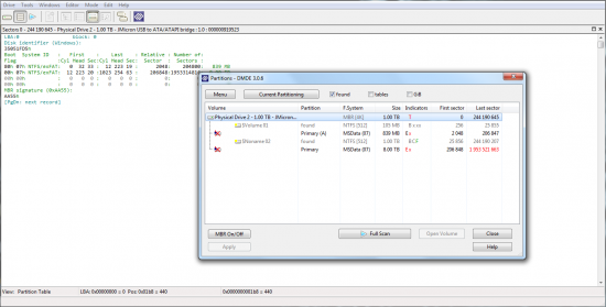

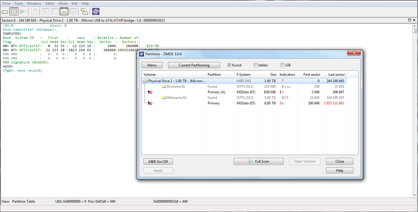

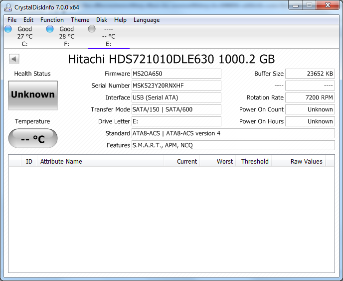

I've attached the CrystalDisk and DMDE partition screenshots as requested (hope this is what you were after).

@Smith, your USB dock is part of the problem. Its firmware is configured for a sector size of 4096 bytes wherease your drive's file system was created in a 512-byte environment. This means that sector 0 (the MBR and partition table) is still in the correct place, but every other sector is out by a factor of 8. Windows thinks the drive is unformatted because it is looking for the boot sector in the wrong place. You need to connect the drive to a SATA port.
The other problem with the dock is that it uses a JMicron bridge IC. It appears that CrystalDiskInfo is unable to retrieve SMART from a drive that is behind a JMicron bridge. Once again, this problem will go away when you connect the drive to a SATA port.

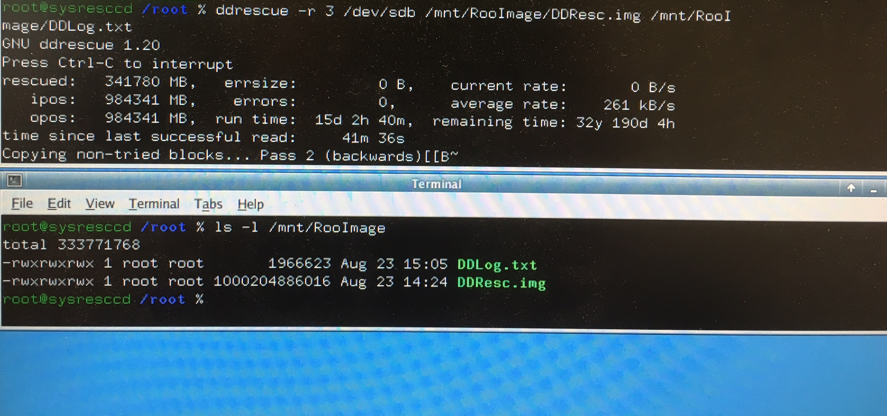

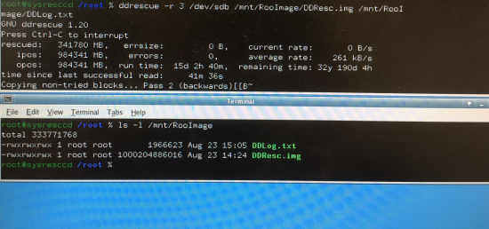

So just a little update on this.
DDRescue has now been running for just over 15 days and only has 32 years and 190 days left until completion :lol: . This number jumps around hugely of course but it's clearly going to run for months if I let it. What does concern me is the results so far after pass 1.

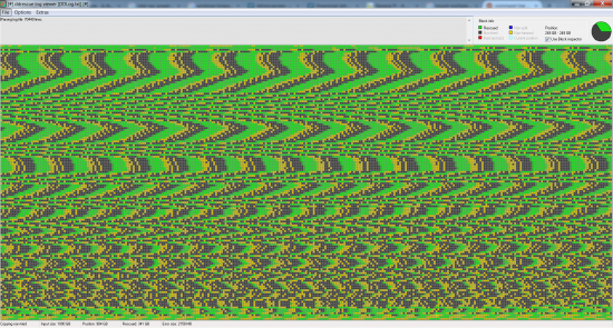

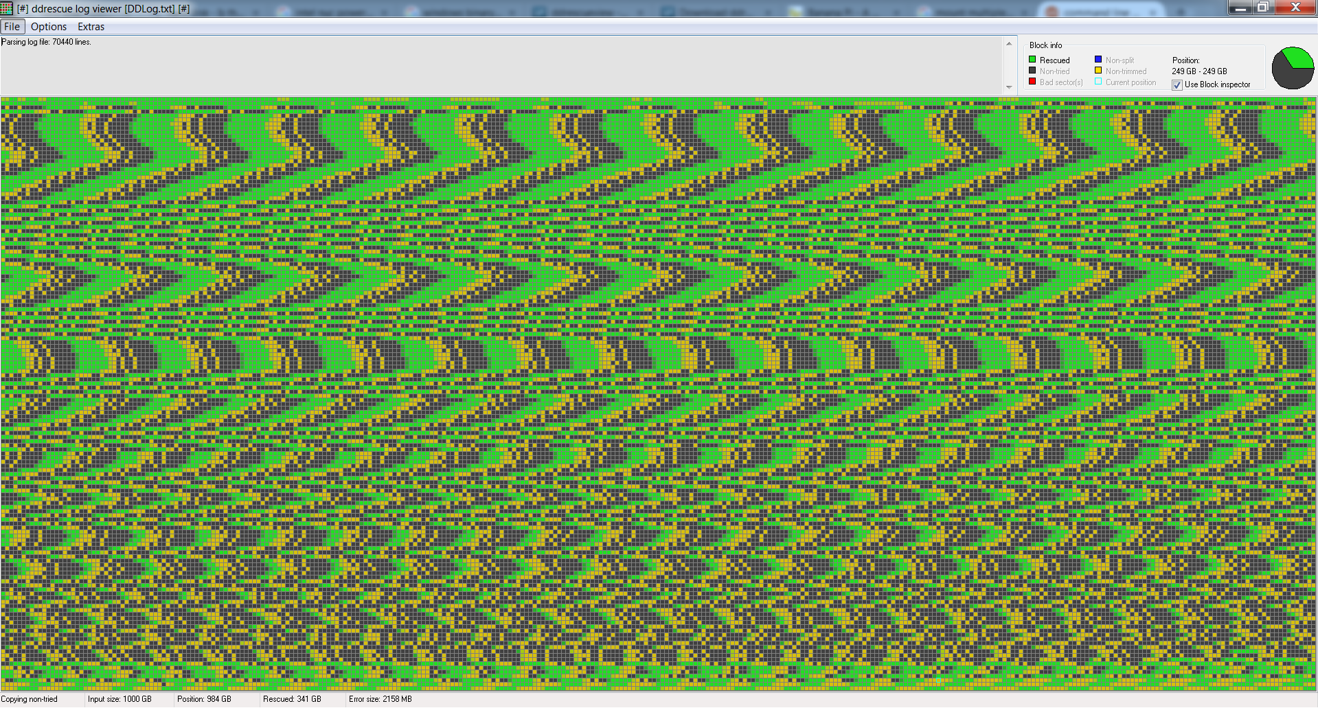

I've attached a picture of the terminal info and a visual representation of the log file processed by ddrescueview.
What concerns me is the pattern; DDRescue has apparently rescued 341780Mb of the drive but these rescued blocks are regularly cut up by presumably failed blocks?
I was wondering if the pattern displayed had meaning to anyone here? For instance is this pattern common when a drive head fails?
Thanks again.

I would ask "maximus" (aka Scott Dwyer) whether he thinks HDDSuperClone may be able to help in your case. It does appear that there is a bad head, though.
FWIW, here is an encouraging report from a user of HDDSuperClone (1 head out of 4 was dead):
http://www.sdcomputingservice.com/hddsuperclone/success-stories
In your case there appear to be two heads, one of which is bad. I'm not sure how many intact files you will be able to recover in such a situation.

I have been contacted about this case and whether or not HDDSuperClone could help. My first impression is that it could help read the data from the good head faster than ddrescue (due to its ability to perform passthrough commands that don't do as much or any extra read retries by the OS), but would not likely produce more recovered data. The image shows that for the very first part of the drive, both heads were reading with one having some problem spots. But then a very consistent repetitive pattern starts, and from what I know about ddrescue I would say that one head is not returning any data at all. Without the actual log file it is difficult to know for sure. So assuming my analysis is correct (from only the picture to work from), either there is a major physical or firmware issue shortly after the beginning of the drive causing one head to not read, or the weak/damage head completely died during the recovery attempt.

From the log I can confirm that it looks like the drive suddenly totally quit reading from one head very early in the recovery. If the drive can still now read that data from the bad head at the beginning then it would be a curious thing (possible firmware issue). But either way, it would almost certainly require professional hardware tools and a possible head swap to get any more data from the bad head, if it were even possible at this point. Continuing the recovery yourself will at most yield maybe just over 50%.
