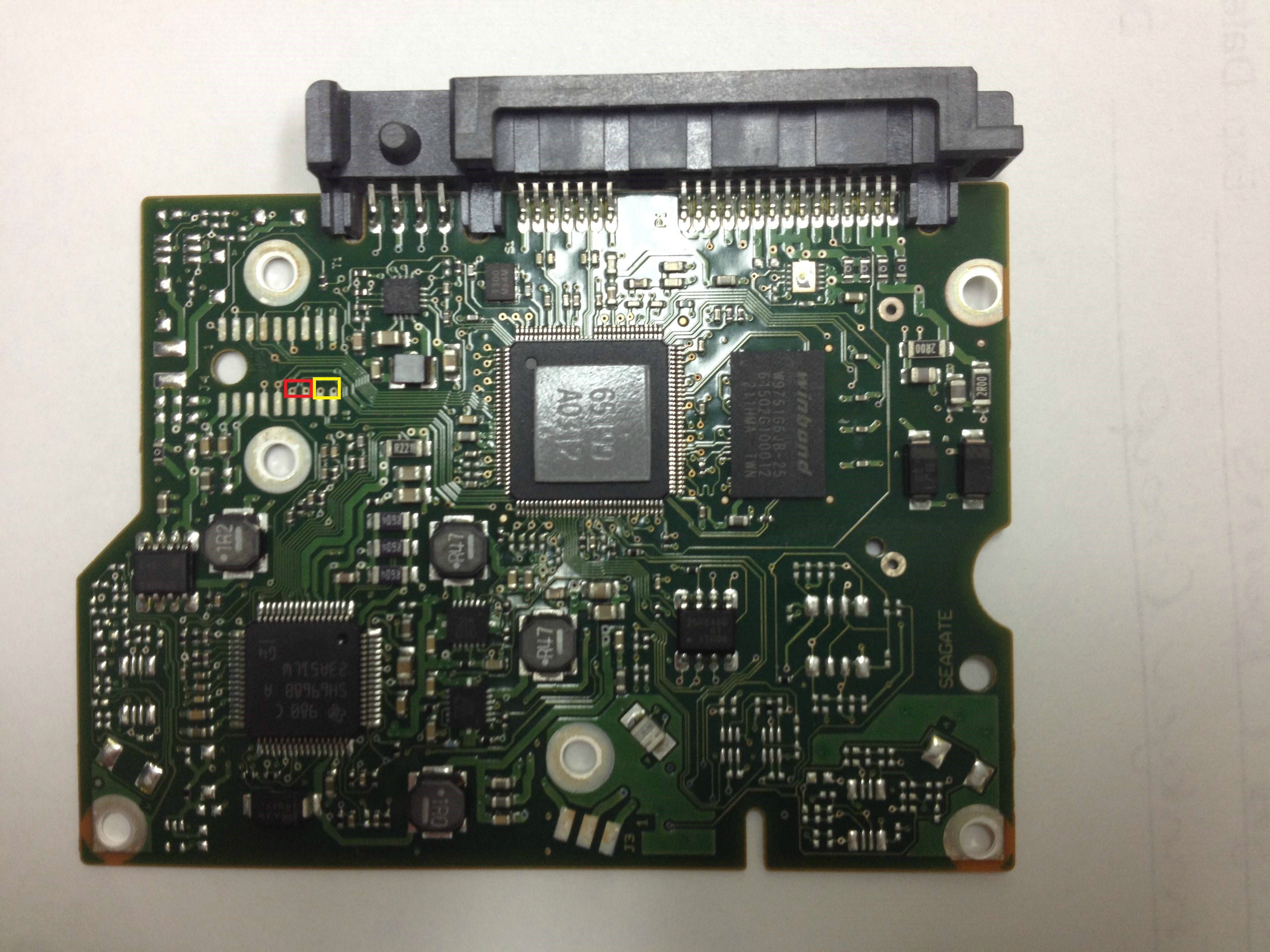

There is other way if you have special tools and software. If not - only shorting read channel.

What other tools and software do I need?
When should I short the read channel?

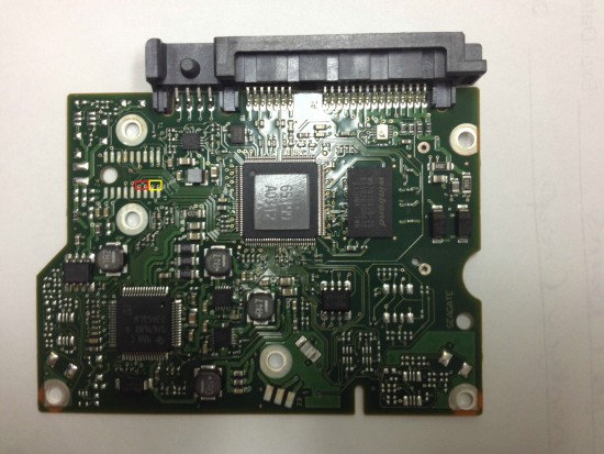

can you need shorting points
Please see the picture under link. try red pins first, and if they not work, try yellow pair

I have searched but there is so much conflicting information.
For example this post by gps31 says "Short immediately after Second SPIN UP message and before (P) SATA Reset"
But this post by saltwater says "You have to short HSA read channel pins after (P) SATA Reset and hold 5-10 secs."
Which is it?

OK, I finally got to the terminal by shorting the red pair after second "Spin Up" and holding until "No HOST FIS"
^L output:
