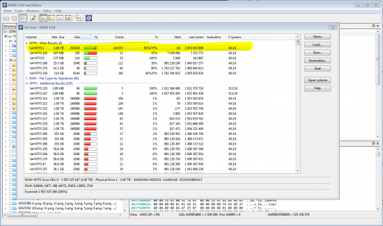

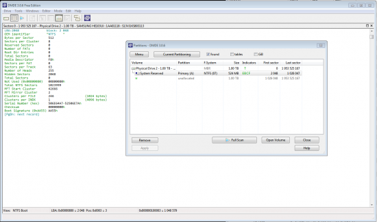

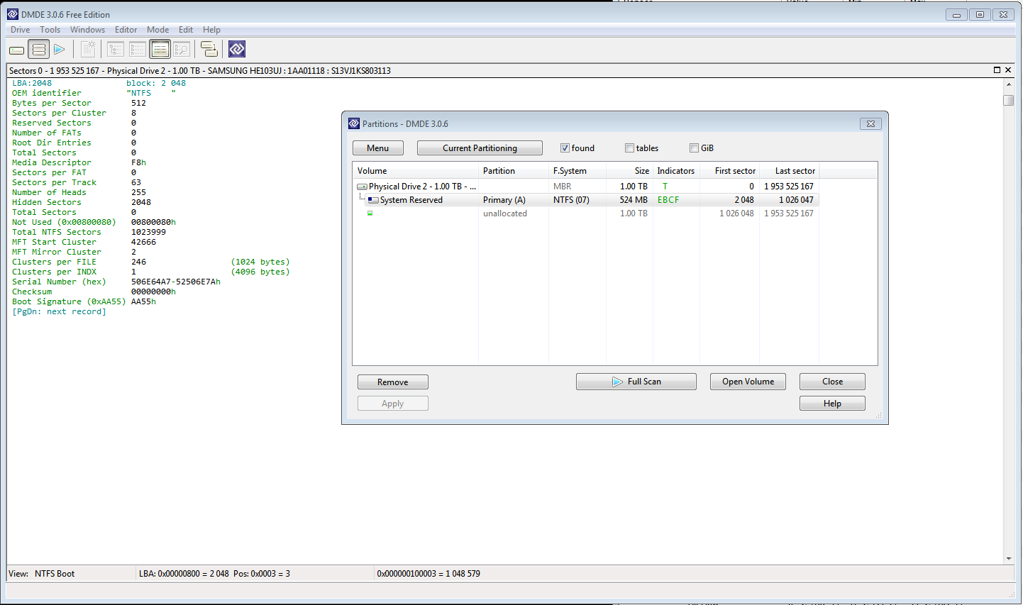

Partition window?
You mean these?

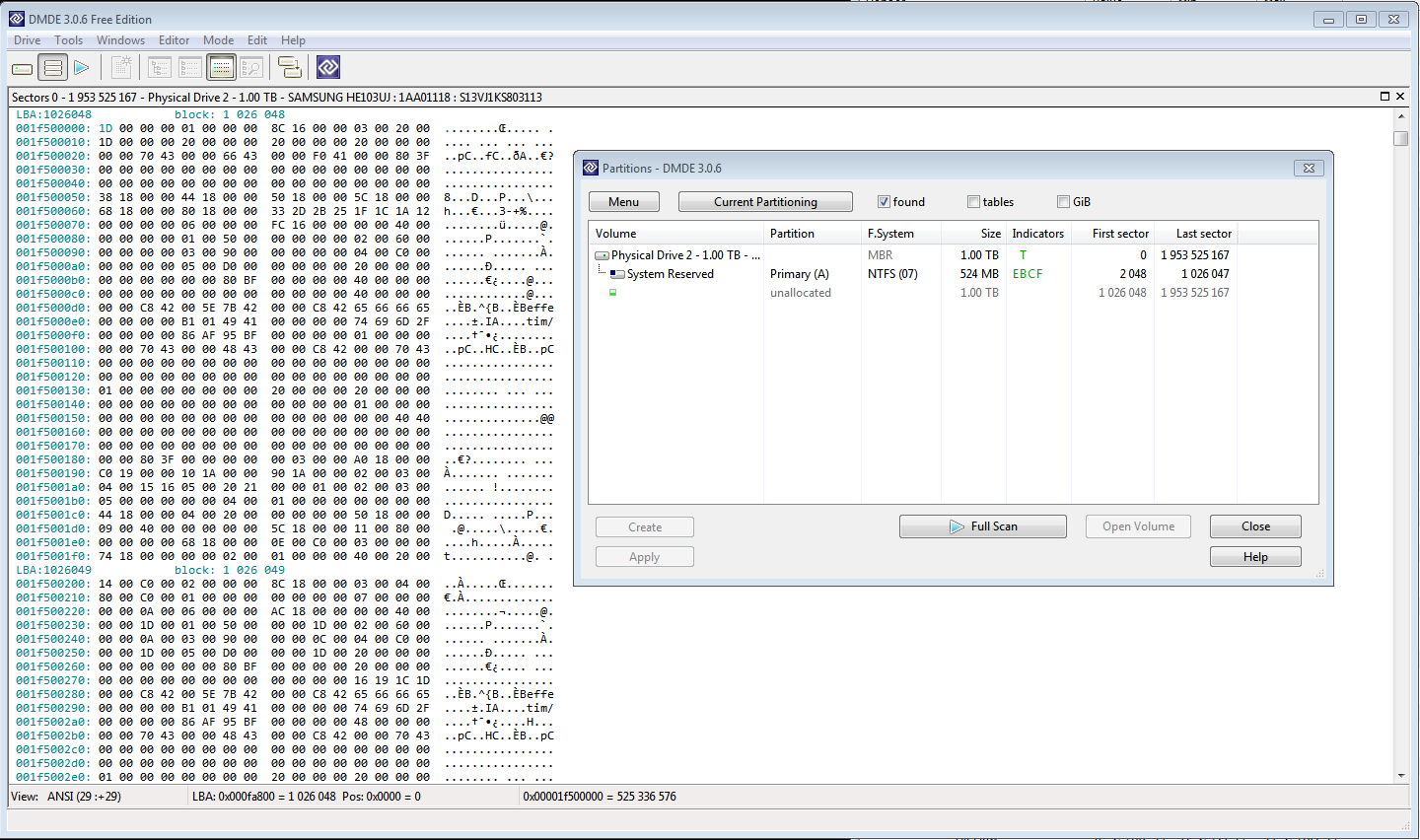

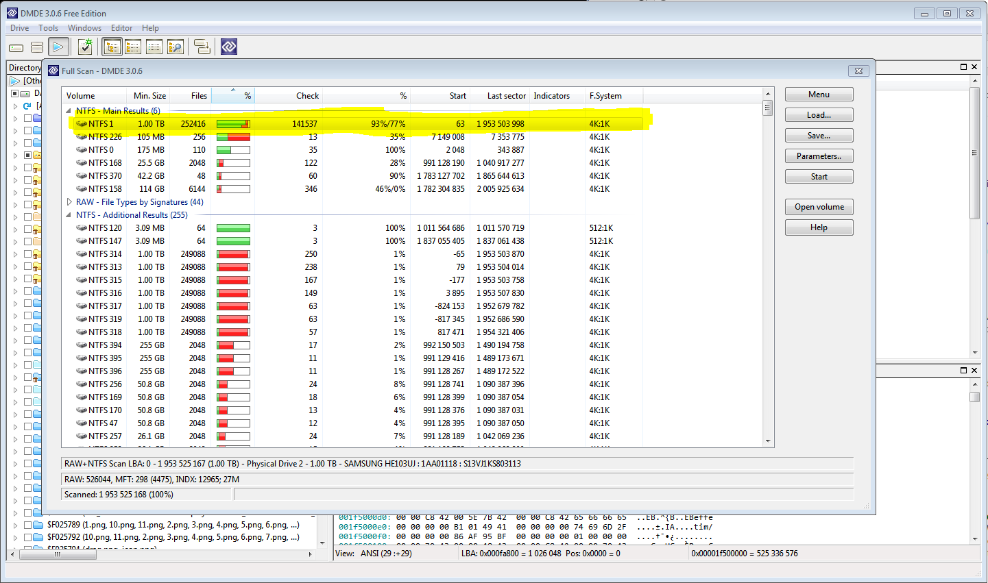

Hello friend,
So i decided to go ahead and scan the drive with DMDE. I found exactly what i lost. Yay!
What should be my next step? Do i recover all the files or do i reconstruct the file system? I'm guessing i have to source a full edition instead of using this free edition?
