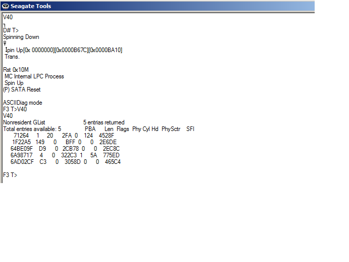

 Post subject: HOW TO SOLVE
PostPosted: August 27th, 2016, 2:28
Posts: 242
HOW TO CLEAR NG LIST NEED DATA

disassemble the structure, find the location and write a blank Non Resident List.
or ask someone a sample of the empty object
everything is very simple

Use the following procedure to read sys file 35:
http://forum.ru-board.com/topic.cgi?for ... start=1180

galaxy wrote:
thanks i try and give result after some times
Clearing NG list is quite dangerouse, don't do that. Problem , most probable, elsewhere
This list should never be cleared.

Posts: 242
problem solved thanks for support
