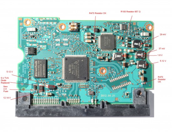

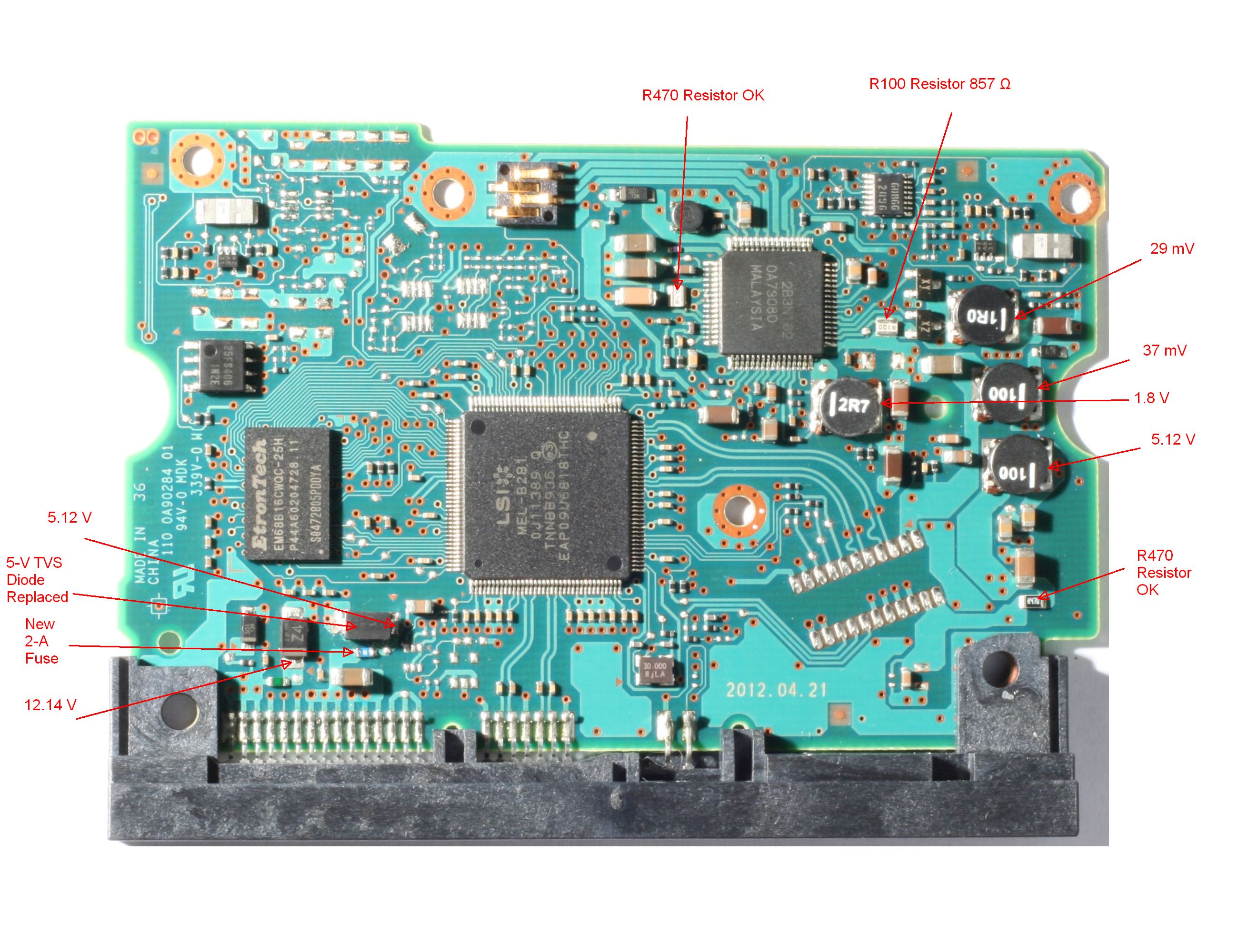

I have a 2TB Hitachi 3K7000 drive that I damaged by connecting it through an adapter to an external Molex power connector on my computer. Despite the Molex connector being keyed, the pins were able to touch when I accidentally tried to plug the connector in backwards. The result is 12V was applied to the drive's 5V rail, and the drive would no longer spin up to be recognized by the computer.
There's no data on the drive that I need to recover. I just want to see if I can get the drive working again for fun and to learn a bit about hard drives.
The PCB shows no visible damage. I discovered the 5V TVS diode was permanently shorted and the 5V fuse was blown. I replaced both of them, but the drive still doesn't spin up or get recognized.
I've attached a picture of my PCB with some voltages and resistances I measured.
I tried placing a short across the 0.1Ω (R100) resistor that measures 857Ω, but it didn't seem to make any difference.
Any ideas on what might be wrong or what else I can try?
I can make more measurements at your request. I also have an old 20MHz analog oscilloscope at my disposal.
Thanks!

Could you trace the circuit around XY, XZ, R100, 1R0? That's the Vcore regulator.

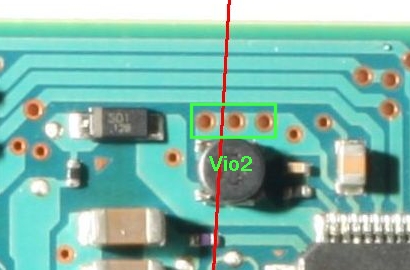

There is an additional Vio regulator (Vio2 in attachment).

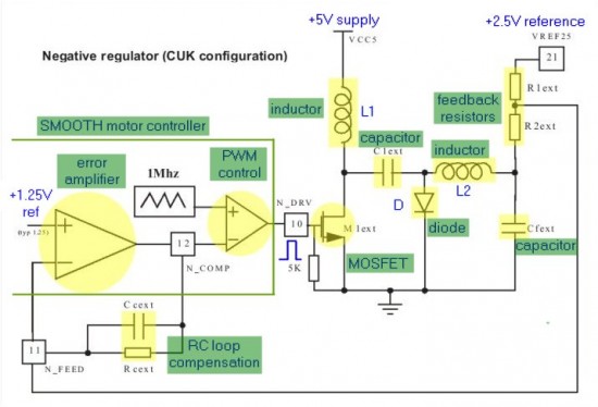

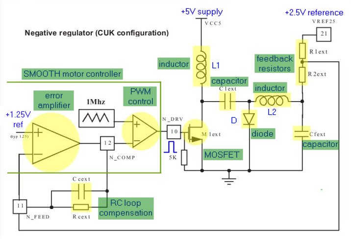

The two "100" coils form a Cuk regulator. This provides the negative supply for the preamp. This supply needs to be switched on by the MCU (which needs the Vcore supply).

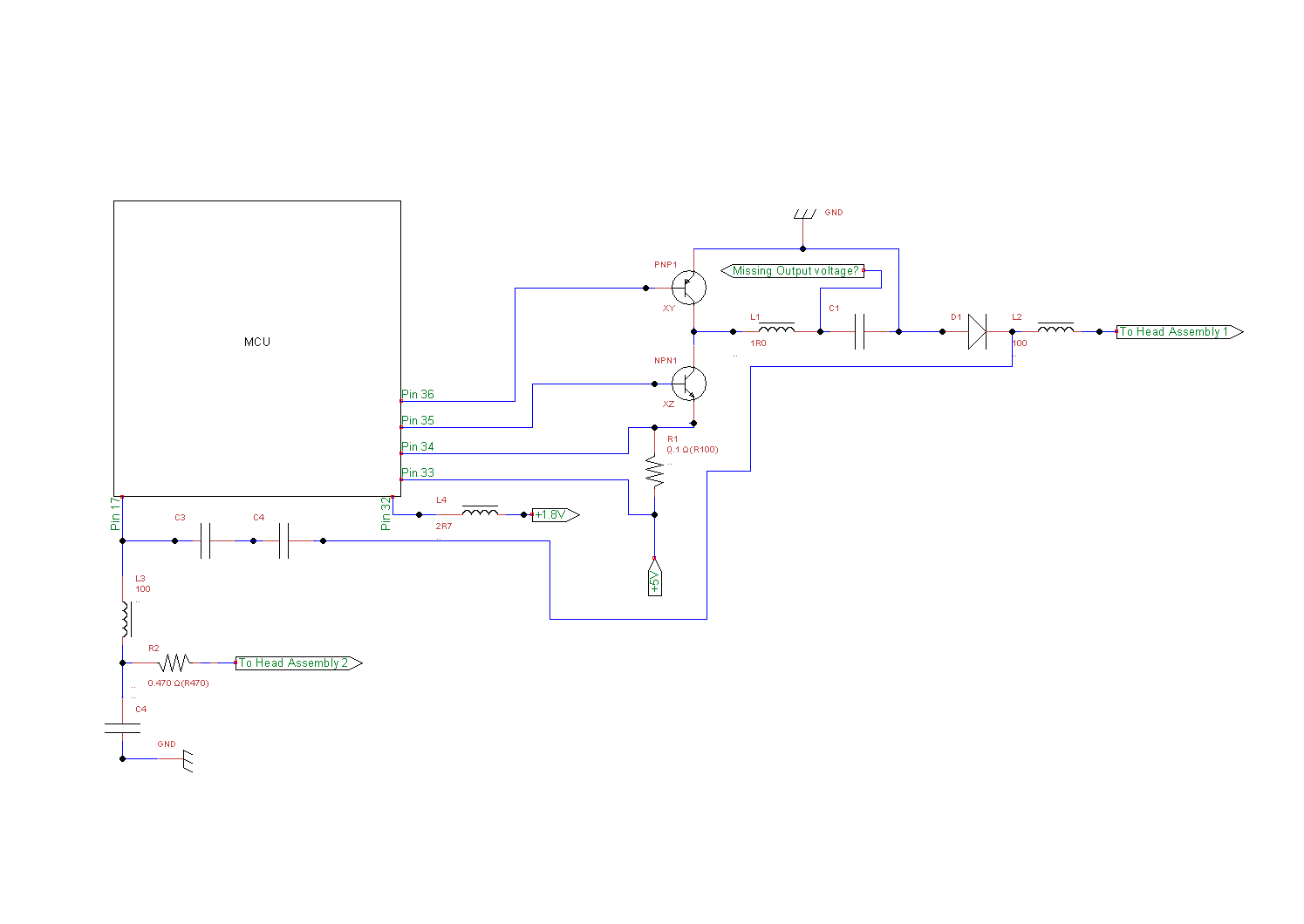

Here is how I see the circuit (the broken output is caused by the broken forum software).
Edit: I worked around the bug by deleting leading spaces.
                 +5V
                  | 2SB1714
.--------.    XY  |
| hi-drv |------|
|        |      |\    inductor
| motor  |        |   ___
|control |        +---UUU---+-------+---o Vcore
|        |      |/   1R0   ---     .-.
| lo-drv |------|          ---     | | Rfb1
|        |   XZ |>          | C    | |
'--------'        |2SD2679  |      '-'
    |             |         |       |_____.
    |            | | R100   |      .-.    |
    |             |         |       |Rfb2 |
    |                      GND            |

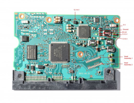

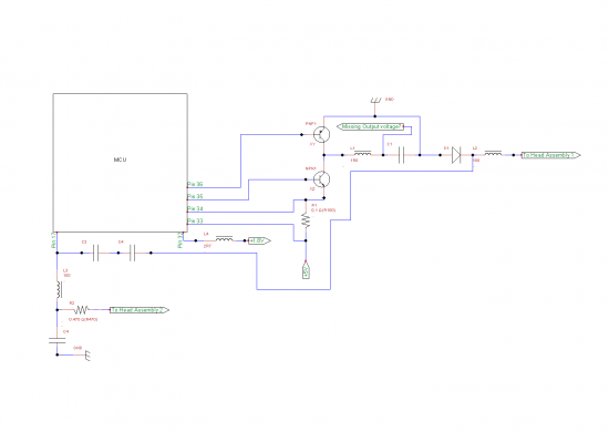

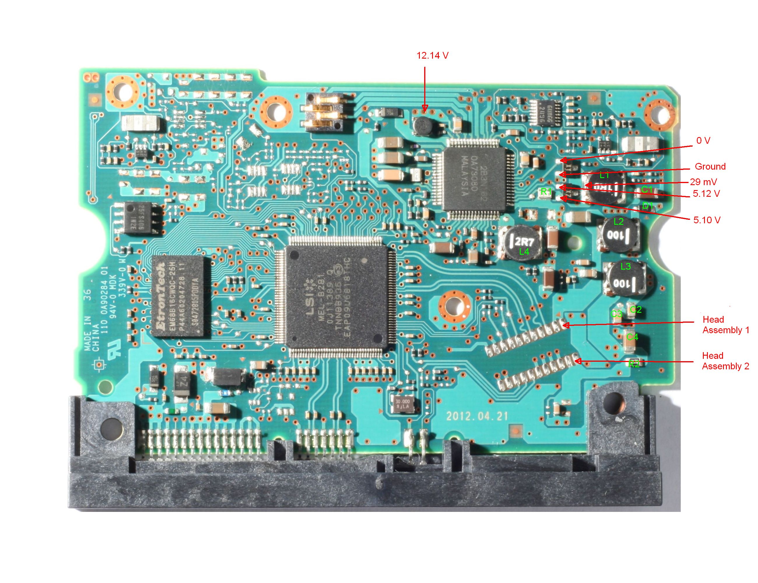

I've attached a schematic I came up with. The transistor arrangement looks wrong to me, but that's the way it appears to be according to their pinouts in the datasheets you linked to. I also attached a picture of the PCB with components labeled as they are in the schematic.
I measured the voltage at Vio2 and got 12.14 V. That point appears to be connected through vias directly to the 12-V rail on the back of the board.
What is the resistance between the 1R0 coil and ground? If it is close to 0, then the MCU would be suspect.
I measured 43 Ω.

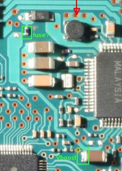

It appears that I got quite a few things wrong. :-(

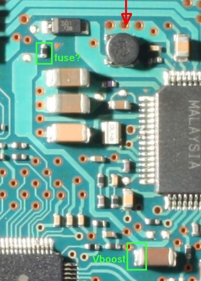

The regulator which I have incorrectly identified as Vio2 appears to be a boost converter (I should have known this from the polarity of the adjacent diode -- slaps forehead). I suspect that it produces approximately 18V for the VCM circuit (see the L7250 SMOOTH datasheet for an explanation).
L4 is the inductor for the Vio supply. It outputs 1.8V for the SDRAM and serial SPI flash memory.
L1 is the inductor for the Vcore supply. I would expect a Vcore voltage of around 1V.
L2 and L3 constitute the Cuk converter. There is an example in the L7250 SMOOTH datasheet:
http://pdf.datasheetcatalog.com/datashe ... Xyuswx.pdf
If this converter is enabled, it should produce -5V.
Your circuit is inconsistent with the two BJTs. Therefore it appears that I have incorrectly identified the XZ and XY markings. Can you perform diode tests on the BCE/GDS junctions?

Also, I checked the possible fuse you identified and got continuity across it.

XY is testing like a PNP transistor with E & C reversed. The low resistance between E & C is due to the external circuit. That is, the Vcore output powers the MCU which presents a resistance of 43 ohms. This resistance appears low, but is actually in the normal range.
XZ doesn't test like a BJT.
IME these Vcore supplies, such as those on computer motherboards, typically use MOSFETs (with body diodes), so perhaps I have some fundamental misunderstanding in this area. Clearly neither of our circuits are correct, and none of our transistor choices are suitable for high frequency (1MHz) operation. However, it is clear that there is a problem in this area of the circuit. Perhaps you could probe the base (or gate) drive to XY and XZ. When everything is working correctly, you should see PWM pulses.
