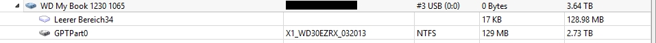

Joined: August 28th, 2016, 13:11
Location: Germany
I haven't cloned the wrong drive.
Currently I am running a scan of r-studio (with default options) on the cloned disk. The NTFS partition showed up.
Before I ran testdisk and used it to recover (copy) some random files which completed successfully.
Let's see what r-studio can do once the scan is completed.
