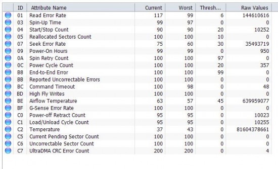

It has been happening for about a year or more, so please don't say that this hdd is dying or smth. like that. After I start my computer it is working for a while, then suddenly stops. When I want to start it immediately after stopping, it makes 2 scratching sounds like this https://www.youtube.com/watch?v=kt6asKkMJq0 and won't start. Then I wait for about 15 mins and only then it starts and works well again. What does this sound mean, something wrong with arm?

Can you show us the SMART data?
You could use CrystalDiskInfo:
http://crystalmark.info/software/CrystalDiskInfo/index-e.html

It is Seagate Pipeline 1 TB. Here is smart

Power supply?

Seagates are very strict about power quality. even if look like power supply is working, but it could provide bad power quality. Seagates are very picky. May be it's not your case, but it's first thing which you need to check.

It stops during work, and then computer tries to restart but hangs at Motherboard Screen or rarely at post with a message like Disc read error.

This sound happens when one head is weak, and could not read servo.
In terminal you will see a "FAIL Servo" message.
Backup your data NOW!
