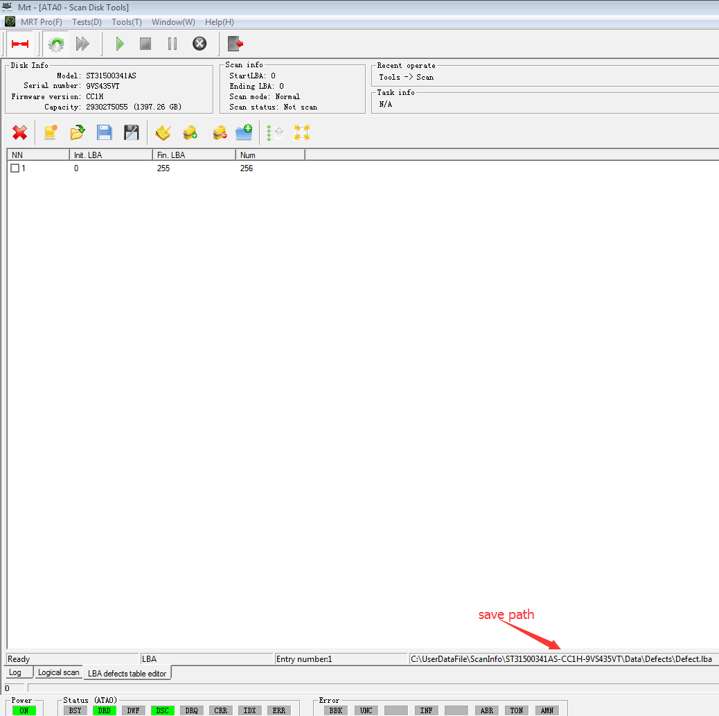

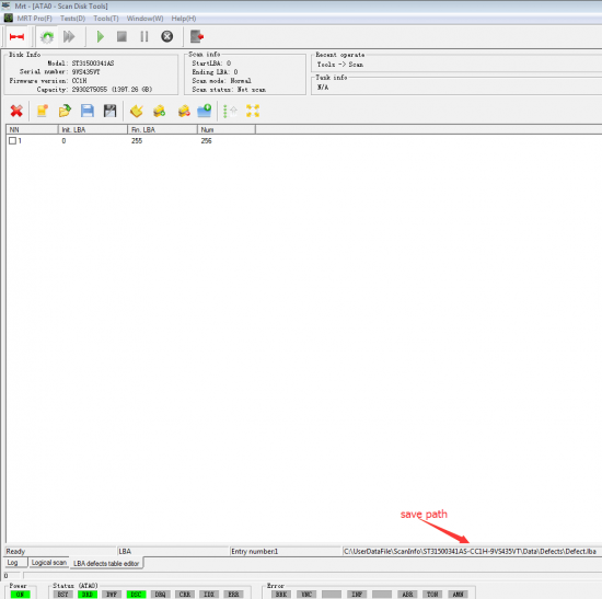

Step 1: Scan the HDD and click “Whether to save the bad block into the defect table file ”. Please note that if there are a lot of bad blocks in the HDD, an option “Skip bad block ” can be clicked to increase the scanning speed. And users can set reasonable skip size, and then click “Add skipped sectors to defects”. When users set these parameters, they can start scanning the whole HDD and save bad block into defect table files. (reference pics are showed as enclosed pic1&2)

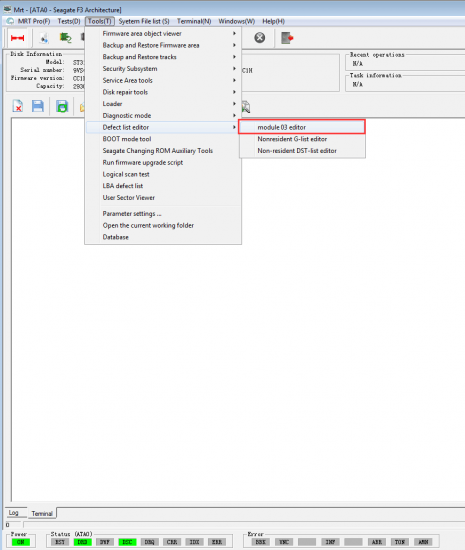

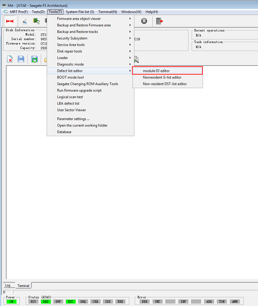

First , open Module 03 of the HDD and select the HDD model between Seagate Generation 11 and higher than Generation 12. If users selected the wrong model, module 03 cannot be read. If users are not clear about the model, they can try one by one to see which one is the right model. Now users can add the scanned defect files into P-list. (reference pics are showed as enclosed pic3&4)

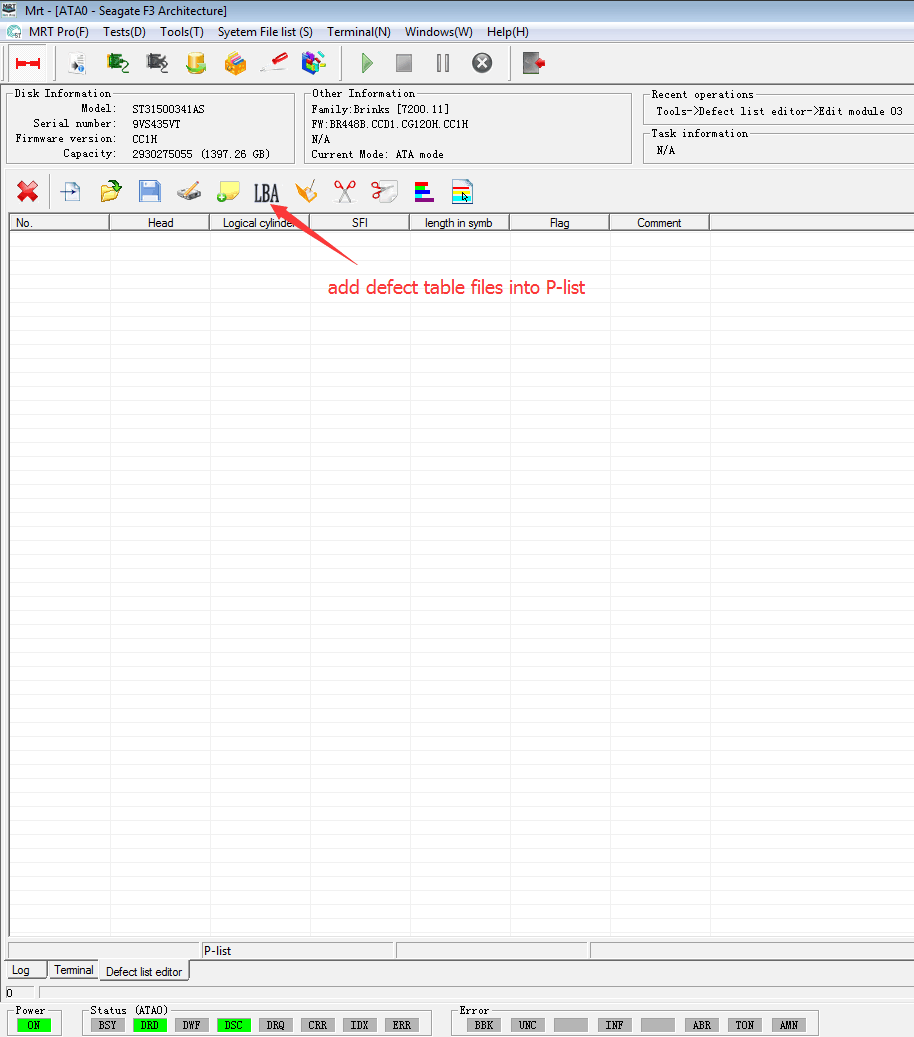

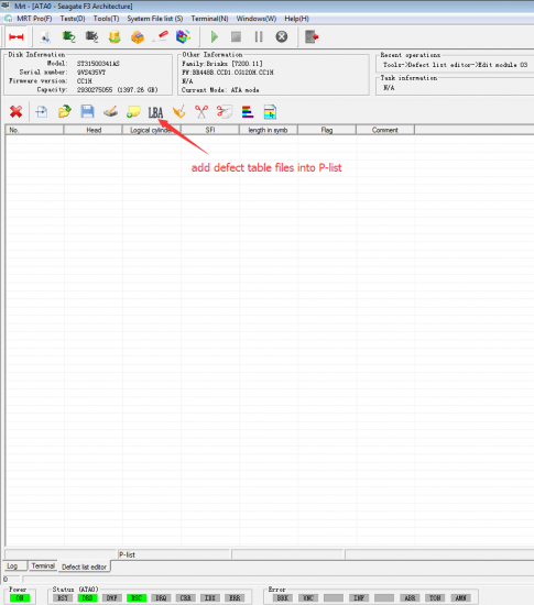

In P-list editor, users can add bad blocks into P-list if they click “LBA” on the tool bar. MRT software will change the LBA address format of bad blocks files to P-list address format.
