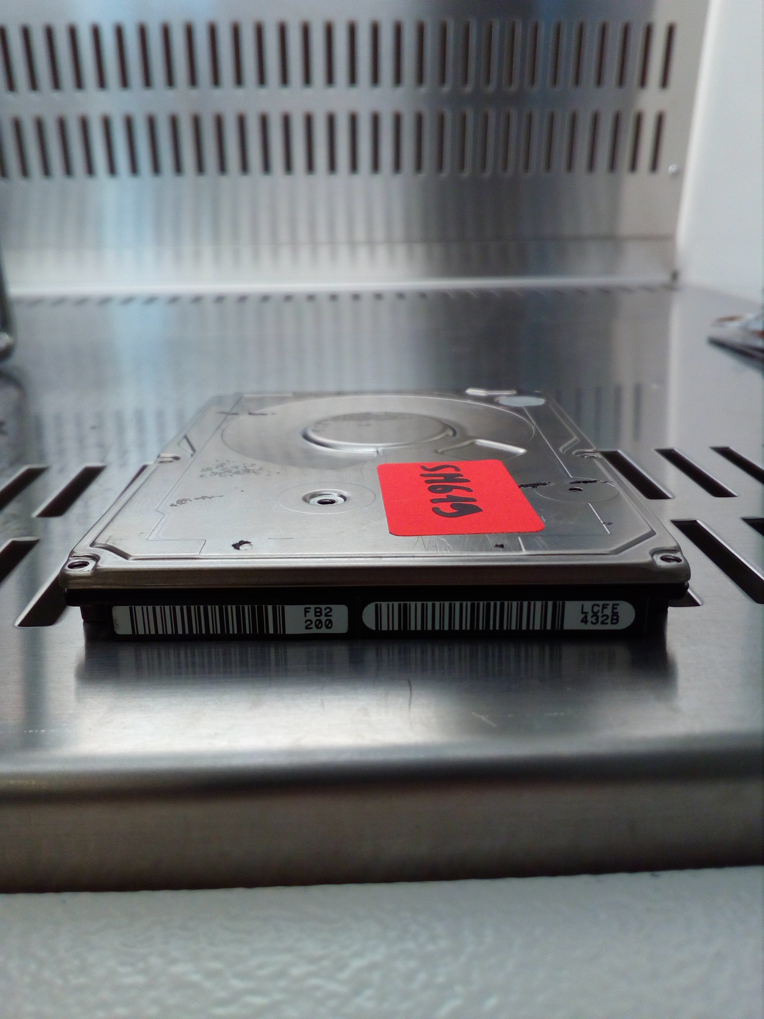

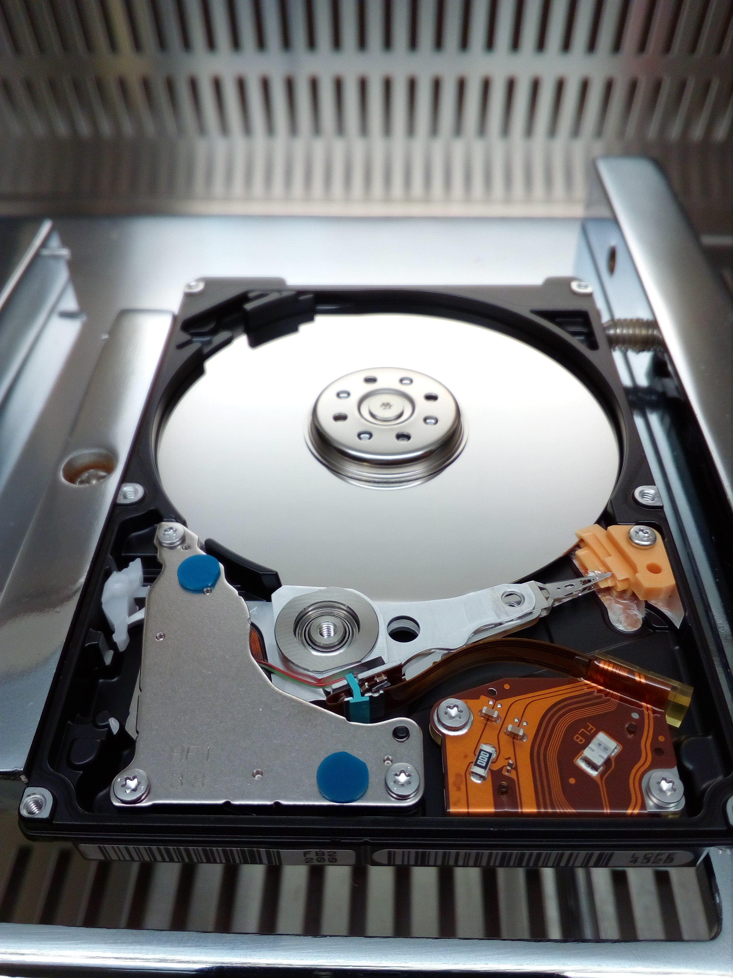

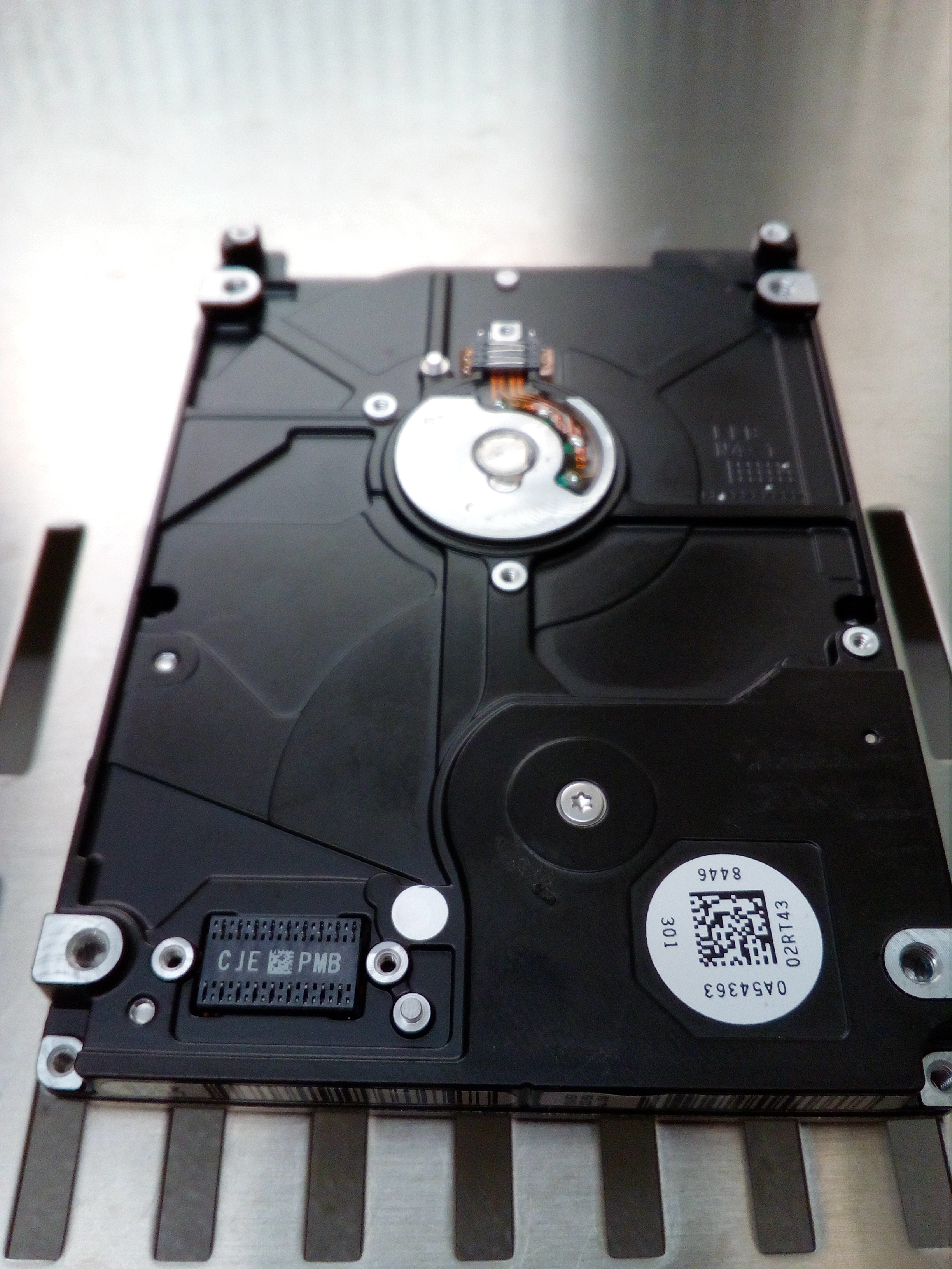

I have here a Hitachi 2,5" HDD. It came to me without any label and without original PCB.
I put here 3 pics... Can you help me to discover what model can it be?
I think something like HTS543216 .........
Many thanks
Simone

 Post subject: Re: Hitachi without label and PCB... what model?
PostPosted: September 12th, 2016, 13:33
Posts: 402
Location: Moscow
HTS543216L9A300
HTS543216L9SA00
PCB
220 0A90002 01
then search SA
