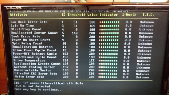

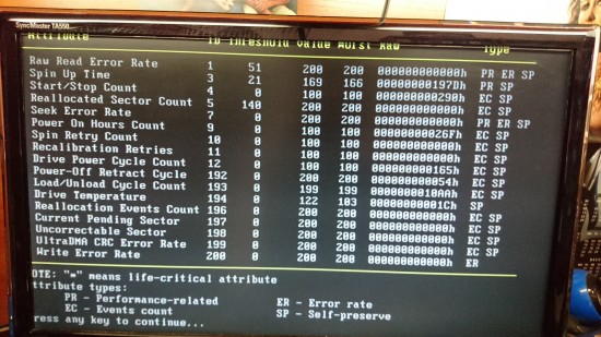

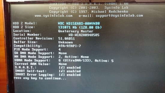

I`ve attached screenshots from SMART test utility.
I`ll try with that firmware software that you pointed.

is disk connected to Gigabyte motherboard

Hello lolszowy, your drive is detected as 128GB when it shloud be detected as 1.5TB size. Seems to have some firmware issue. Have you connected it into other motherboard?
Best,
F

Maybe this?
GigaByte BIOS bug reduces 2TB capacity to 128GiB:
http://www.hddoracle.com/viewtopic.php?f=59&t=150&p=2958
