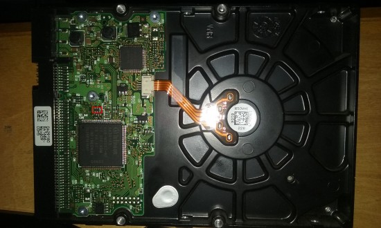

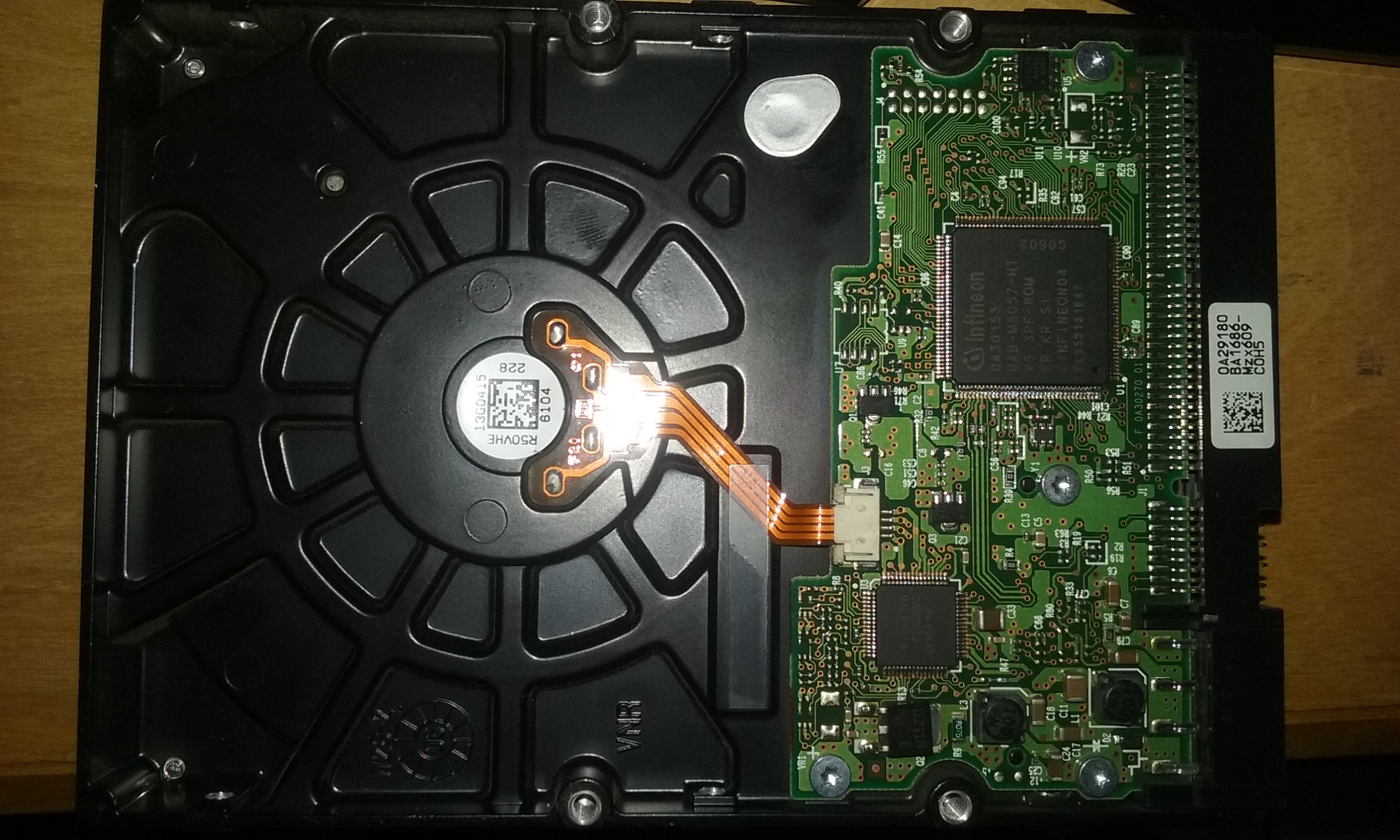

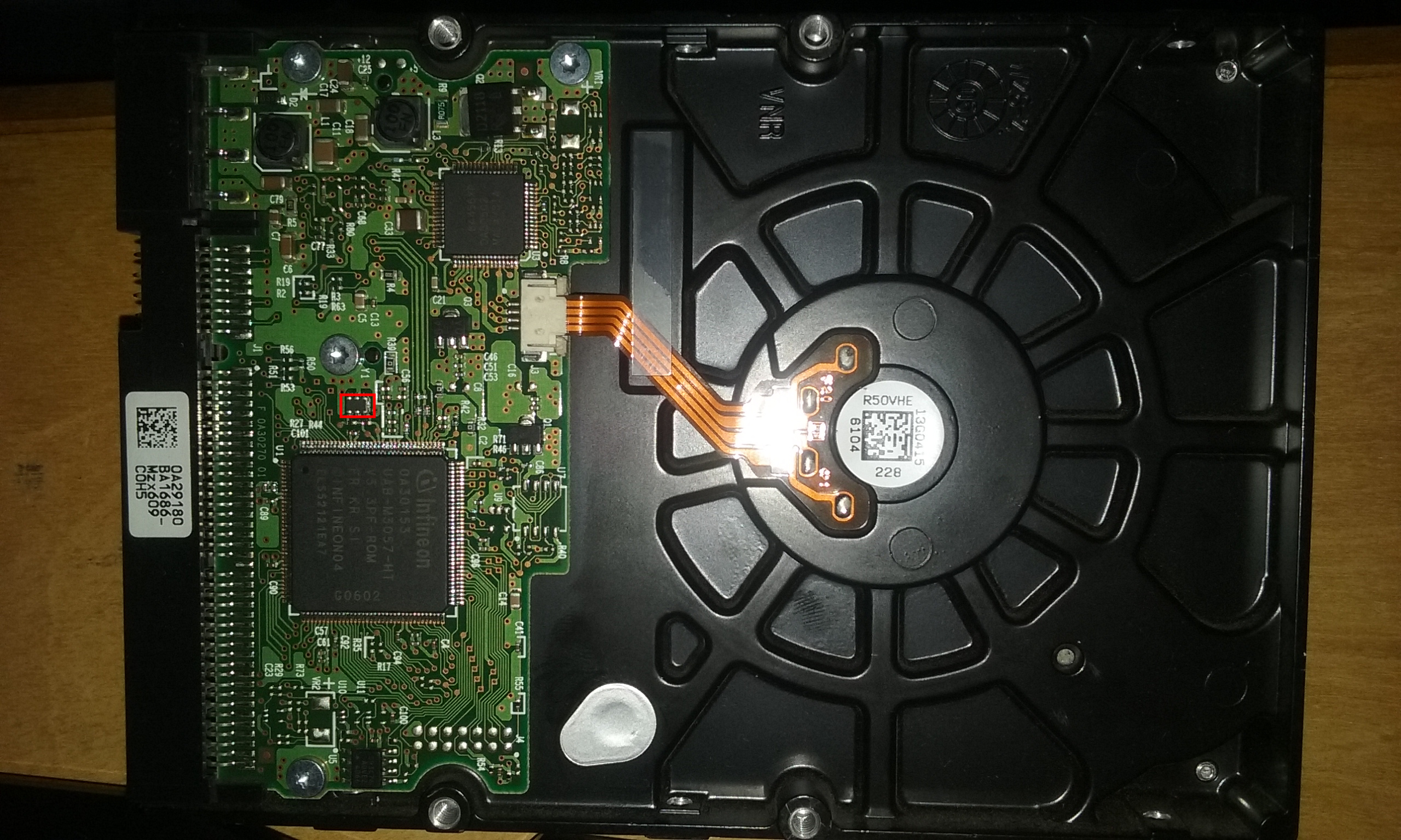

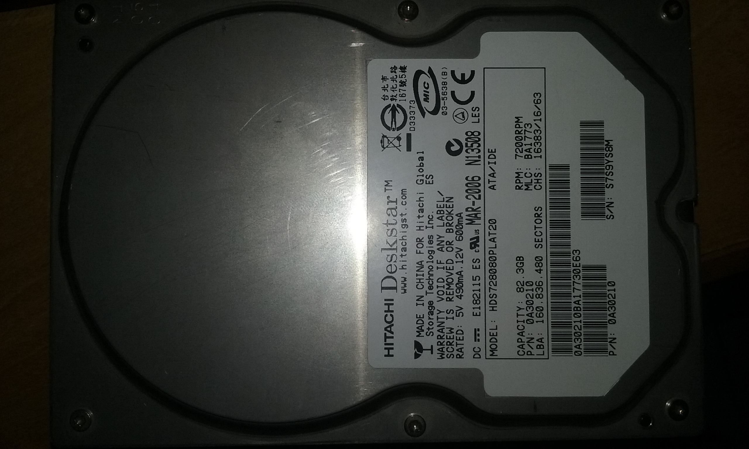

It's a Hitachi Deskstar HDS728080PLAT20.
The computer powers up allright, the problem is that it doesn't know the HDD is plugged. It boots normally with other PATA HDDs.
As far as I can tell, the PCB looks the same, I didn't hear any burning/cracking sounds when it happened. I can only assume it got damaged.
Here's a pic from each side.
Thanks a lot.

Hi, check the D2 for a short (you know how??) and there must be some components on the back of the PCB. So release the flat flex for the motor and pull it out, then release the screws and flip the board. Please post some photos of it.
 Post subject: Re: Fried PATA hdd by plugging it with computer running
PostPosted: September 19th, 2016, 16:19
Posts: 17335
I suspect that D2 is probably OK (because the PSU doesn't shut down).
I would measure the voltages on the pins of transistors Q1, Q2 and Q3. These would be the Vcore and Vio voltages.
I would also test resistors R9 (R075, near L3/Q2) and R5 (R47, near the +5V power pin).
Also measure the voltages at coils L1 and L3. These constitute the Cuk converter that supplies -5V (?) to the preamp.

Well, nevermind guize. I found a broken chip (literally, broken) and it's microscopic. Don't know how I (or anyone) broke it, it's the small chip below the middle screw (it's intact in the picture). And I highly doubt that it's replacement is possible, so I'll have to find a pcb donor. fuck.
Anyways, now I'm sure the pcb won't work.
If anyone has any advice for determining possible donors, I'll be much grateful.

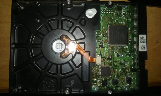

I can't take a quality pic, but this is the broken chip
PostPosted: September 21st, 2016, 19:00
Posts: 17335
That's the crystal. :-(((

So, if I replace the circuit board with this one, will it work? it's exactly the same model, the only thing that doesn't match is the MLC. Is it important to match the MLC in Hitachi drives?
PostPosted: September 22nd, 2016, 8:59
Joined: September 27th, 2010, 16:29
Posts: 182
Location: Buenos Aires, Argentina
Hi! I think it won´t work. PCB contains important information on it. A direct replacement is not suitable in this case (if i remember well, i moslty wor with western digital drives). Do you need to recover data? This is an important question before telling that you can replace broken crystal IC with some soldering skills. But you are taking a risk. It is up to you.
Best!
F

You need to transfer the 8-pin chip at U5 from patient to donor.
