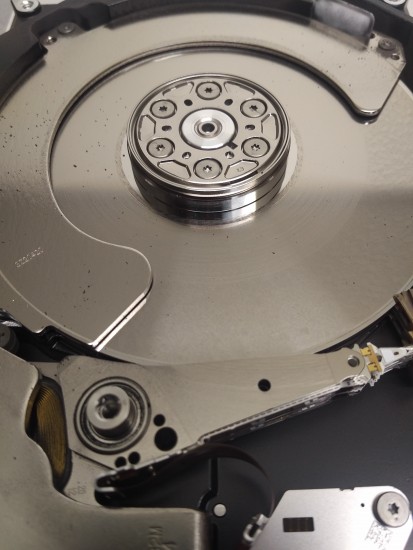

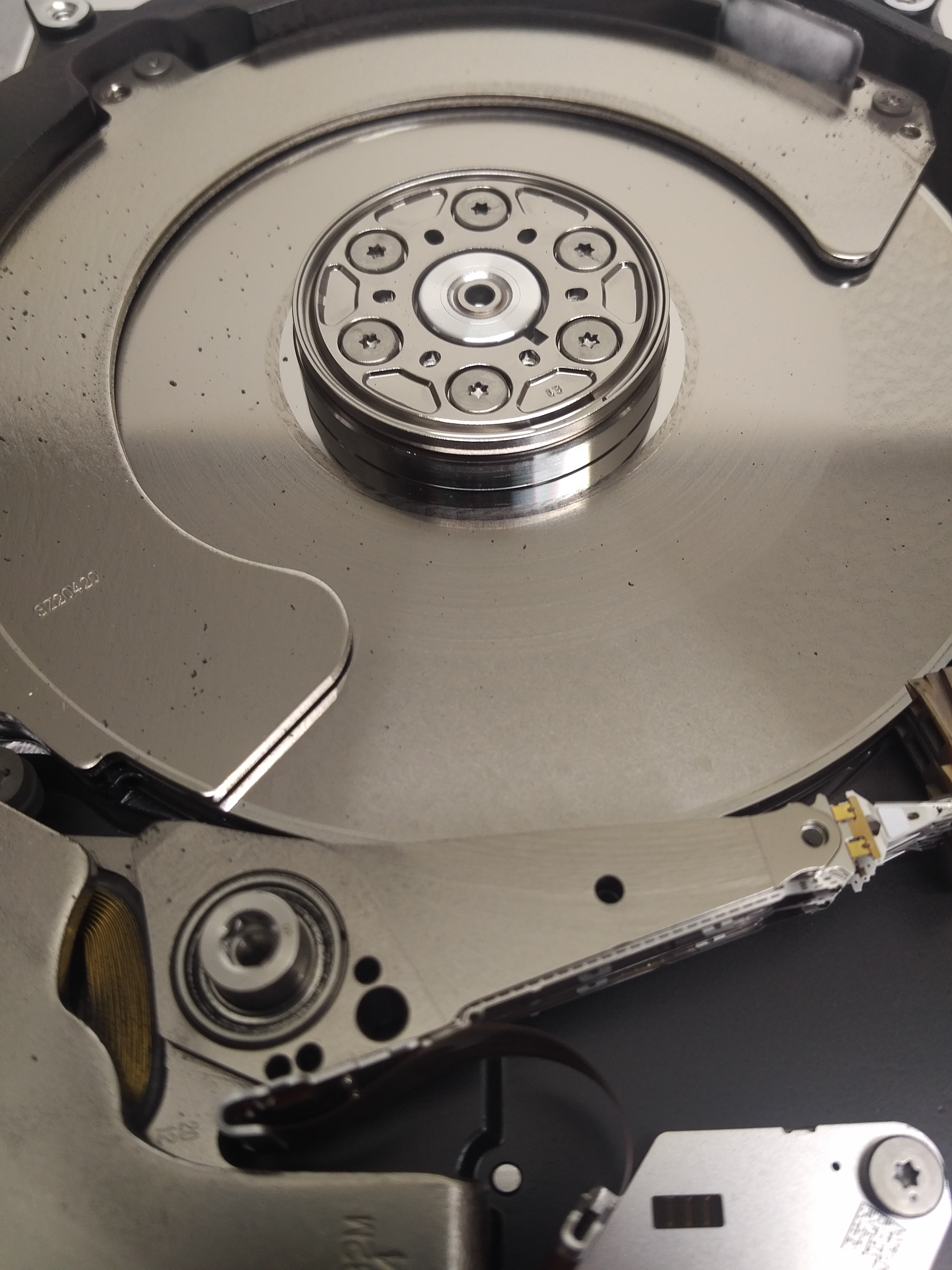

PostPosted: July 19th, 2016, 21:23
Here is the ST2000DM001 that I got to assess today. Not quite what the client and I was looking for.
 Post subject: Re: ST2000DM001 Fun Times
PostPosted: July 20th, 2016, 5:00
Posts: 411
Location: Romania
Ouch! There is way too much data outside the disks!!!
Well done Seagate!
